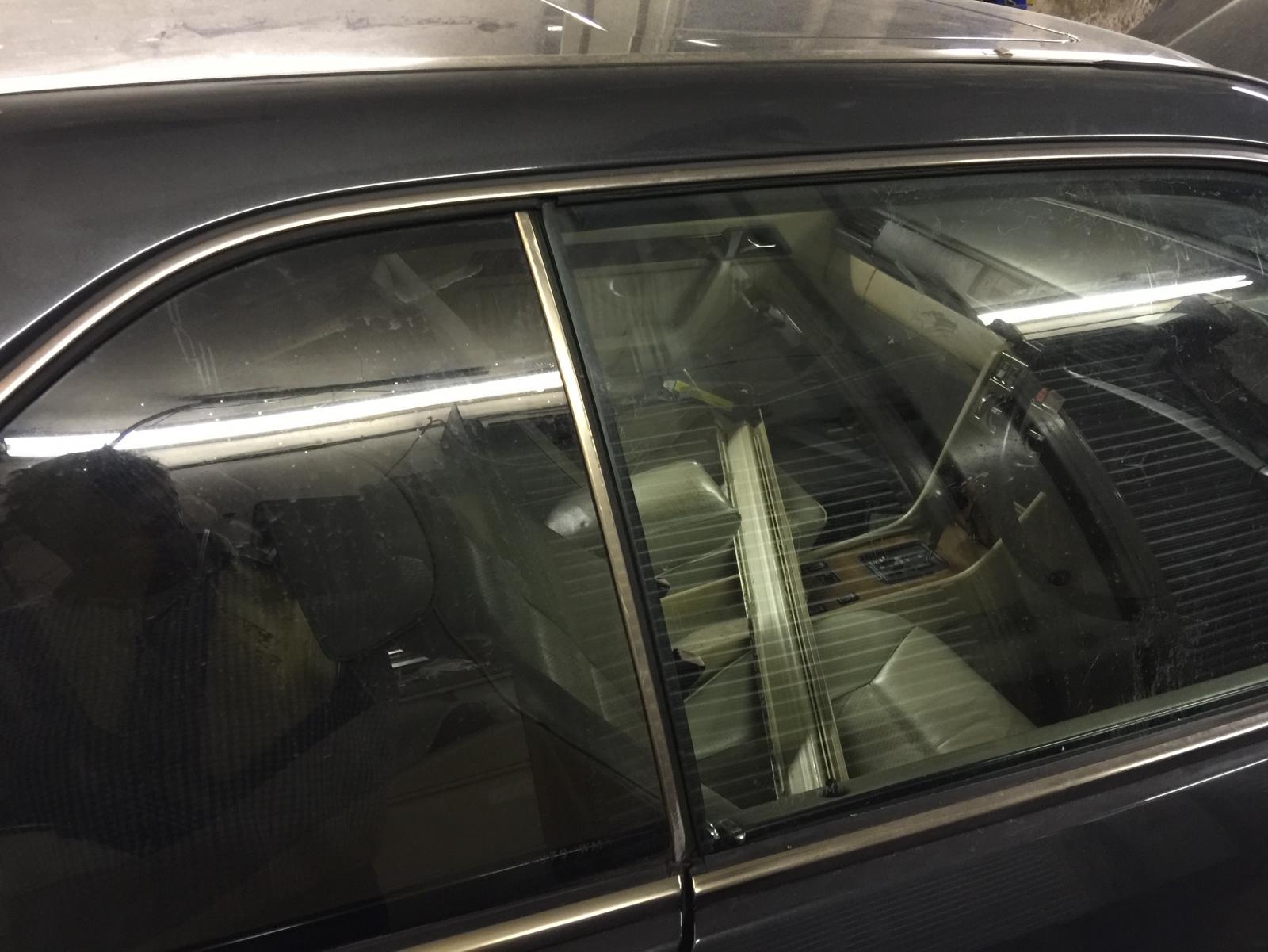

Not much done at the moment, other than make a start on removing the tint film...got the drivers door off in one piece then a wipe with some autosmart tardis and all the glue just came straight off. It looks so much better...I wouldn't mind but the glass has a nice tint as standard anyway so Christ knows why someone thought it'd look better with that crap stuck on?

Eeep, I hadn't realised the front points were like that, sorry - I hadn't got that far! I did poke the subframe mounts at the back - had they been bad I wouldn't have kept it on the back burner. Nice work on the tints, does it reduced the appearance of scratches on the glass any? I'd get secondhand front MB wings and a secondhand bonnet if you can in the right colour.

I've only stripped the drivers door glass so far but it looks a millionty times better...going to de-ox a couple of the crusty bits over Xmas when I'm allowed to escape to the workshop then start accumulating some bits for a mechanical refurb. Think I'm going to go down the pattern wing route but the bonnet isn't too bad. I'm going to paint both sides and the bonnet anyway but I'll coat the inside of the wings with loads of stonechip before fiitting so that should add a bit of substance to them. Are the seat tilting mechanisms somehow connected to the vacuum system then?
