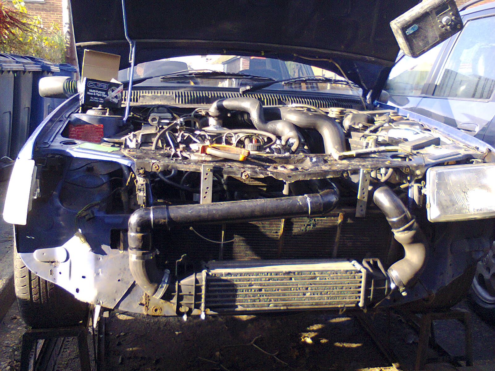

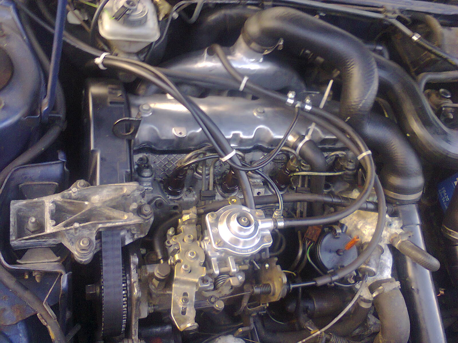

I have a strange desire to strap unsuitable turbos onto XUDs. For no reason other than it is super cheap and most amusing.

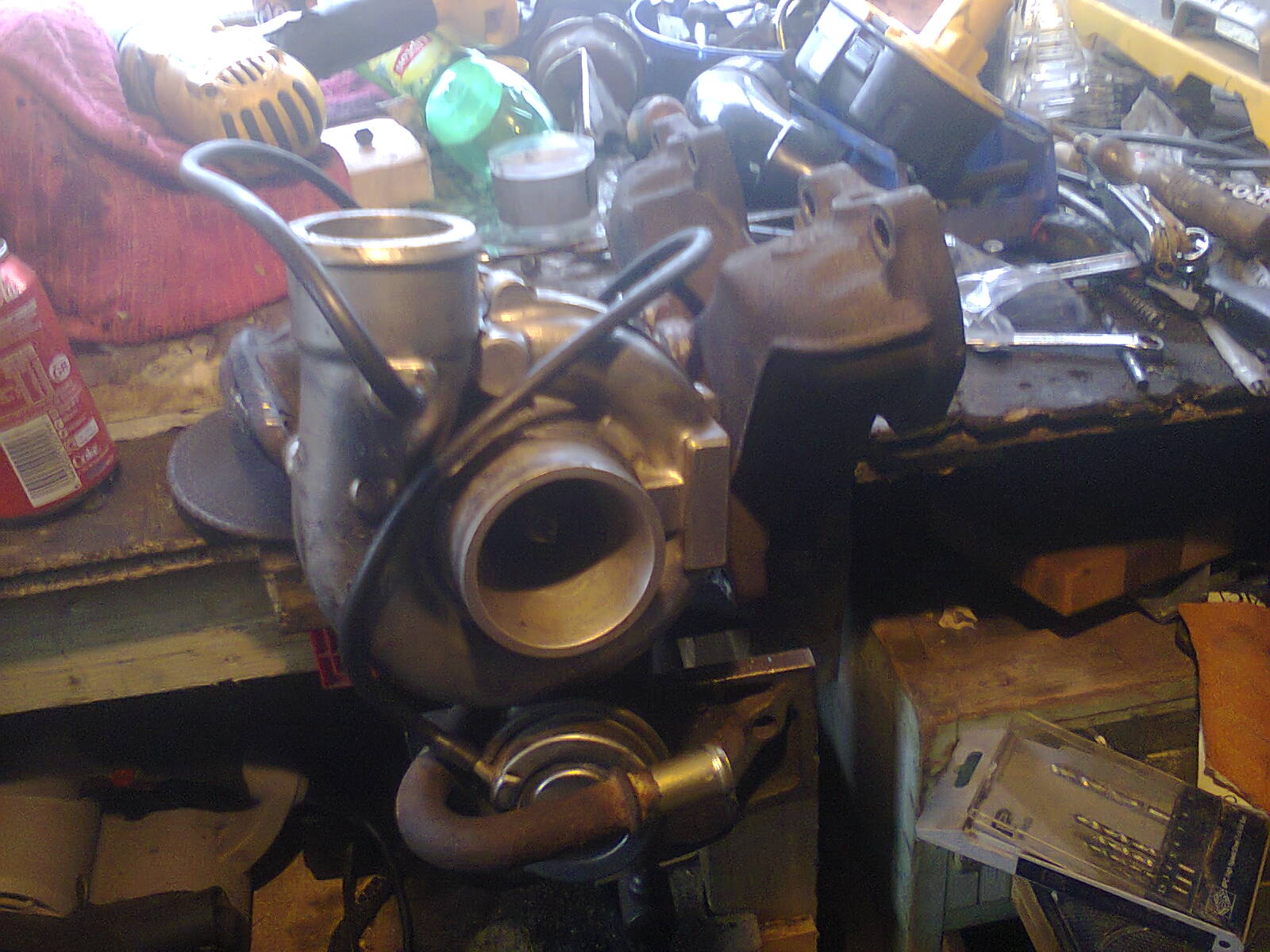

This one was robbed from a Mercedes C220 CDI in the boneyard.
Like I said, done cheap, B&Q intercooler pipes. They hold 24PSI happily.
Yep. I are not normal.
We should talk.
What model was that CDI turbo?
Looks like it mated up to the XUD manifold just perfectly
It was a Gt2052s.
It is welded to the manifold with a stick welder.
Original oil lines fit.Then welded on a bit of plate with a hole to attach the original exhaust elbow on.
