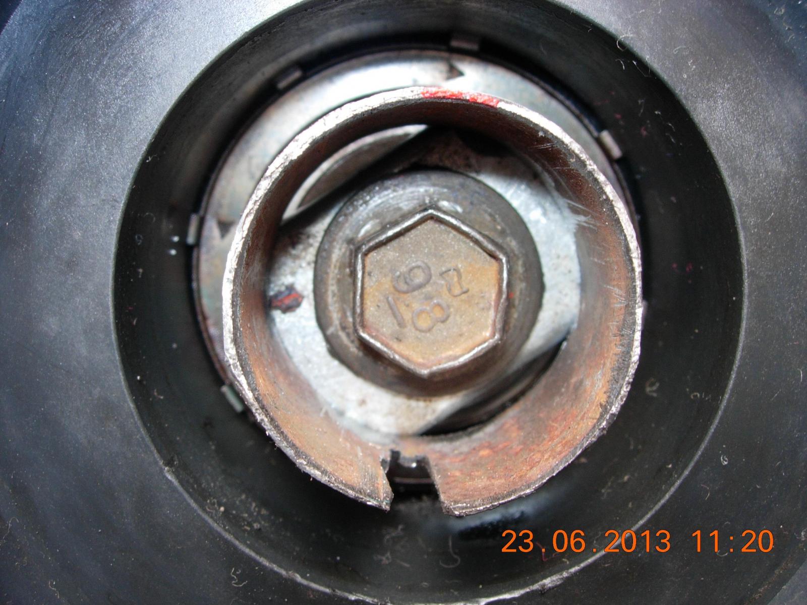

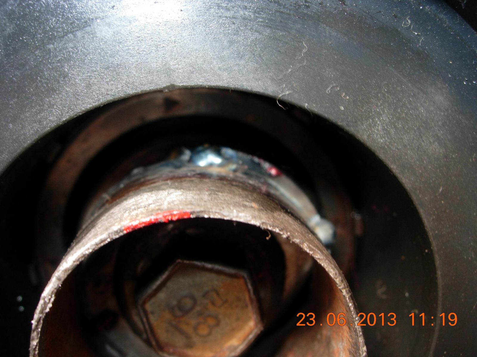

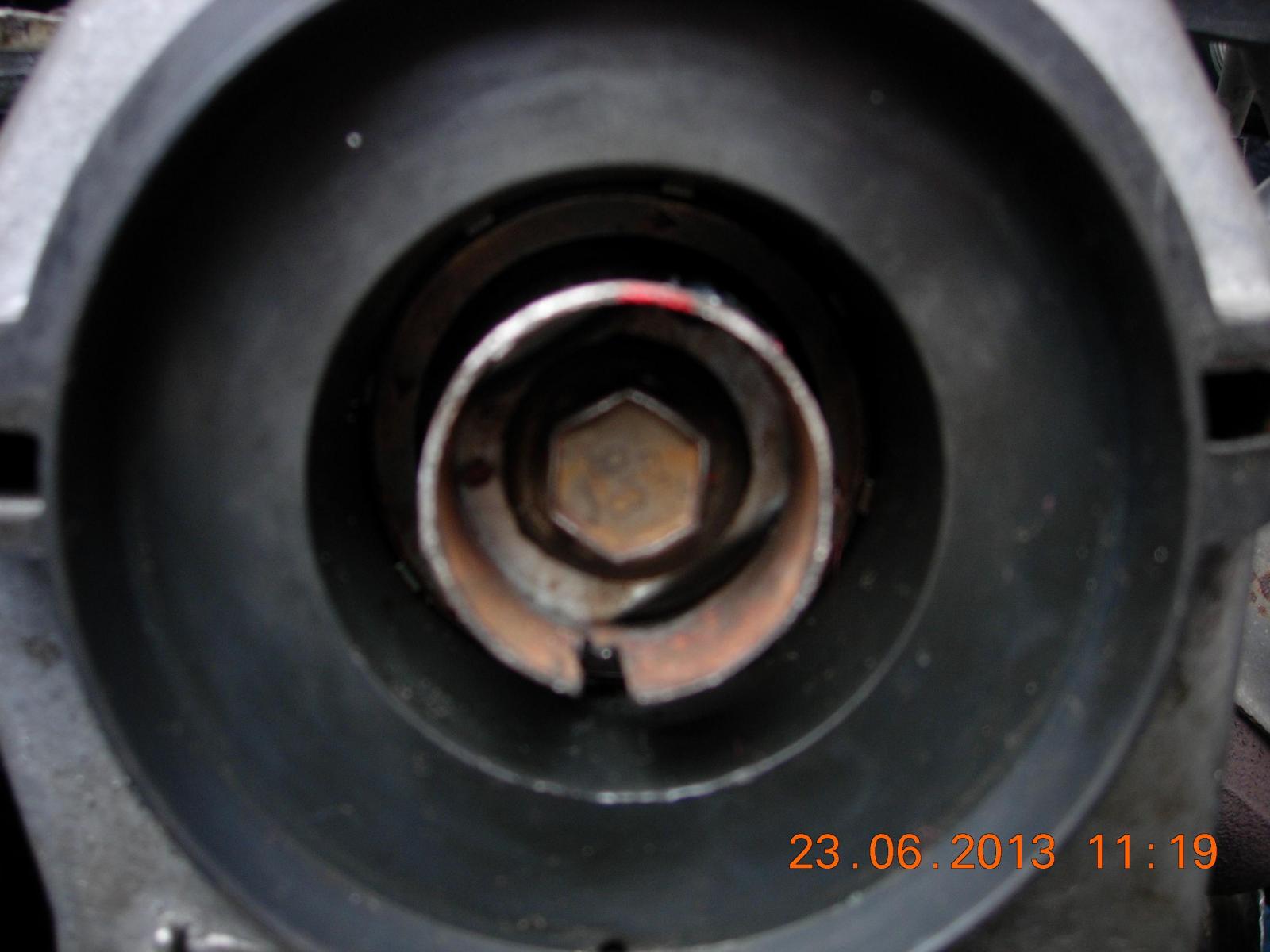

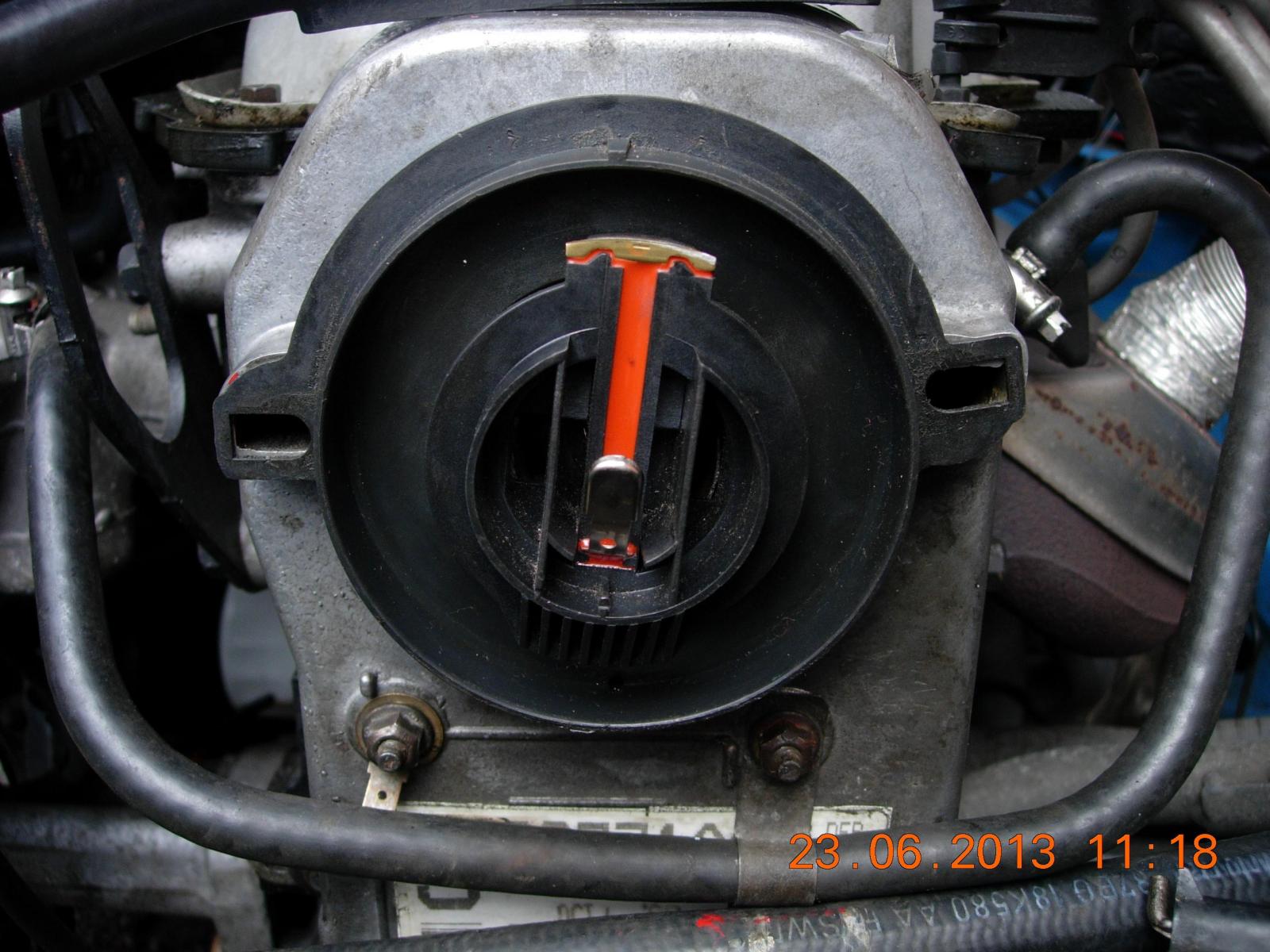

Had a broken rotor arm shaft on the same car, you can't get them new and if they do come up on ebay, they're £100, used ones are often broken.  I made one out of some metal tube with a large washer weleded on the end and bent over to grip the drive.  The rotor arm is located by a slot, so that it fits in the correct position.  I found (after two break downs) that you need to grind the shaft away where the rotor arm contacts run across it, otherwise after 1,000 miles the rotor arm shorts out and the engine stops.
