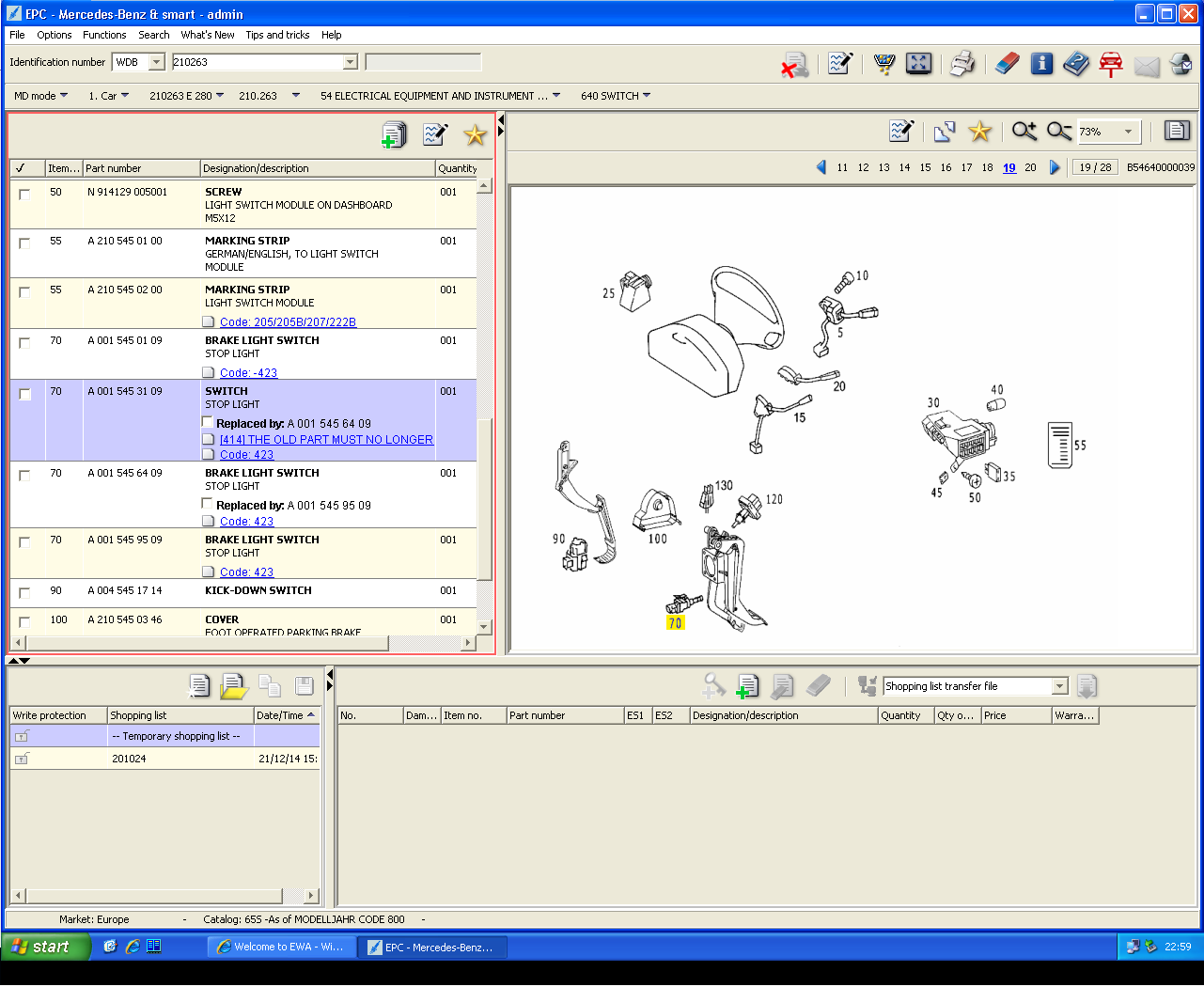

I'm just reading that 001 545 31 09 must no longer be used, and that anyone who does so will be tied up with piano wire. It has been superceded by part A 001 545 64 09, but there are in fact three  four fuckin part numbers in total:
So it's one of these 4: (item 70)
