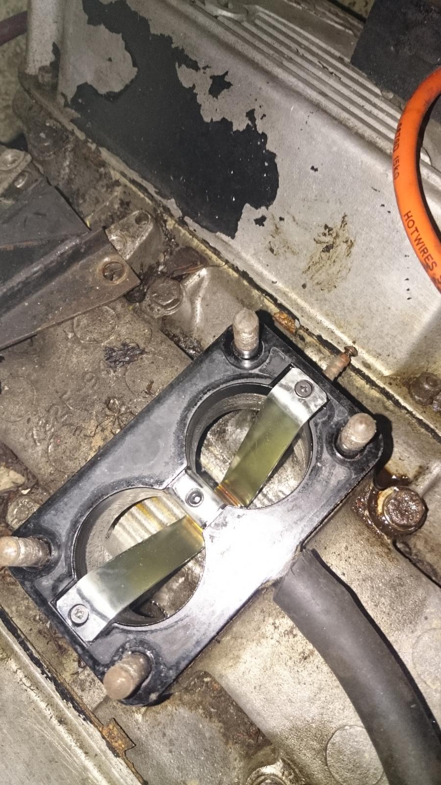

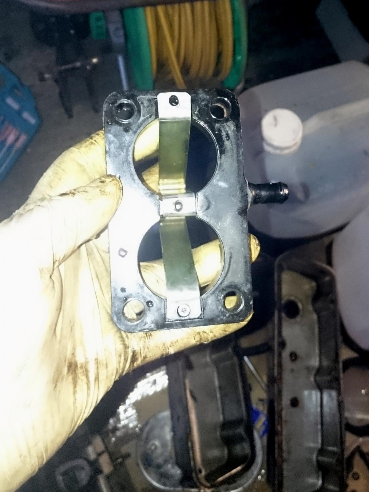

Carburettor removed. This plate, which is something to do with the breather, will play a part later. Note the two screws holding it in...

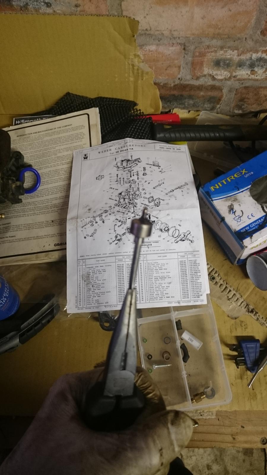

The removal and rebuild proved fairly straight forward-I'm supposed to have bits left over, right? A quick word here for www.fastroadcars.co.uk -I ordered the rebuild kit through them and when I stripped it down it turned out the power valve diaphragm was past it's best- a phone call to them on Friday morning had one pop through the letterbox on Saturday morning. Top bloke.
Inside the carb was fairly dirty, the float height was wrong and there was a couple of o rings missing so it was definitely a worthwhile job. Whether it cures things or not remains to be seen tho because...

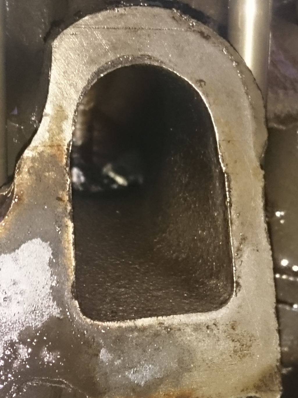

Remember that plastic plate on the inlet manifold? Before refitting the carb I went to remove it to replace the gasket only for one of the little screws to jump out and disappear into the manifold.
FFUUUUUUUUUUUUUUUUUUUUUUUUUUUUUUUUUUCCCCCCCCCCCCCCCCCCCCCCCCCCCCCCCCCCCCCKKKKKKKKK!!!!!!!!!!

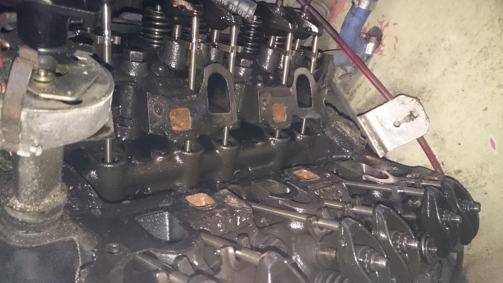

A magnetic pickup tool proved fruitless so the manifold had to come off, and let's hope it hadn't gone through an open valve into a cylinder...
Thankfully someone previously had left all of the rocker cover gasket bolts loose (the rockers have to come off to get the inlet manifold off , as I now know...) as well as some of the inlet gasket bolts. How thoughtful. Shame they did the same with that little screw...
In remarkably little time this was acheived, with the old inlet manifold helpfully falling apart and into every nook and cranny. A job for the morning...
Followed by finding this little chaps new hiding place.
Gotcha!
The threads are stripped on the plastic block so the other one will be geting flung to fuck, possibly along with the whole thing to be replaced by an external breather.

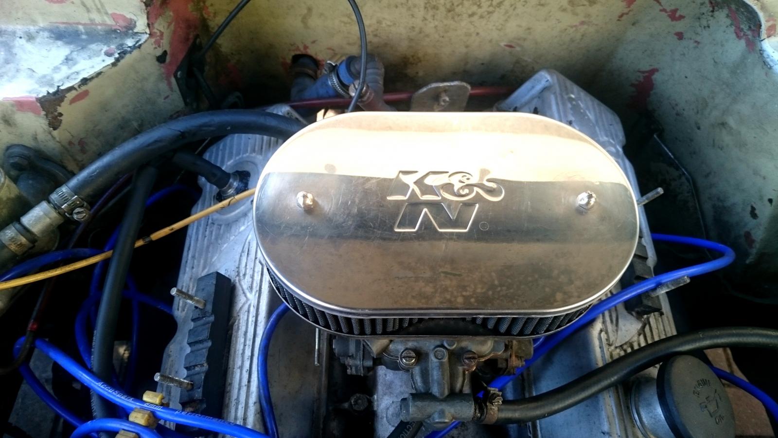

Enough chat, have some pics...

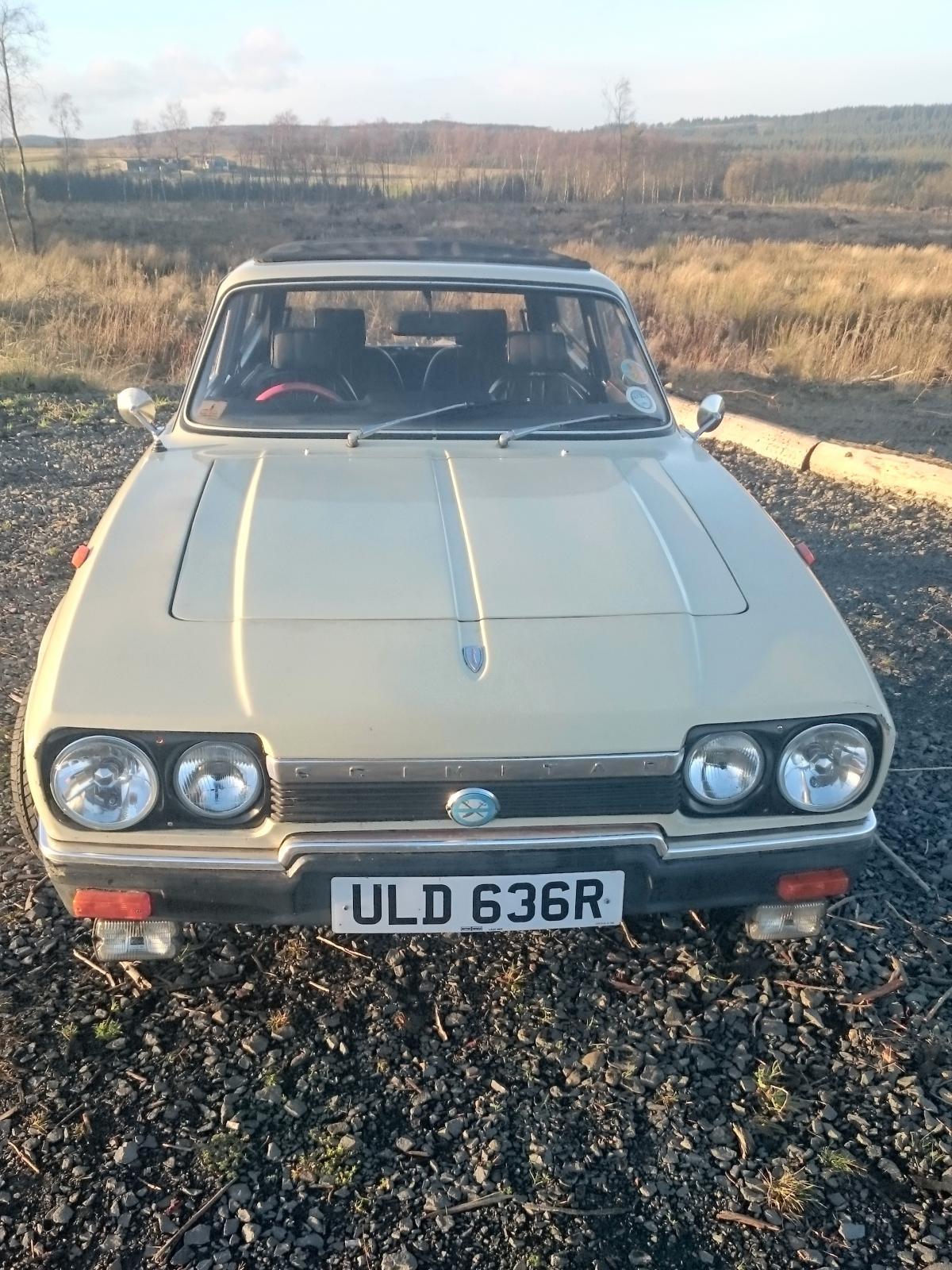

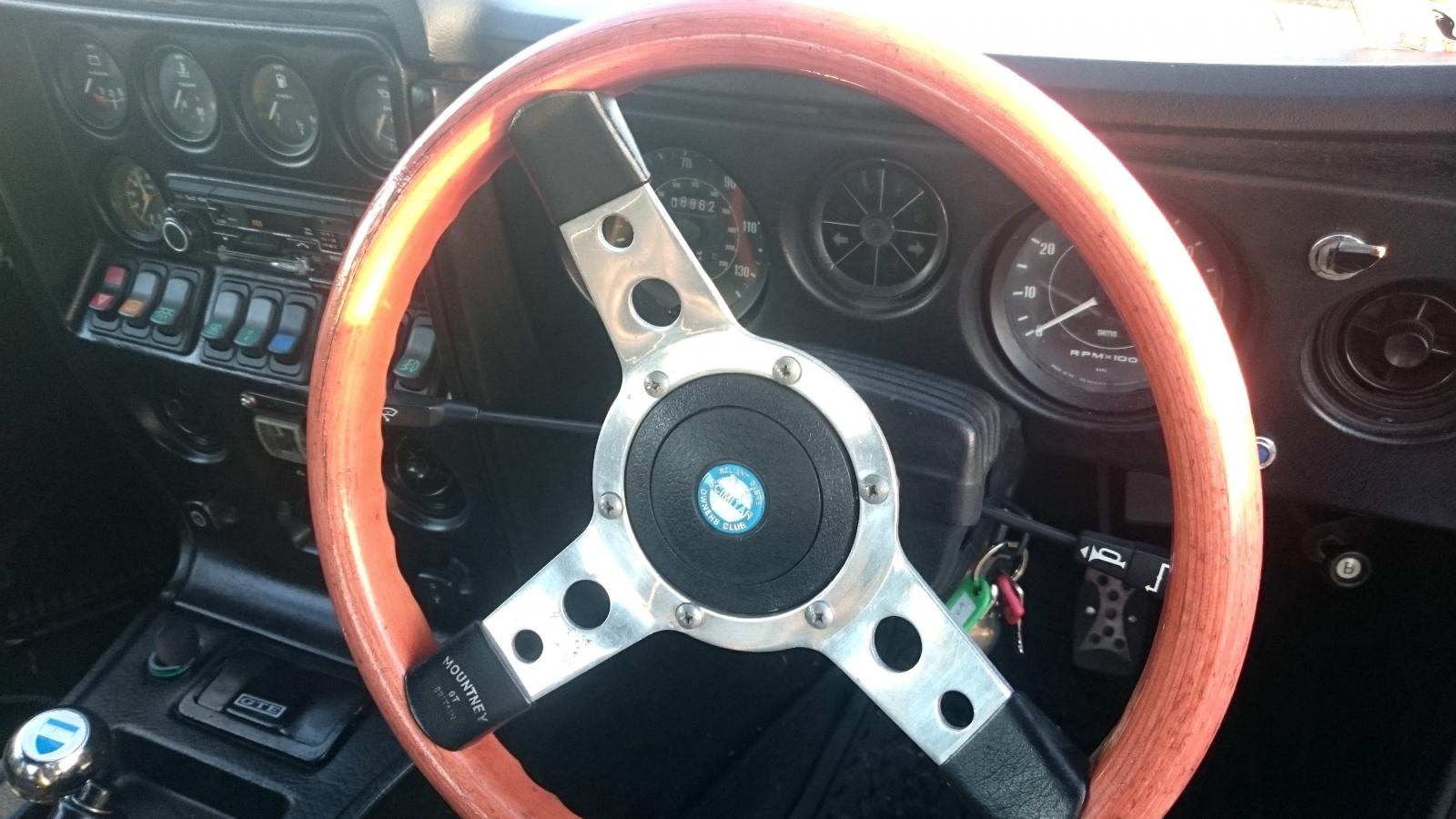

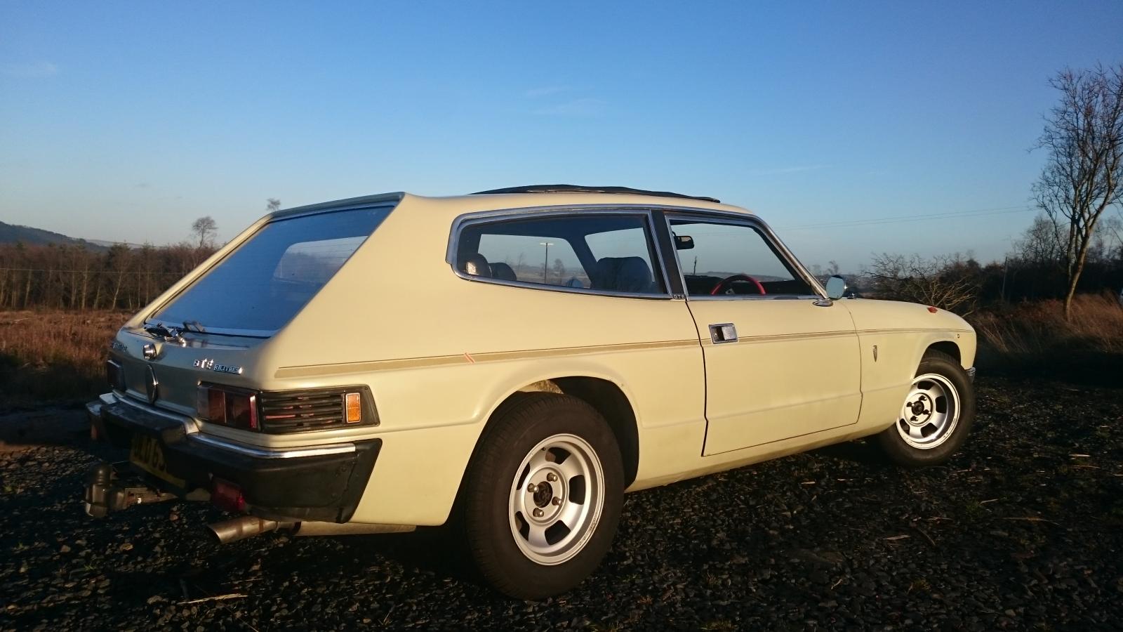

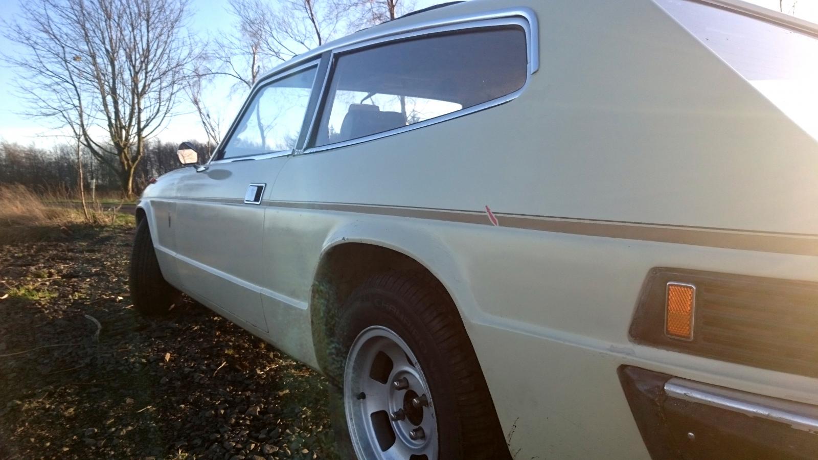

I may be tempted to part with this in the near future-I have the chance to buy one of my absolute dream cars which I can't pass up, however I don't have the space for this too :(
MOT til September 2016
4 new tires on a nice set of genuine Wolfrace Slotmags

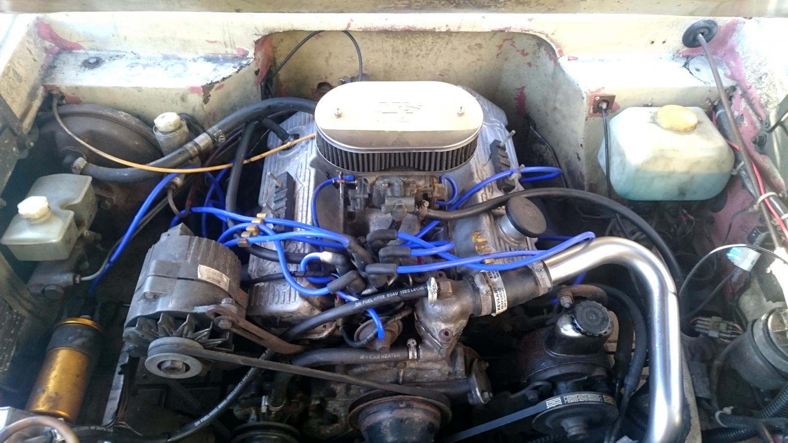

New fuel pump
New dizzy cap and leads
Carb rebuilt
All fuel lines and a load of the coolant lines replaced
New rad cap and thermostat
Stainless fuel tank
Stainless expansion bottle
Gas shocks
Polybushes
Stainles brake hoses
Recent pads and discs on the front
Chassis solid and unpainted so you can see it is metal...
Webasto doesn't seem leaky, although it lives under a carport.

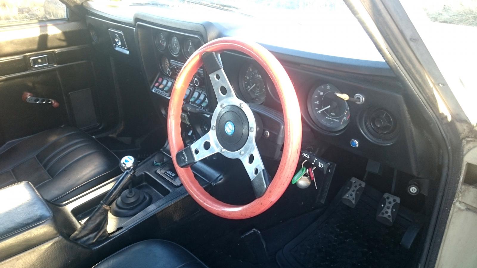

Drives very well, nice and tight and sounds fab! Overdrive works too.
Downsides:
Interior fan stopped working-you do get hot air in but it only goes to your feet though  :(

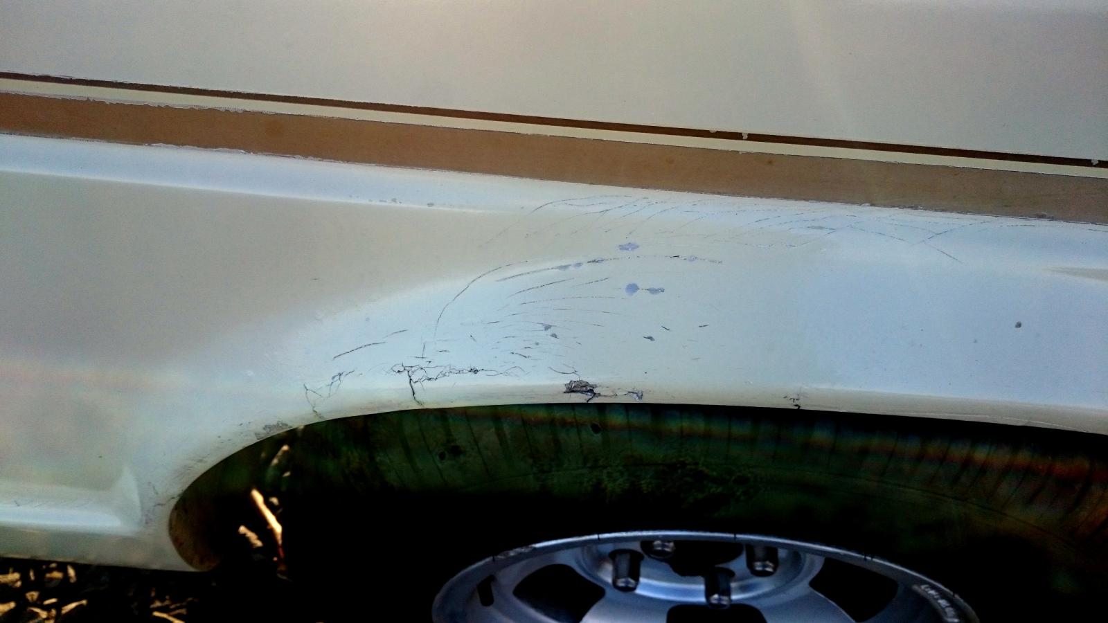

Bodywork not great-the pics flatter it.
Gearbox oil leak.
If any shiters are interested let me know. it'll be going up on CarandClassic for £1500, there is of course shiters discount available.
