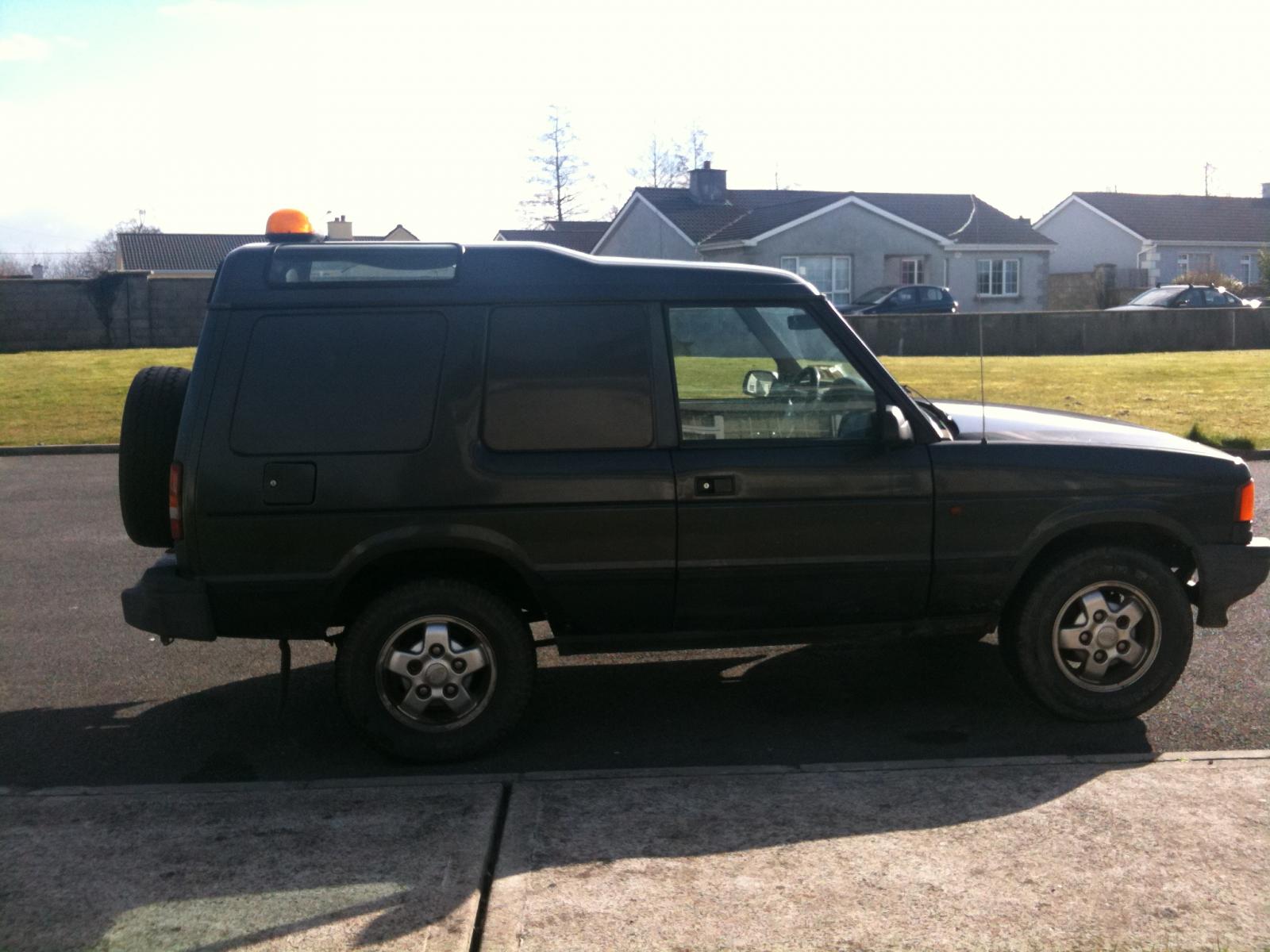

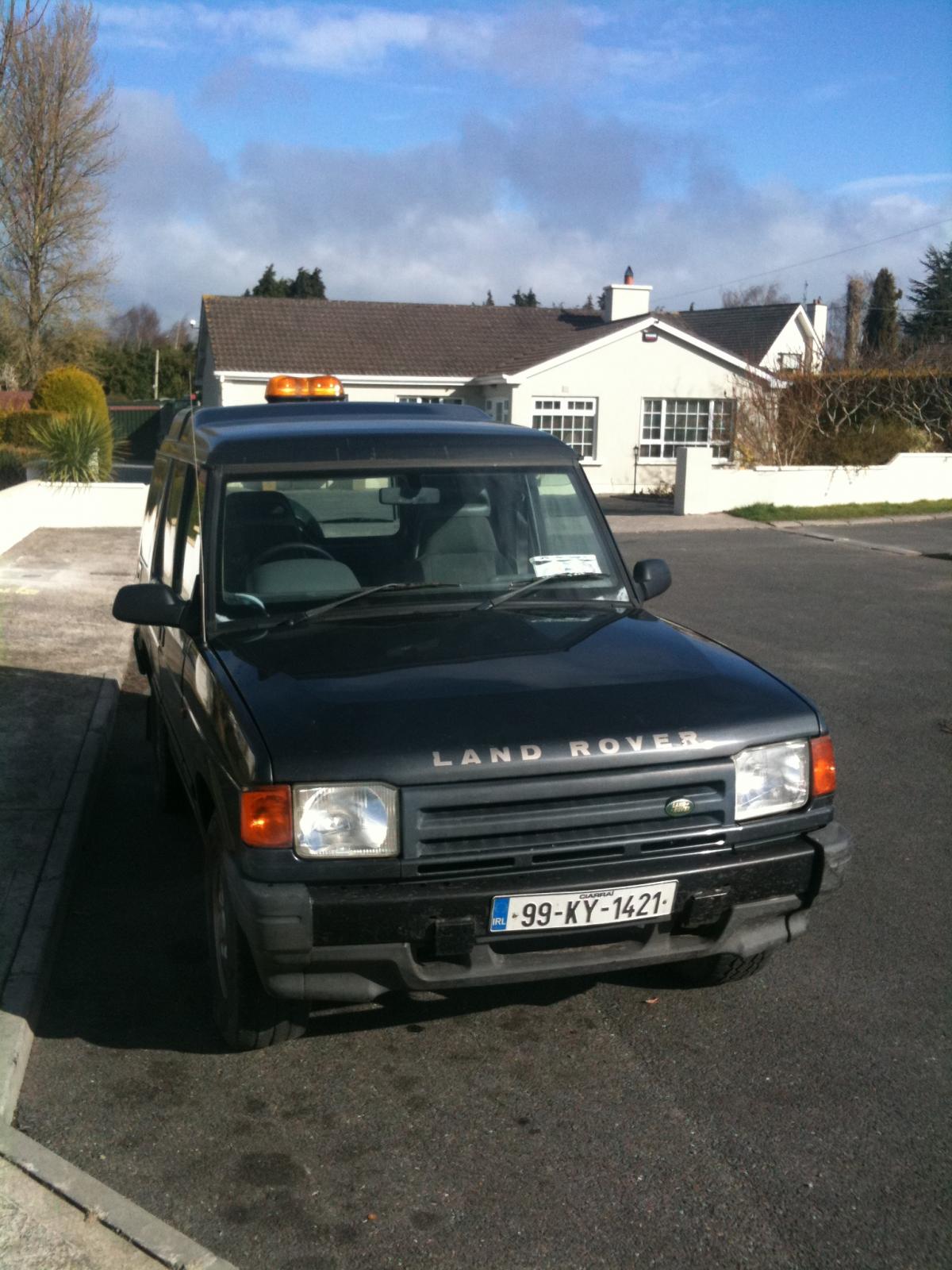

I bought this yesterday as I had no functioning transport at all, n I needed something immediately, and especially in the not to distant future to haul a car transporter about repeatedly, when I move units.
As per News24 thread; bought it off a burly bearded deep sea fisherman, who didn't want to entertain much in the way of haggling; contrary to news 24 its not 100% rust free - 'biscuit sized' hole in front drivers side inner wing, n the rear passenger back arch splash panel, mudguard mount thing is a bit lacey - but all up its solid n honest - chassis looks particularly good... these are never 'ridiculously cheap' here; always commanding a price when functioning in any way, be they road legal or not, n there is often a huge marging between a good/decent one n one that's a heap/falling to bits...

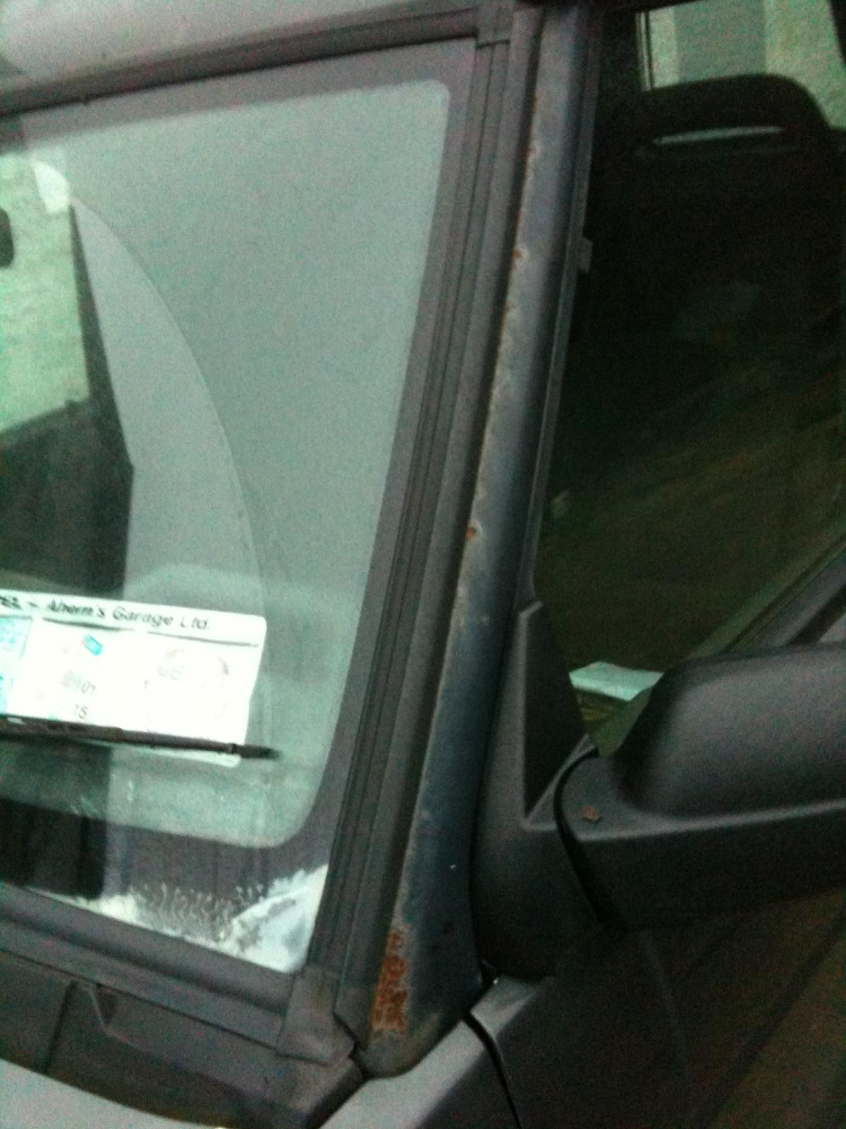

I know how bad these can rot as, as I do a bit of welding,  ive been asked on occasions to 'assess' how 'bad' the rot is, by various folk including local tight wad farmers who  never bother washing  n wonder why they rot so bad... never results in ay actual work on disco's tho - presumably they 'have a go with the arc welder' themselves or whatever - I don't know as I never hear from them again usually...
anyways back to my one; it also sported a cleverly disguised cracked windscreen (sticker over that) which i'll replace, front prop was in the back  load area as the fisherman had a few new joints put on it n 'hadn't had the time' to refit it, remains of the old 'harly spicer' joint is in a bag beside the shaft so I couldn't question his honesty... he seemed like an decent ole skin, tho 'stern demeanour n  a very pessimistic' out look on life, as my brother remarked when we got home last night; his small  talk consisted of accounts of various recent stabbings n murders n how it wasn't safe to walk about the streets after 9pm, n all sorts of doom n gloom... anyhow his plan was to buy a 'fridged van' next to keep his catch fresh for 24thrs at least...

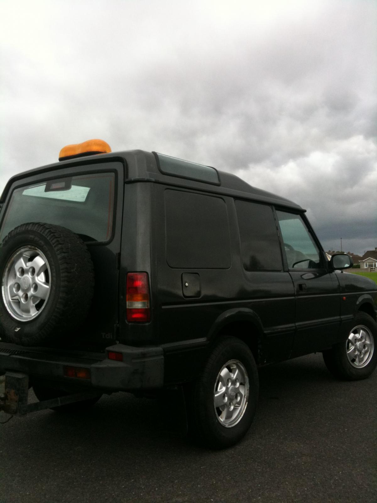

....the beacon is fully functioning via an aftermarket switch on the dash, n has proved itself very useful at 'warnin off' modern biscuit boxes at roundabouts - they dare not 'make a bust' for a gap in front of you with it on !!
3rd gear seems occasionally not to 'co'operate' but by the last leg of the journey I was finding it (rather than grinding it!) a bit more readily...
No petrol station shots, as I was stressed to the max trying to catch up with my brother as he  got lost n hooned his focus about Tralee...
1999 is late for one of these.  Hope you don't find any more rust to deal with.
Bought from a fisherman, not 100% rust free..... Chassis looks particularly good....front propshaft is in the back.

Don't go looking for more rot would be my advice...!
Yeah, they carried on sending over these to our shores, the pre-TD5, 300tdi in 2dr panelled/commercial spec long after the range had been facelifted  - must have been a gr9 seller for the stealers here !!

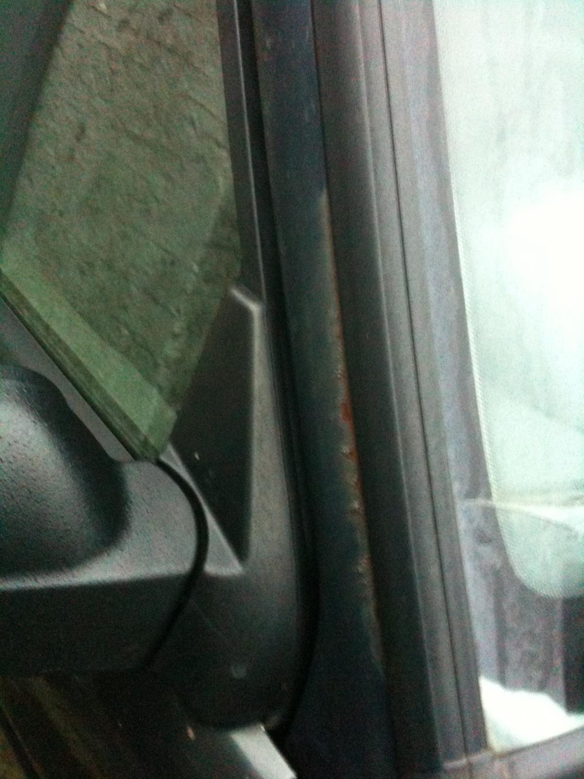

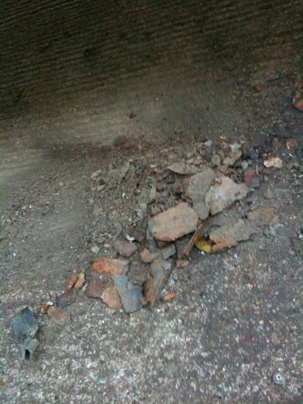

I was up early n 'poking about it' - I use the 'no mercy show to unsound metal' pick-end of a body hammer, approach so I 'made' the rust hole out of what started as a small blister, in front inner wing; similar approach all over the Disco, n no real other cause for alarm - chassis is very very good for one of these - spring mounts rear axle 'hops' n rear tank area all looking sweet n factory new...

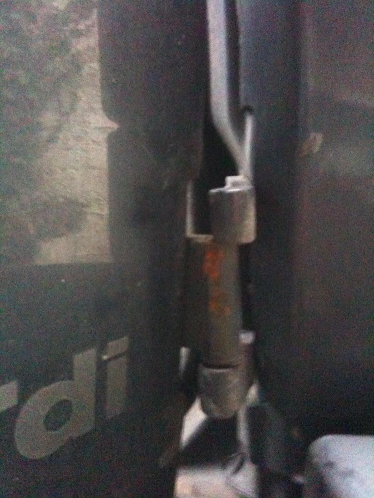

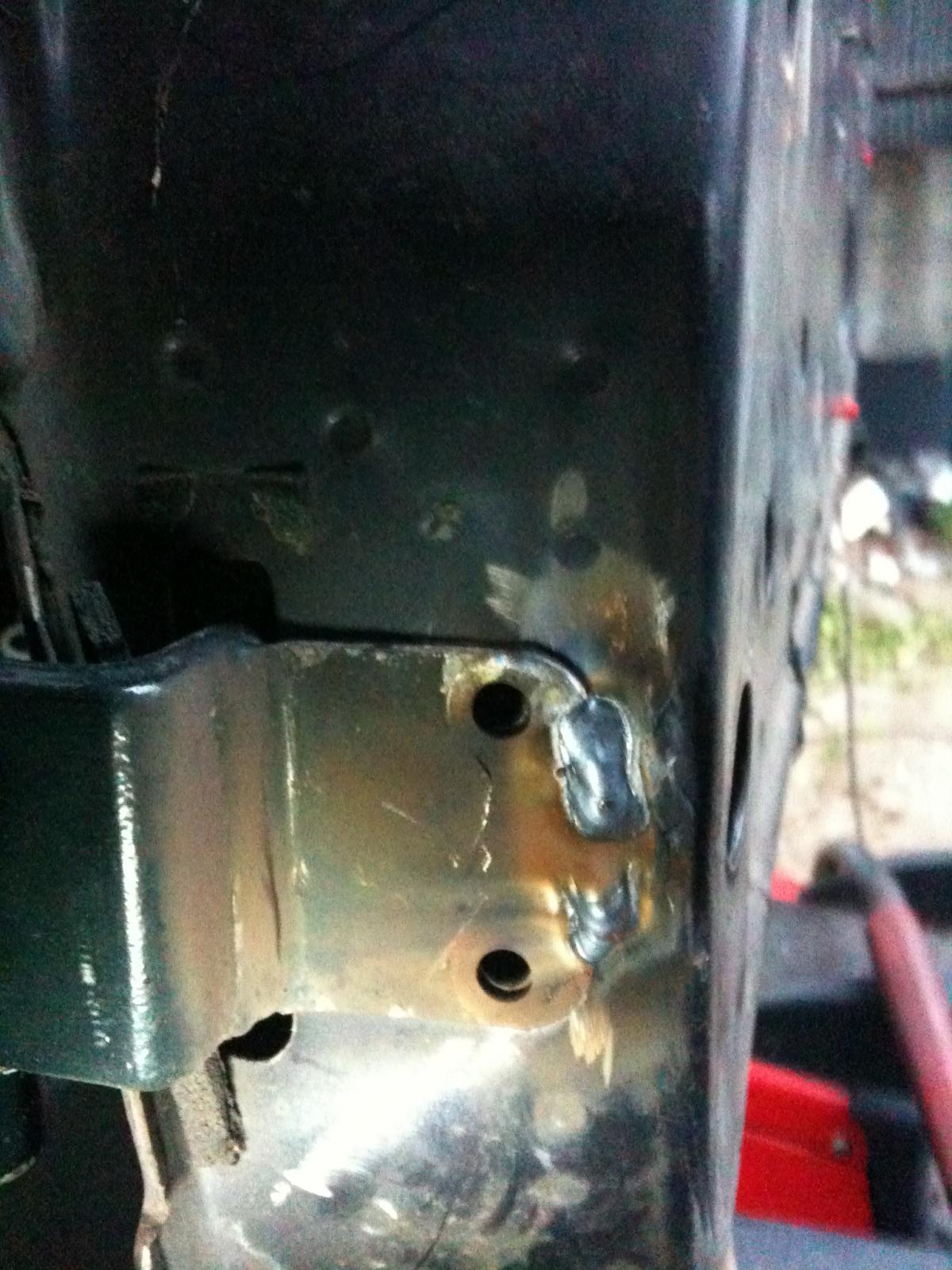

I also replaced the rear hinge of the rear door as it was arm-muscle defeating to close; got a bottom hinge off a defender 2 which doubled up as sleepin quarters for the yard's dog n stank of dog n gear oil n  was parked arse slap up against a bank at my local scrapyard - had to crawl through into the small rear opening of a foot n a half, n getting to the hinge bolts was a pain, as was chiselling off the pop riveted bit of the bottom hinge.... took about 2 hours wasa right feckin ordeal!!!

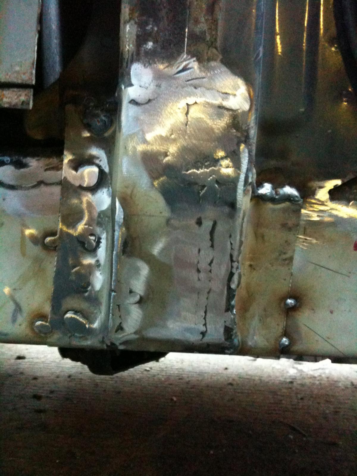

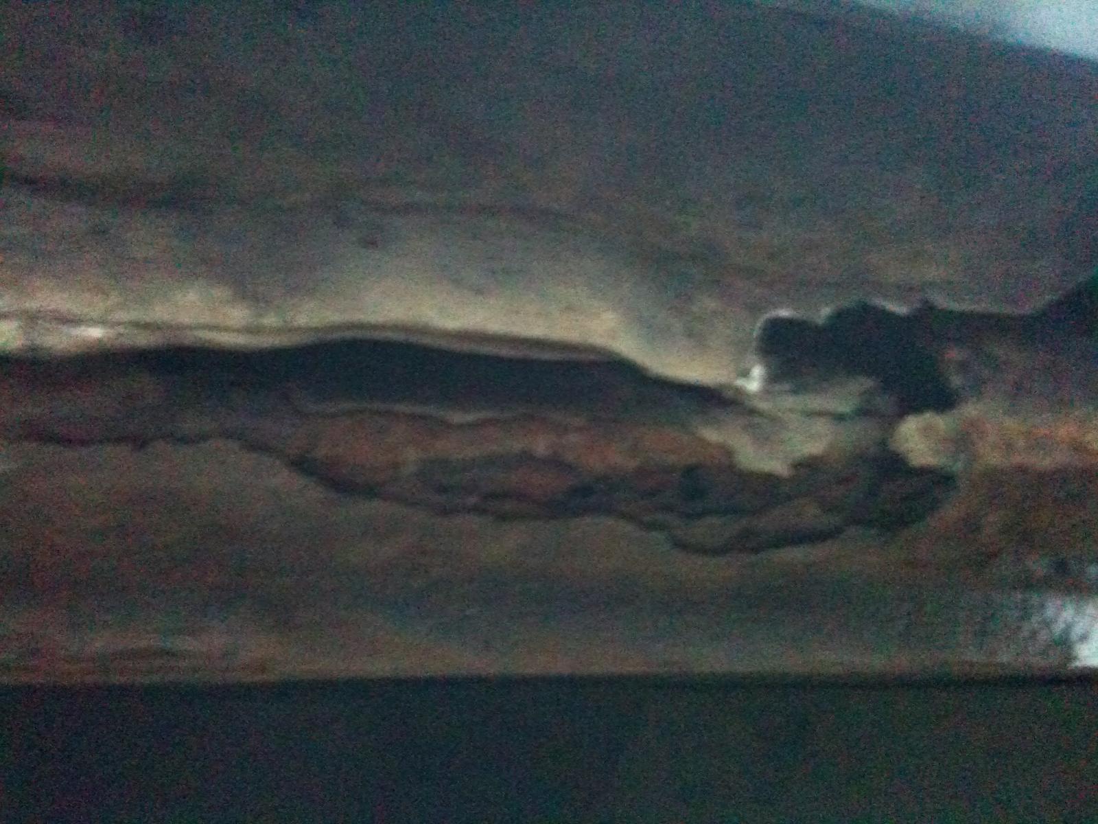

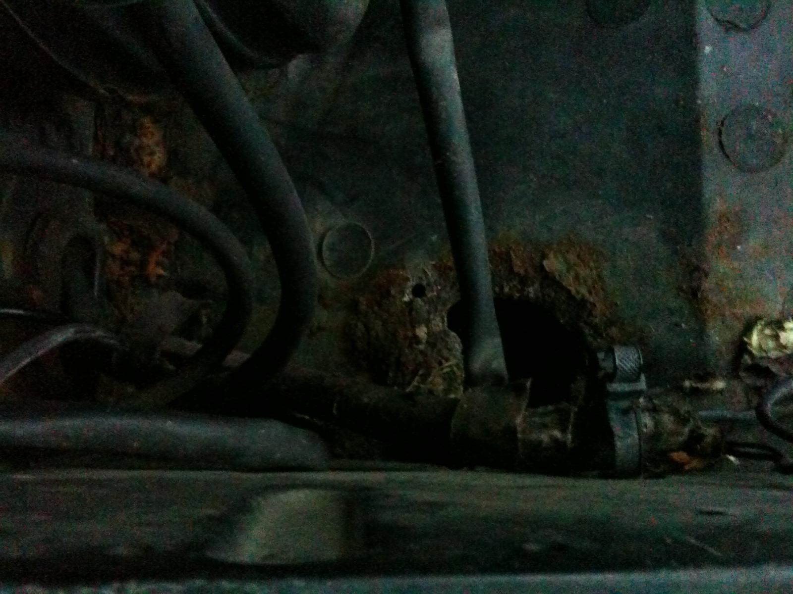

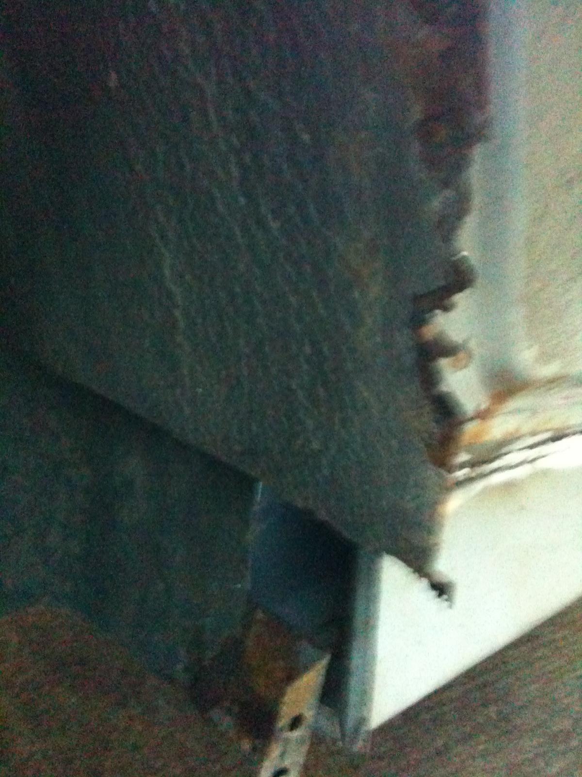

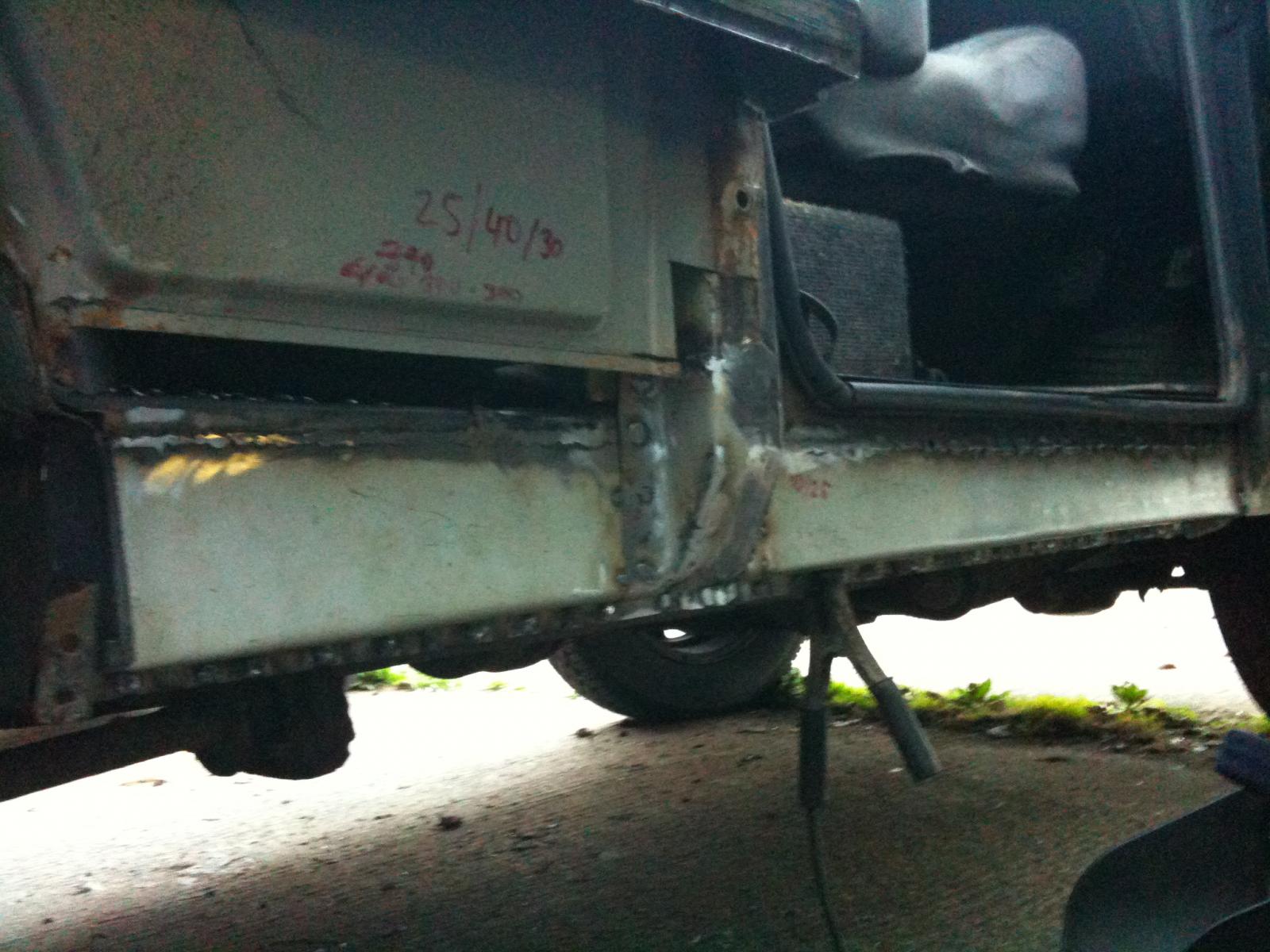

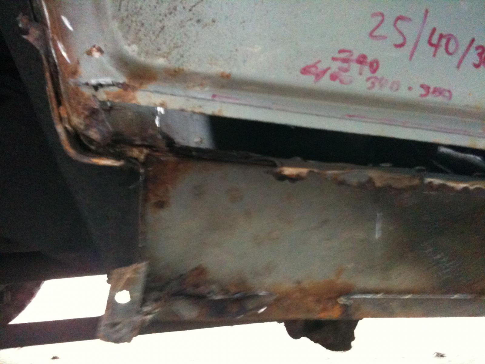

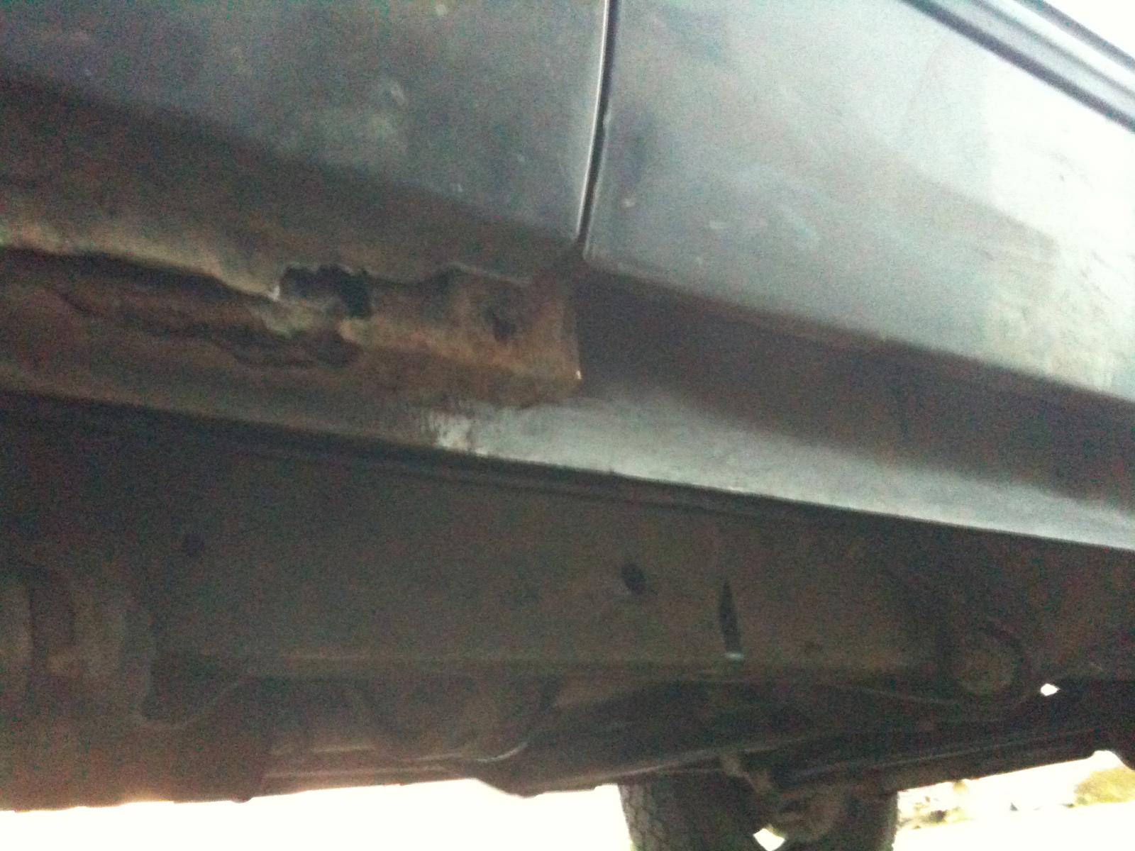

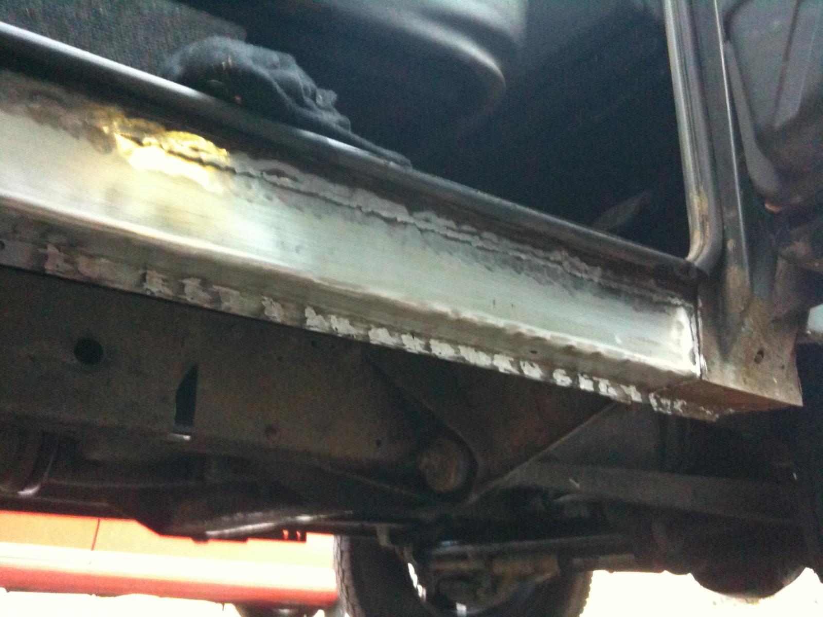

While shimmeyin en under the disco several times over, I noticed some swelling of the outer sills, n what looked like old scabby resin or underseal or something peeling off... couldn't resist havin a good aul prod...
...anyhow after a good aul jousting session with the sill trim skirt thing rulessly pulled off in a rage unbolted much of the outer sill  from the bottom of the A pillar back, had disintegrated n was on the ground in a massive discharge of rust....DEPRESSING!!!

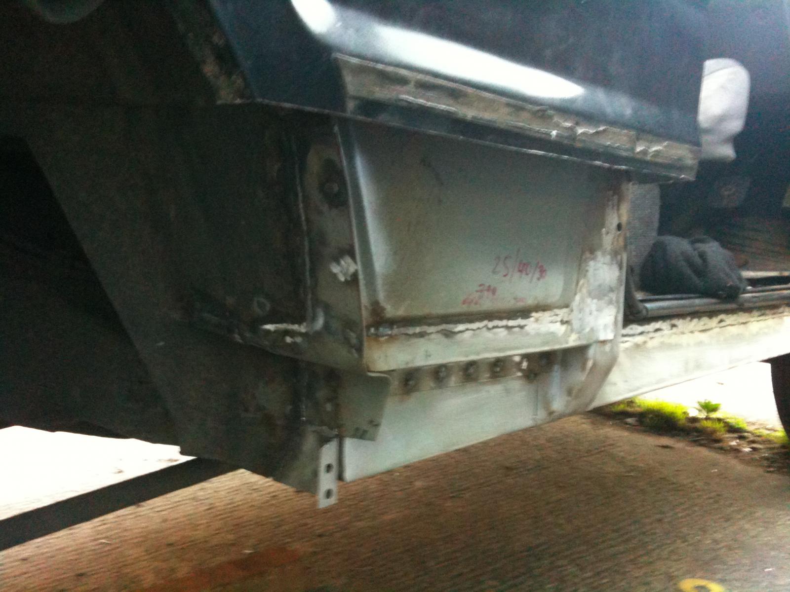

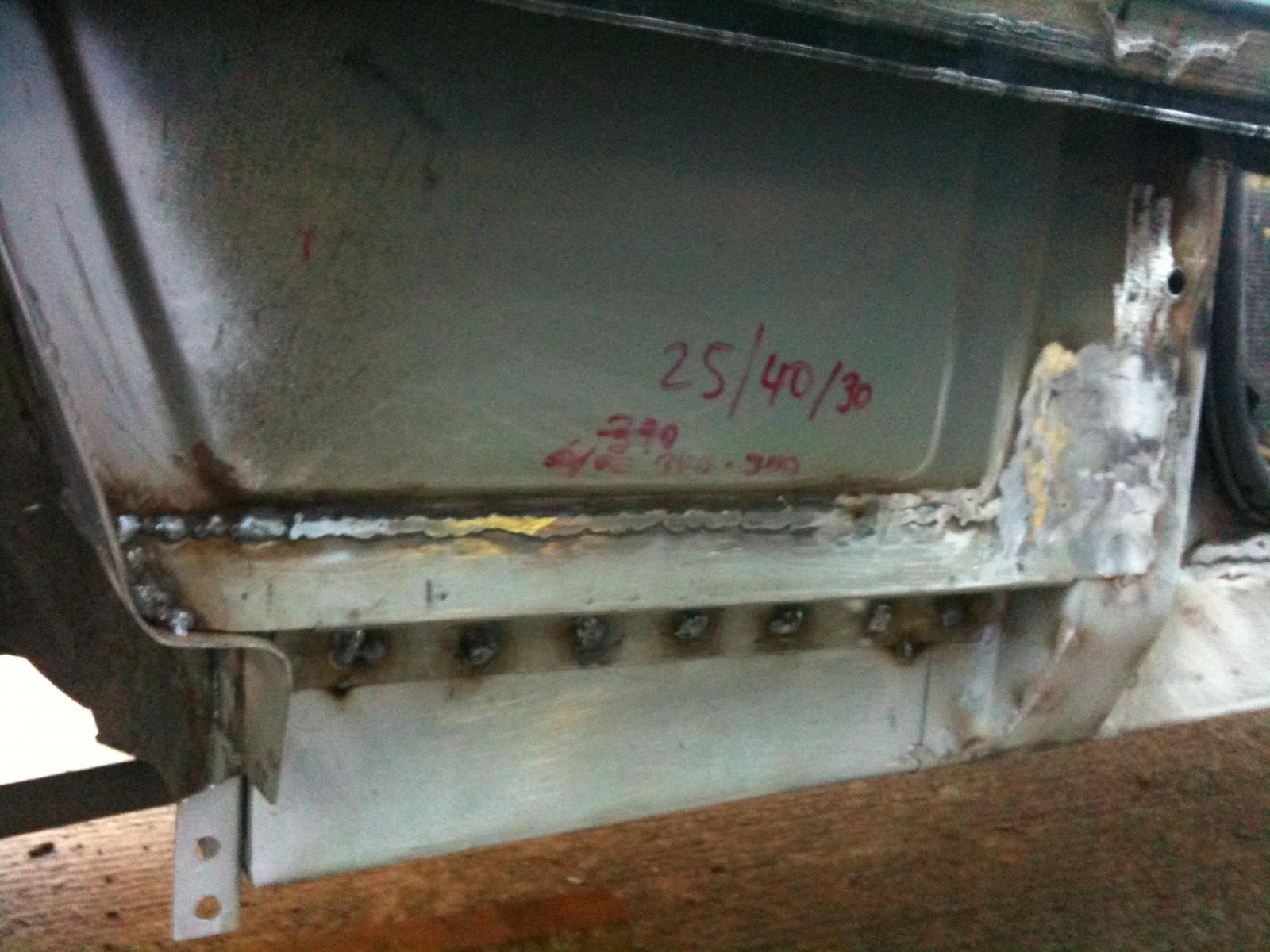

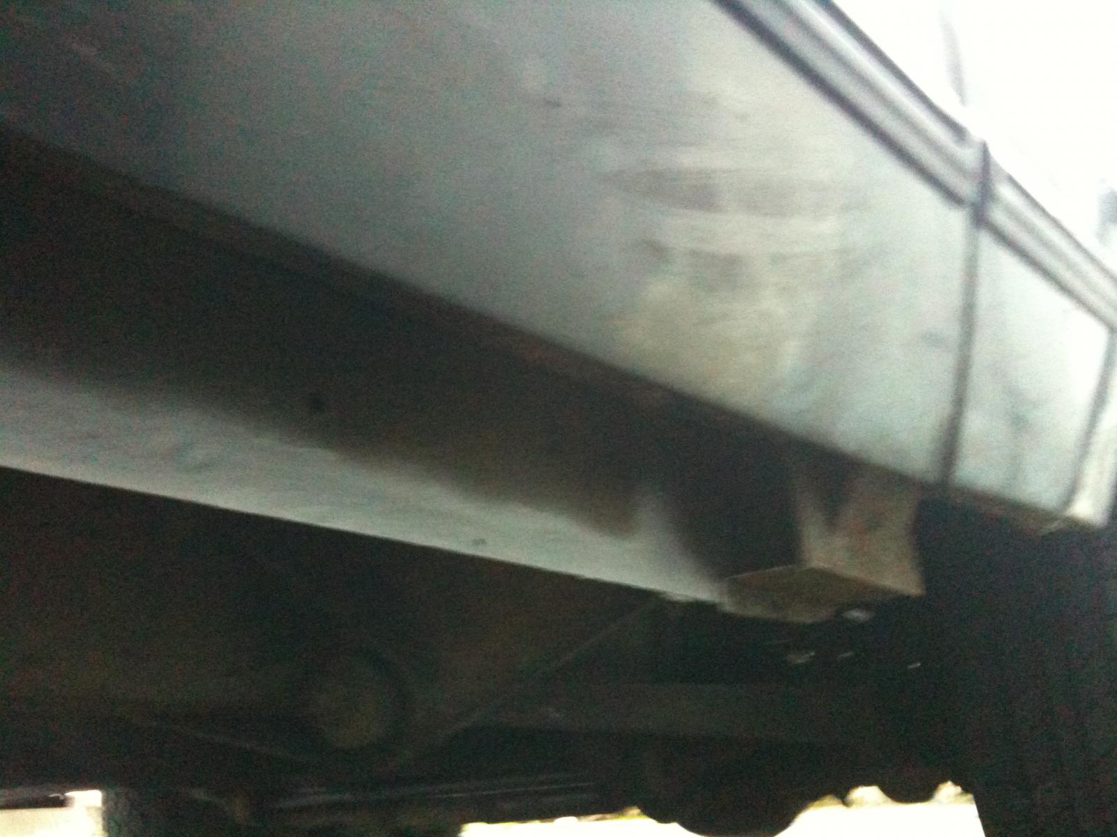

I got the measuring tape n zintec out n folded up a new outer sill, after cleaning up the inner sill which looks alright after a zing down with the grinder, n blessed it well with weld tru primer...
I left it like that for about a week, driving about with no outer sill n the rear alloy quarter skin flappin about...
Today, I welded in a 'half outer sill - to the B pillar (didn't take any pics as I had to pack up as I had steak n mash to cook at 9pm tonight)...
As for the remaining rear sill area; Ive been debating about what to do about 'access' to the  sill -its covered by the alloy skin rear quarter; Ive got as far as removing all the inner trim n getting all the quarters 10mm bolts out, but its well glued on there - obviously I use thing disco daily so getting the panel off will be a fairley involved job, n means it will be sat up for awhile....
The other alternative is to just cut the bottom of the rear quarter off at the /under plastic trim line, welding up sill n reattaching the quarter section with a drilled plate in under the cut, n riveting it back in place, and the plastic trim then glued untop to 'cover the cut' - I can alloy weld, but I don't have an AC/DC welder, so its rivets plates n seamsealer to reattach...  Im not a huge fan of such outwardly asthetic bodging but its a lot more straightforward that taking off the whole feckin rear quarter!! Any other disco owners have experience of this sorta headache...??

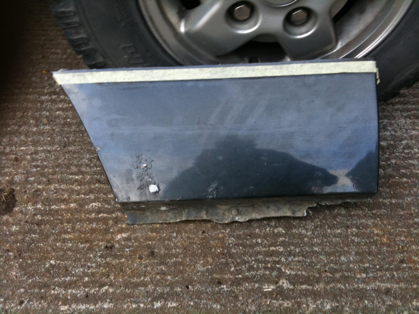

Ive just picked up an offcut of ALLOY CHECKER PLATE, n im contemplating bending that up as per the lower rear quarter, to rivet on after I do the remaining sill welding; I might spray it black to tone down the 'ONE LIFE-LIVE IT' look... The present lower rear quarter is all furry, thin n near to being holed....
I have to go n buy a new pop-riveter as my Present Draper one doesn't seem to be gripping the pins; ive used it all of twice previously; literally on two rivets, but it lain idol for about 2 years...

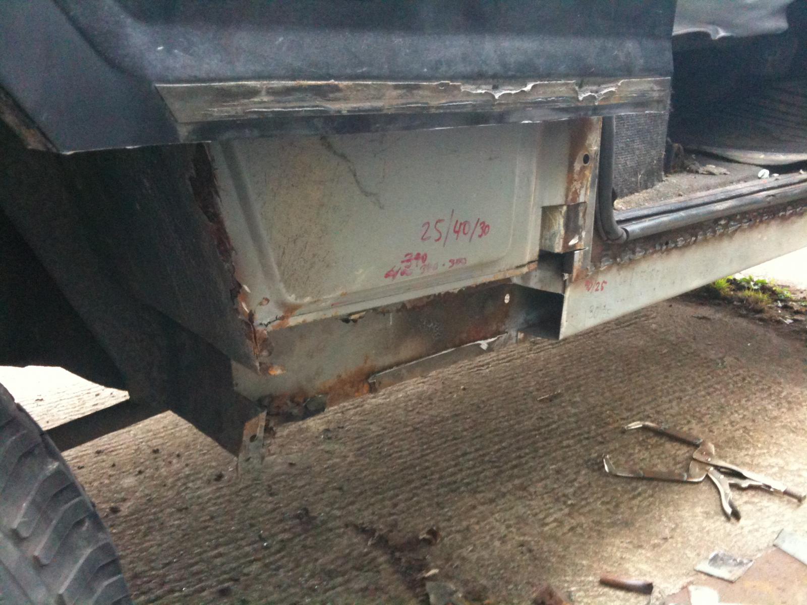

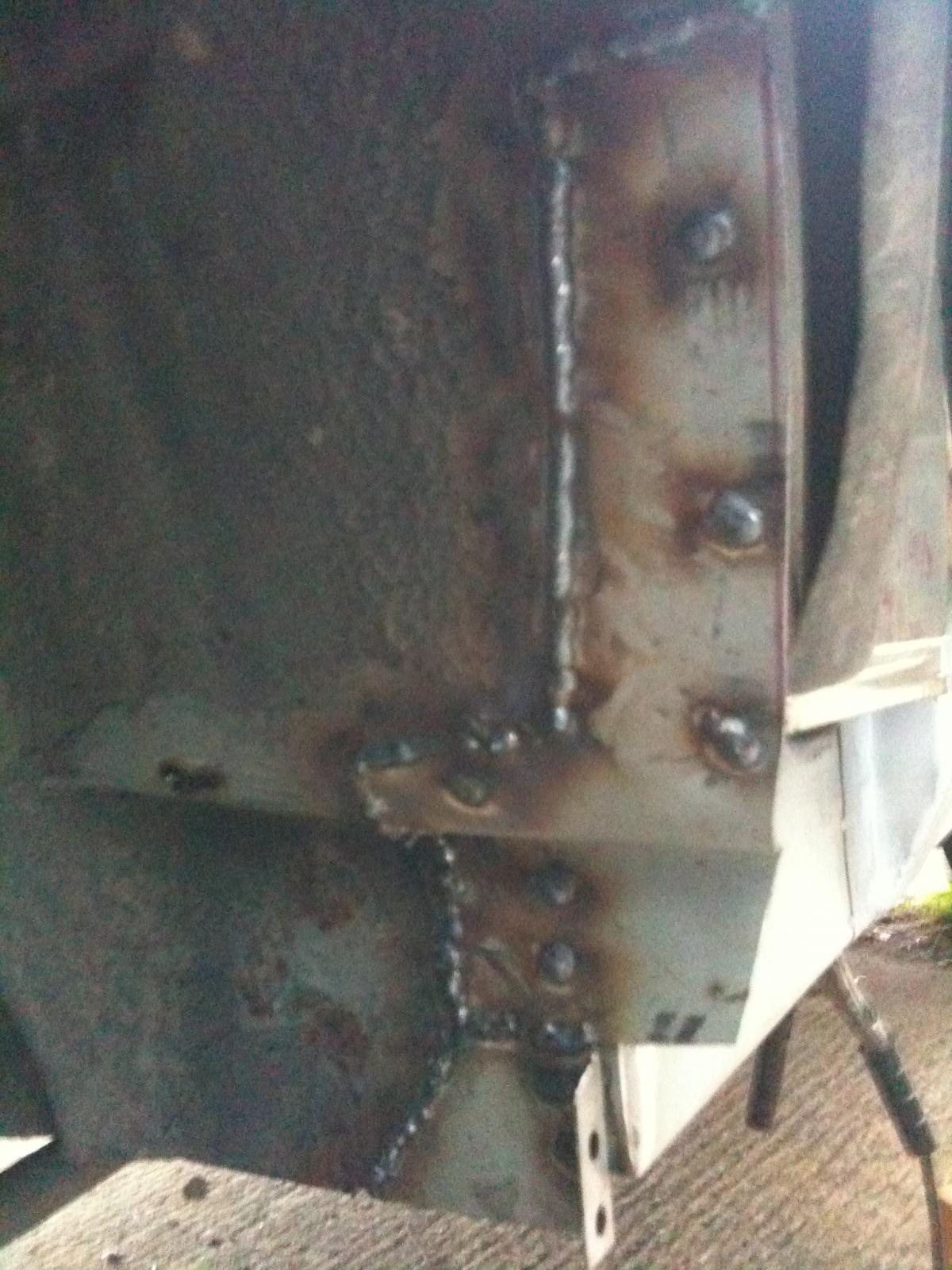

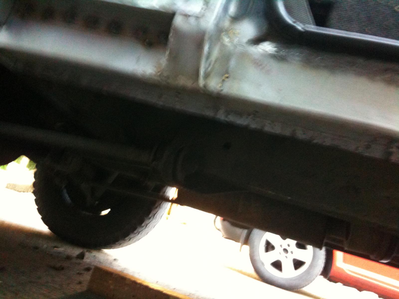

...been at this disco since Monday off n on - ive about 25 hours in the sills n adjoining panels n part of the rear floor, which I managed to patch; as with all commercials here, the floor has to be flat, so theres a box section 'raising frame n 3mm plate covering the main floor n bits of tin 'filler panels' forward of the wheel arches - I just bent back the tin filler panel bit (pop rivets to the box section frame were not that accessible) n managed to get a patch in there to meet the top of the inner sill...

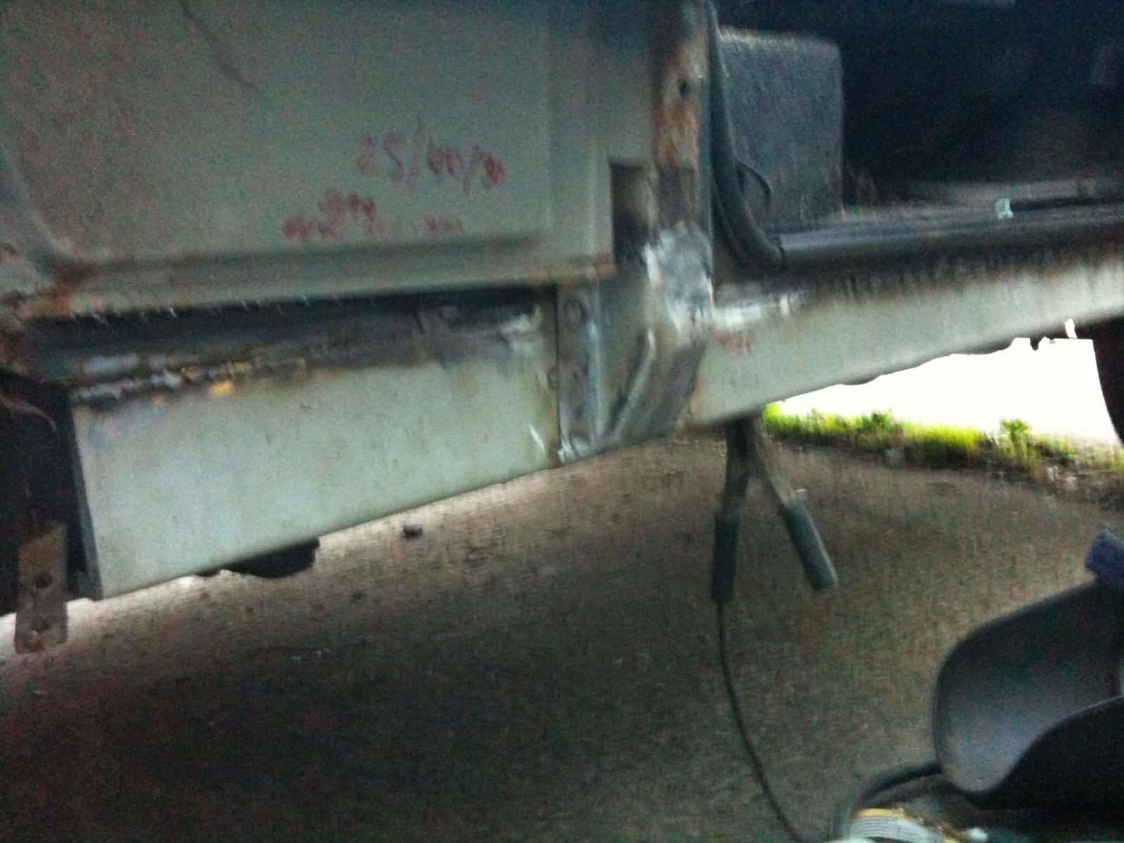

I bent up the outer sills outta 1.2mm zintec, using one of the RSJ's that supports the neighboring barn....
Its been a right aul weldfest, as you can see from the pics; so much for it being 'pretty much rust free' post purchase- I lashed on some primer seam-sealer n handpainted back top coat (aldi's 'metal pain) this evening - no pics of that as it got everywhere, including all over my hands..... plan is to pop rivet the alloy outer panel I chopped off, with a bit of drilled 2mm steel behind it, n stick the rubber outer trim on to hide most of the join....
The passenger sills do look solid; so much was ''crunchy nut cornflaked' with rust on the drivers side I had to use the passenger side sill as a reference occasionally n it does look solid....

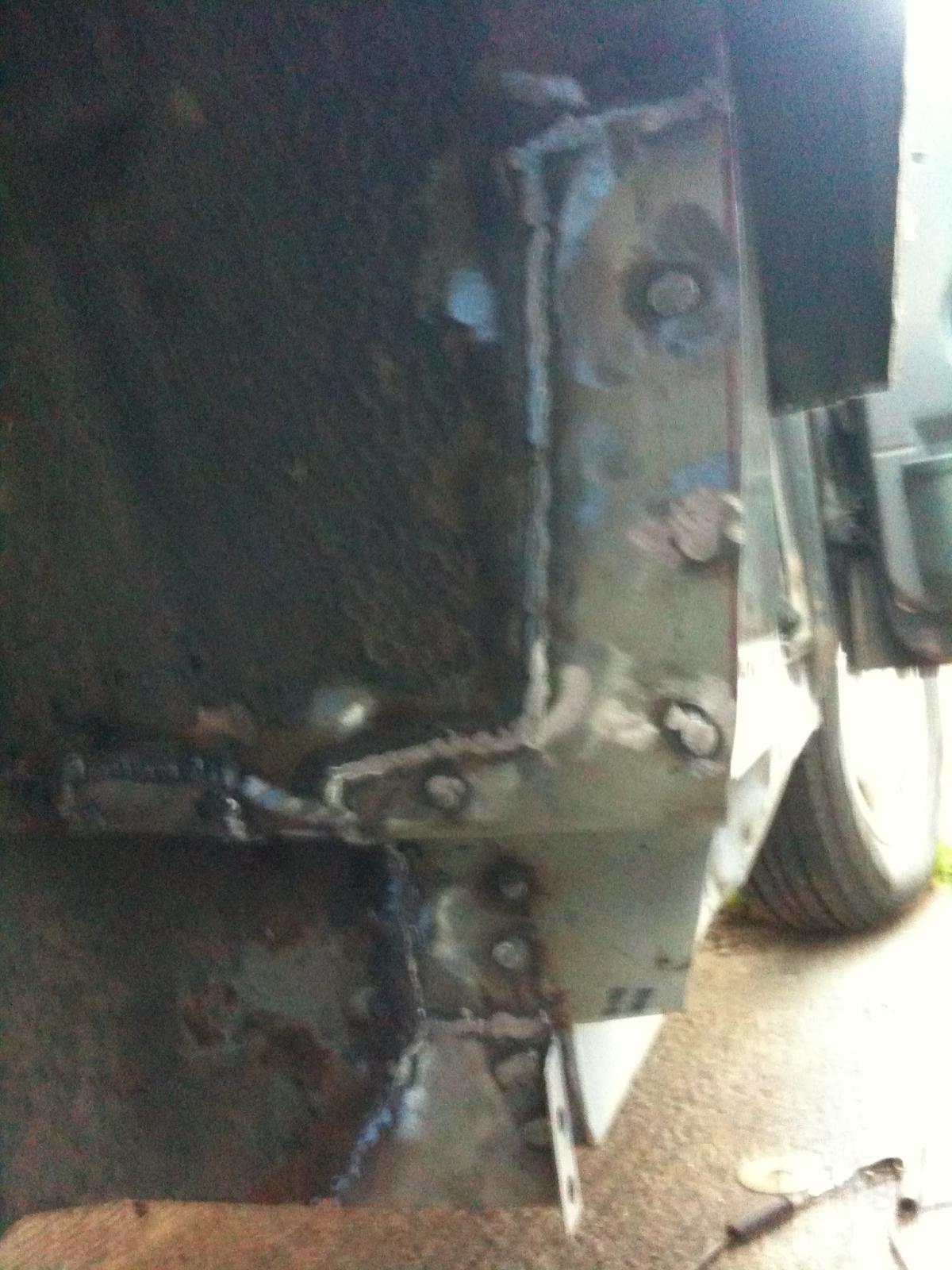

more pics of 'the ordeal'...
...eh, thanks - this disco effort was more a case or 'getting it done quick' /its a jeep etc 'devil may not give a shit' approach , as I had to leave the jeep overnight at the lock-up n use another borrowed car, so needed it back 'under me' again- but it didn't turn out too bad ....
I just have to reattach the quarter cut bit, n reassemble the inner panels, which I took out as I had half heartedly contemplated taking the entire rear quarter panel off, before sacking that off, as 'too much of a big job/bordering on a 2 month project etc etc
