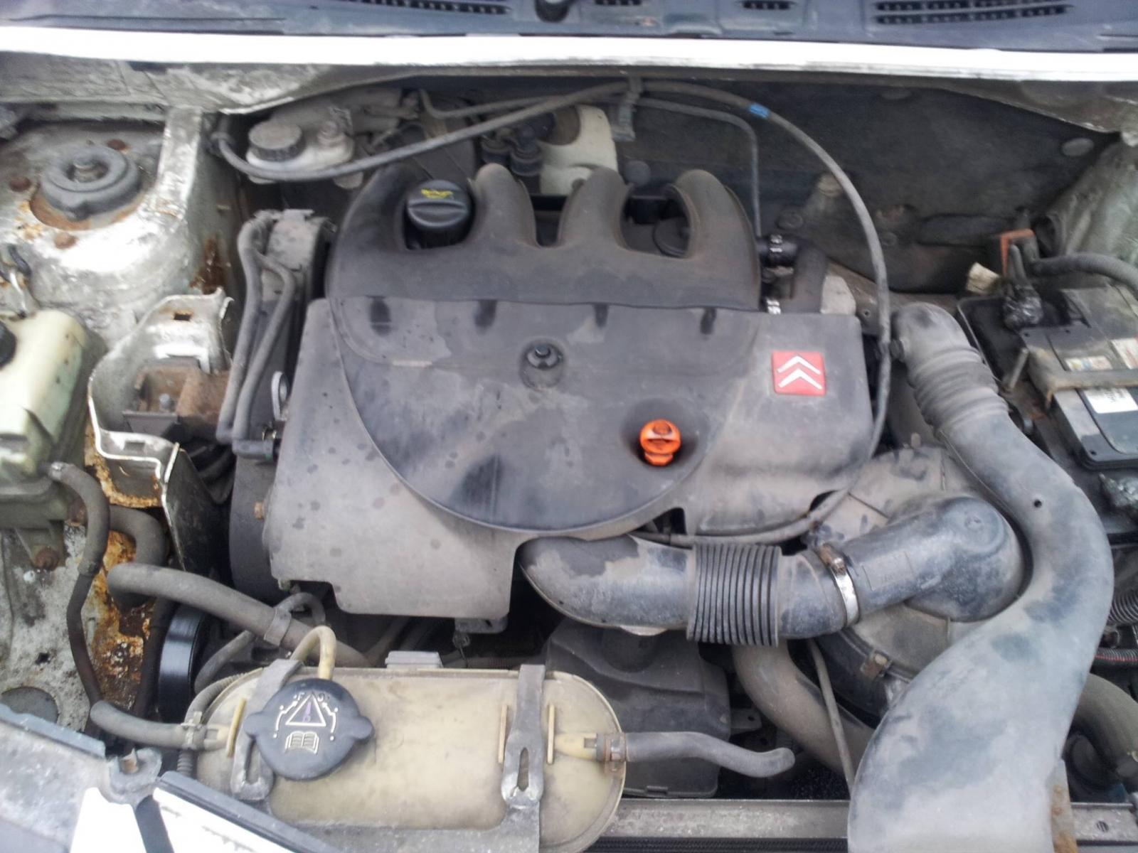

I should know but I don't is this veg friendly or not?
What car is it in Cav?
It looks like a DW8 engine in a Berlingo, hard to tell the make of the pump without removing the engine cover.
CITROEN 41301080 BERLINGO-1,9D/1998-02/WJZ(DW8/LW3/4cyl./1868ccm/51kW/69,36PS/BHP/4600min-1/BOSCH/RP/1-Tank 1-Tank-Kit 558.72
CITROEN 41301090 BERLINGO-1,9D/1998-02/WJZ(DW8/LW3/4cyl./1868ccm/51kW/69,36PS/BHP/4600min-1/LUCAS/RP/NO-Tank NOT POSSIBLE 0.00
CITROEN 41301100 BERLINGO-1,9D/2000-05/WJY(DW8B/L4)/4cyl./1868ccm/51kW/69,36PS/BHP/4600min-1/LUCAS/DELPHI/RP/NO-Tank NOT POSSIBLE 0.00
Ta muchly, year 2000 Berlingo that seems to be absolutely gopping.
