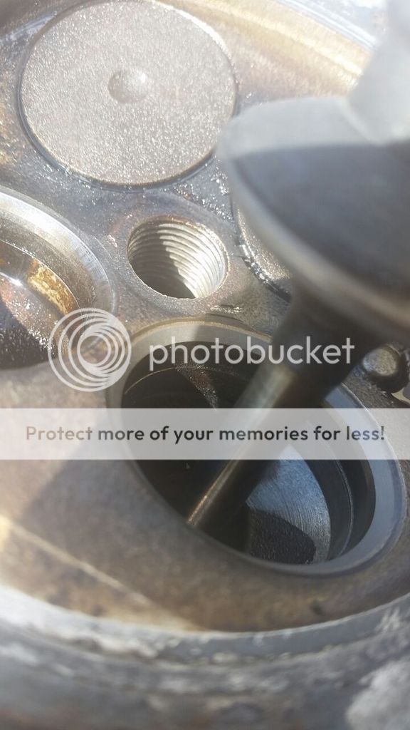

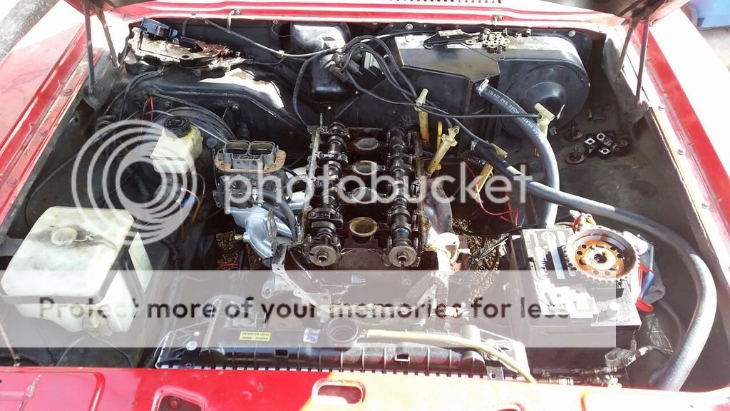

its done (ish) lol it runs, drives and stops, is taxed (exempt now) and well what can i say, its awesome! we did have a little hick up, we had an air leak, which we solved, pulled the carb and resealed it jobs a good'un but we still had a rubbish idle, we ended up with a compression tester which ended up showing number 4 cylinder was low at 100 compared to about 170 for rest so Carl stripped off the head as the only thing we could think off was when the timing jumped which happend god nows how after the first fire up and after the exhaust was done, we went to start it but it jammed, after head scratching we rechecked the timing and it was way out, technically its shouldn't really possible, Especially but the amount it was, it bent a valve which it had, lucky thou carl has some spare so he swapped it put and wallah idles a beut and runs nice, just needs setting up a bit now as she runs lean, had the idle set at work and subsequently broke the gas analyzer lol but now booked for a rolling road set up.
Enough of my confused waffle, some pictures!!
