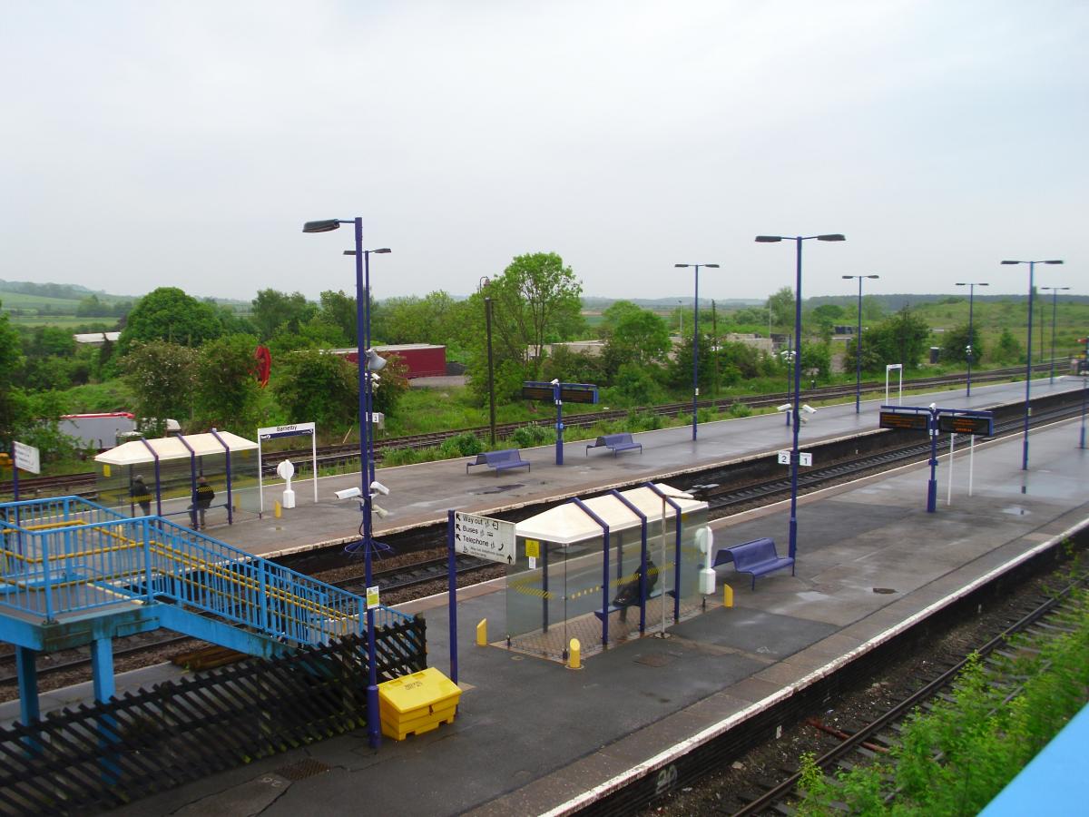

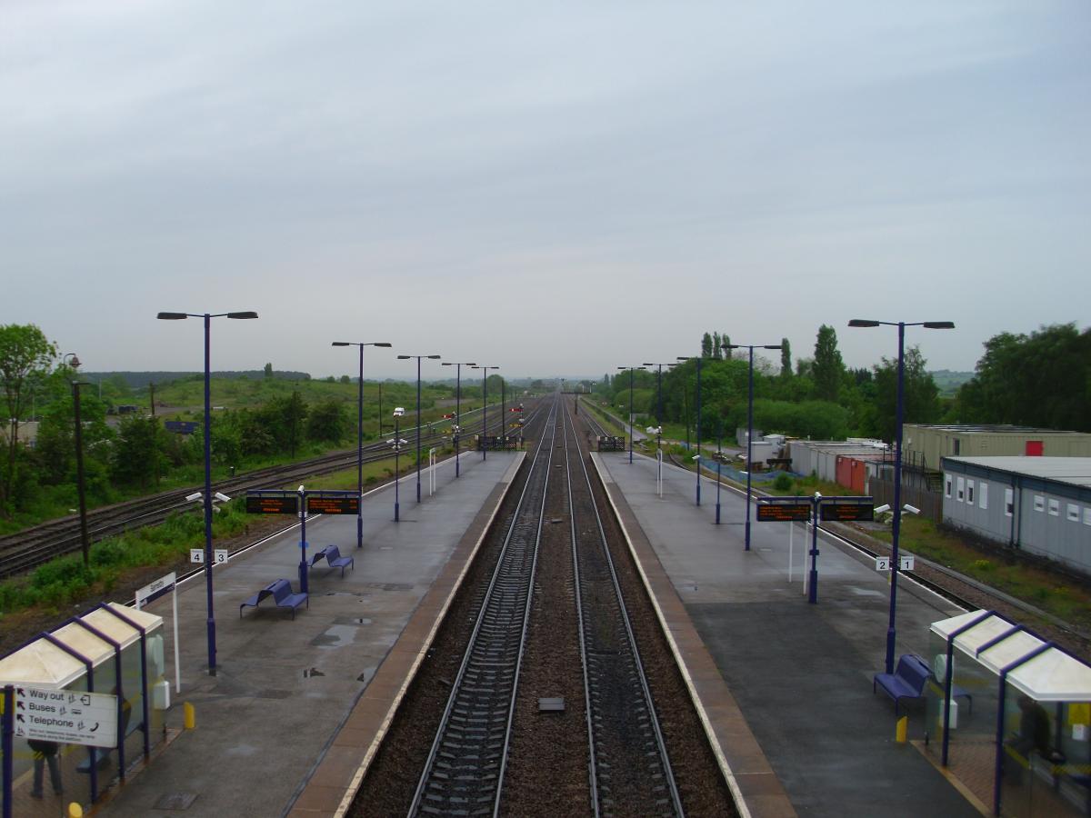

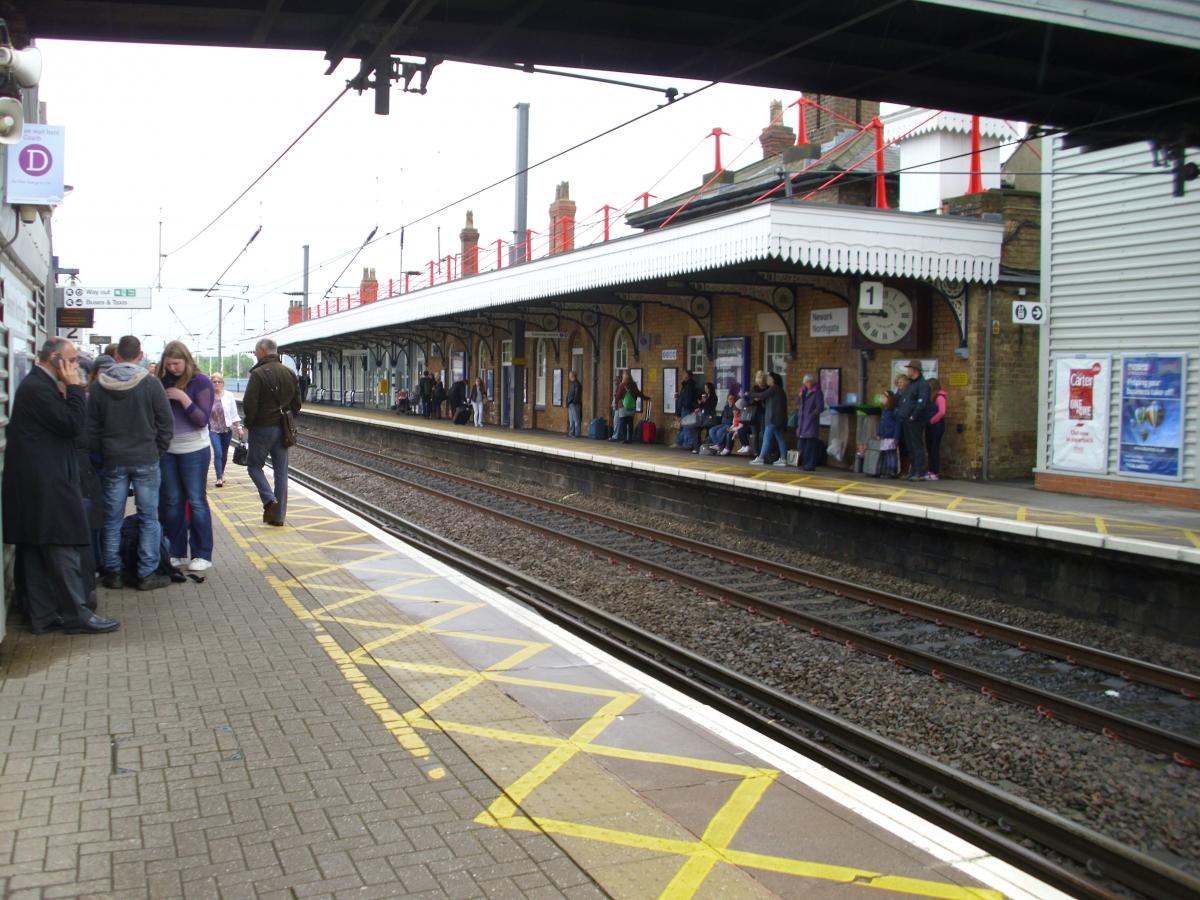

This is it. Barnetby.

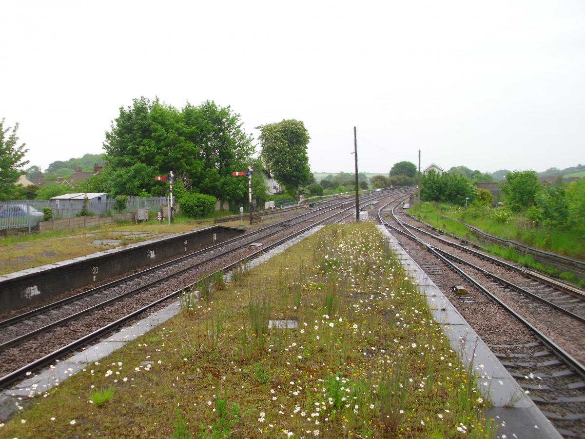

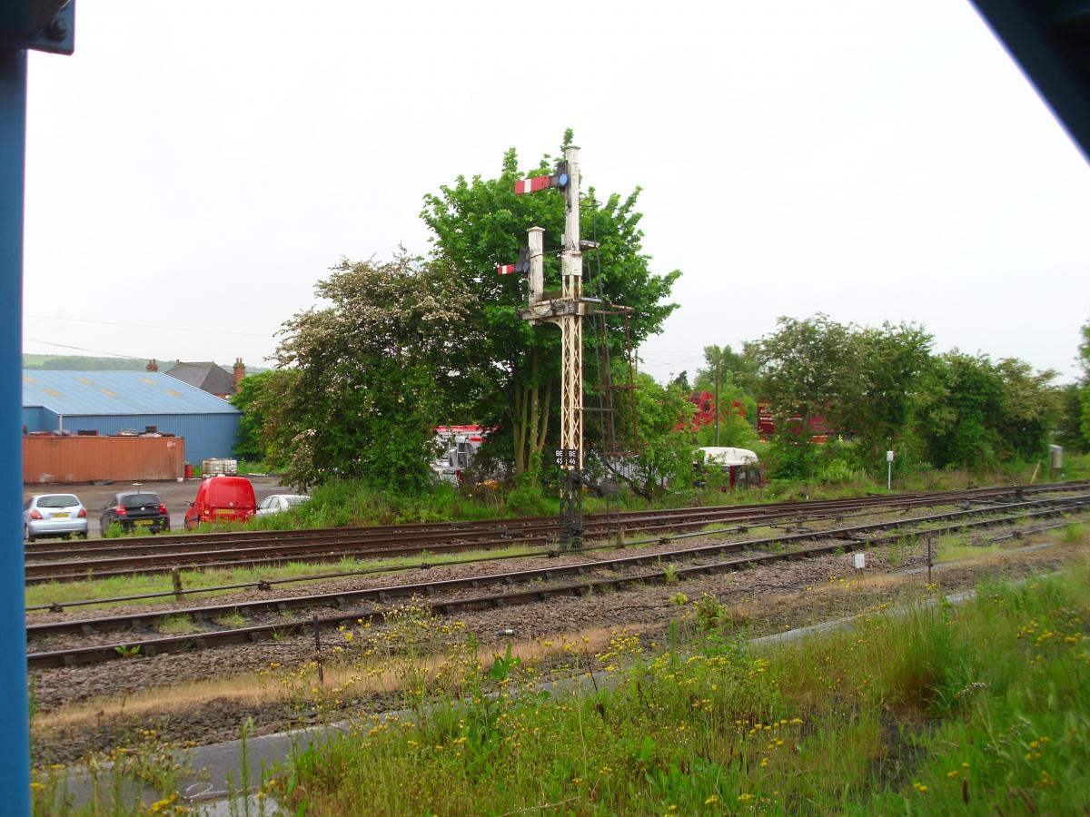

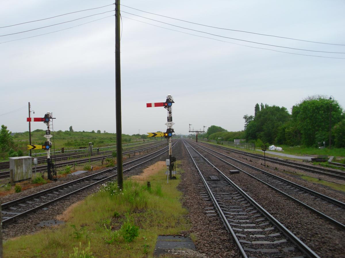

Anyway, here are some more pictures for you train pervs, as there are still a lot of semaphore signals in this neck of the woods...There are two manned signal boxes to go with them also, Wrawby junction and Barnetby East...

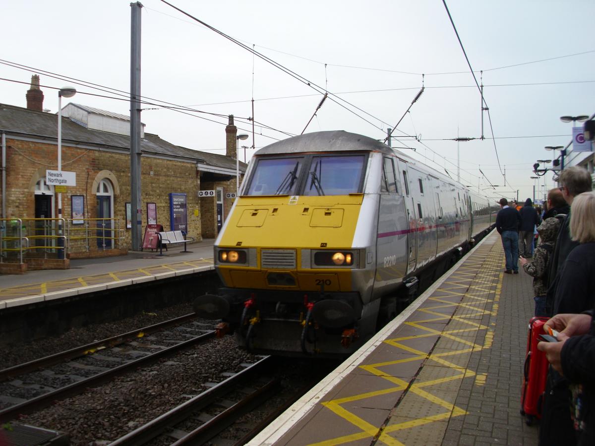

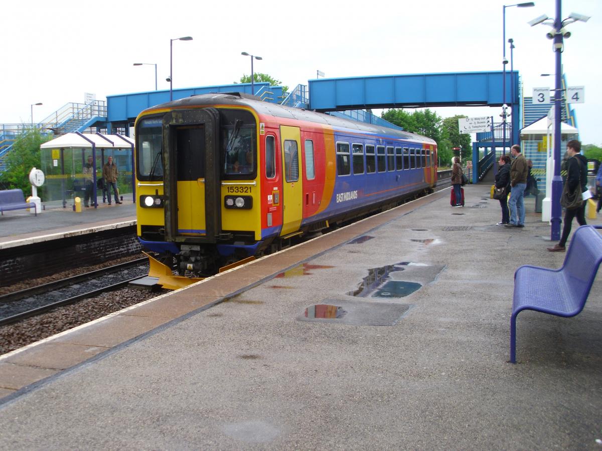

After about 15 minutes, this turned up to whisk me off to Newark Northgate...
Waited at Newark for 20 minutes...
until this arrived to take me to King's Cross...

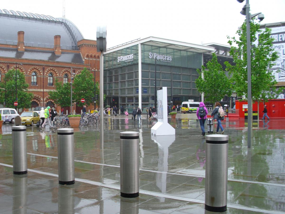

When I arrived at King's Cross I made my way over to St Pancras to catch another train to Gatwick Airport...

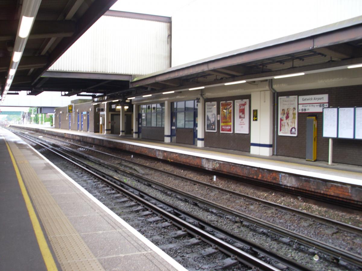

The train arrived on time...London was covered in mist and grey cloud...arrived at Gatwick Airport...

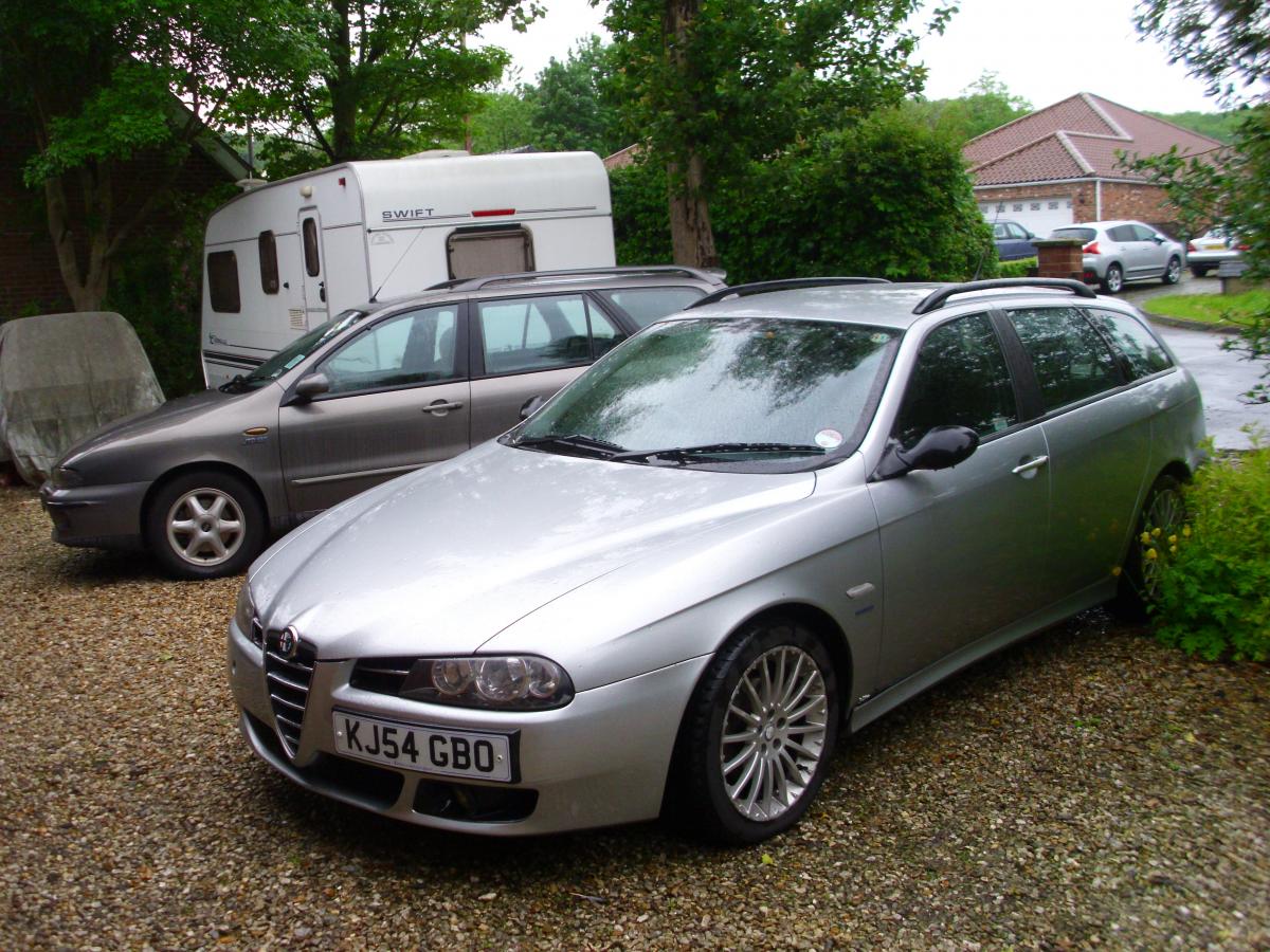

Home sweet home...

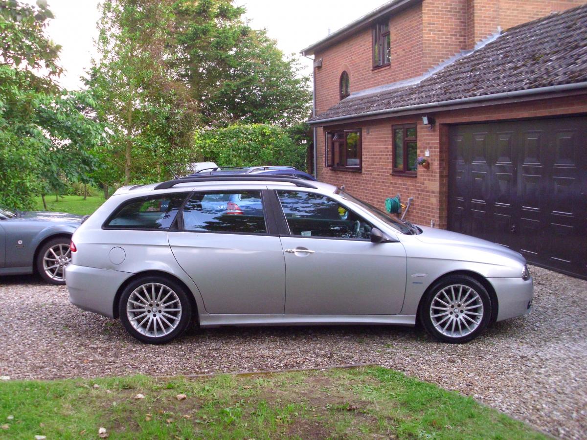

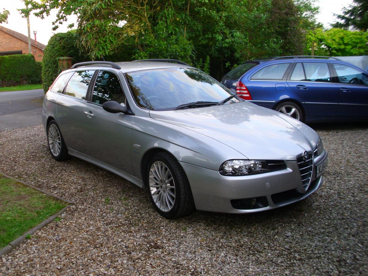

Right here is an update on this.
Basically it left me last weekend and is now in the Peak District with my sister.
But while I had it I gave it to a mate who runs a little Fiat & Alfa specialist repair place in Hull. He gave it a full service, checked out the EGR, all OK. Needed a radiator as it was missing about half of the fins. He also ended up putting a cambelt on as the timing was out by half a tooth as the locking tools didn't appear to have been used in the past. Needed a set of scrappy sourced headlights and some brake flexis for the MOT. It was now running lovely no soot or smoke anymore, spot on.
When I got it back I set to with the cosmetics. I replaced the Knackered rear wiper motor. I took the mirrors off sanded down the mounts and painted them satin black. Got a replacement drivers side sill skirt from E-bay as the one on the car was smashed. Took the passenger skirt off as it was OK but was coming away from the car. Put a pair of front seats in to replace the worn and torn originals. Went round it with touch up paint.
When I had it on stands to take the sill skirts off I cleaned it all up and covered it all in stonechip. I then refitted the skirts and then tiger sealed them at the top where it was originally fitted with tape.
I didn't take any photos unfortunately, but here are two from last weekend when my sis took it away. She left me with the Brava (it used to be mine...I ran it for 9 years) to dispose of. A few weeks ago I managed to get hold of another council lock up, so I have stashed it away on the basis it can be a spares source for the Marea...
Lovely looking car that.
