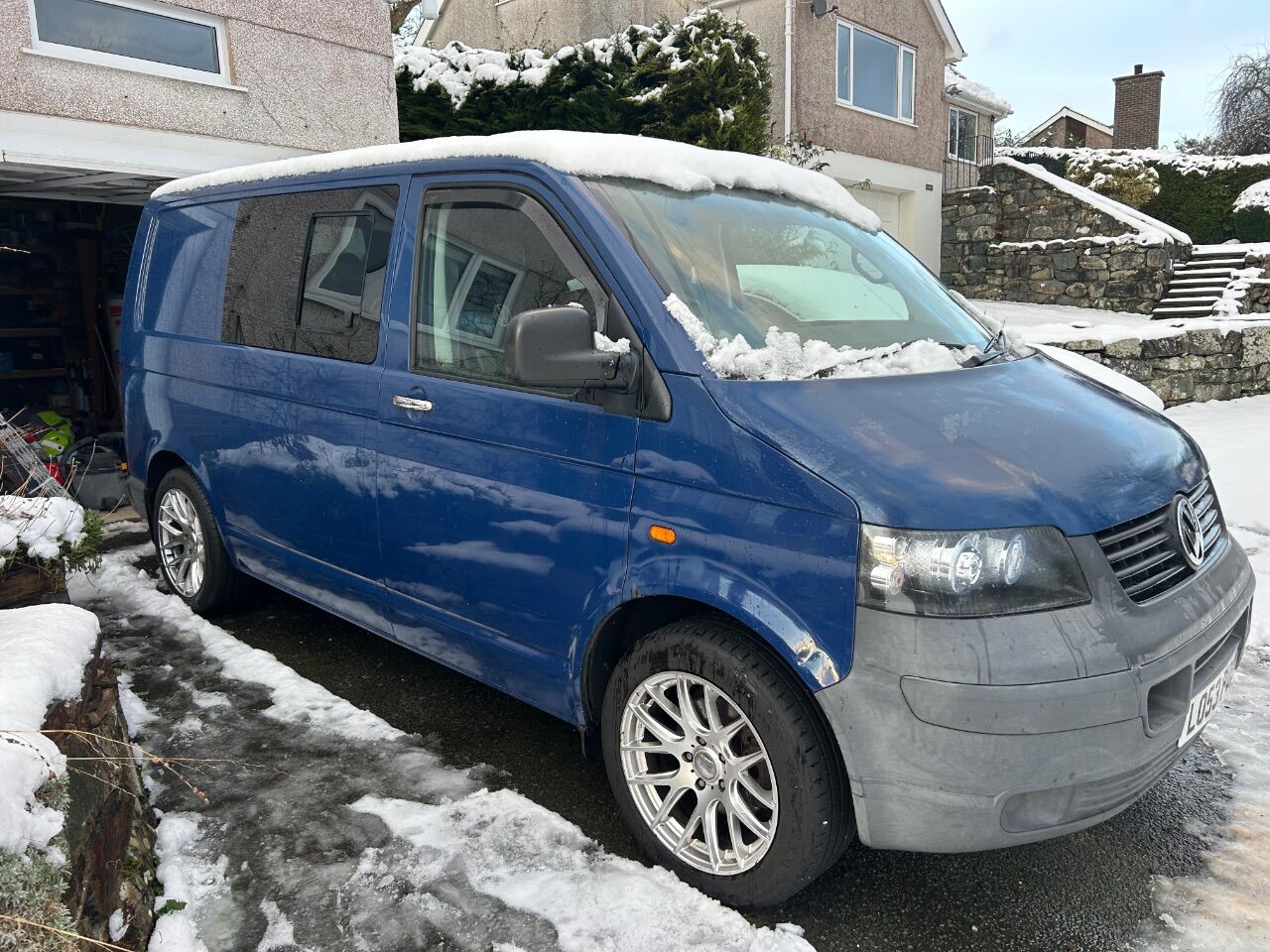

After getting fed up of threading mountain bikes into car boots decided to bite the bullet on a van… enter the cheapest MOTd T5 on gumtree… what could possibly go wrong?
After 305k the bodywork is a bit tired and the tailgate has a few rust blebs, but the pile of invoices from the last of two owners tells me it was well maintained over the 10 years he had it.
Interesting drive home  North Wales after collection…the previous owner had pointed out a few minor niggles, one being a weeping coolant pipe which necessitated several stops to replenish on the way home…  but made it eventually.
Pipe changed this morning and leak seems to have stopped (phew).   Noticed it was slow to warm up and gauge a bit variable so I’ll change the thermostat, doesn’t look too bad a job on the 1.9td.  Other jobs on the to do list include a new cable for the heat selector, stitching to a split on the rock n roll bed and some cosmetic tidying.
overall pretty chuffed after a good look over it and at sub £2k leaves me a pot for the inevitable repairs.  More importantly wife and dog approve!
