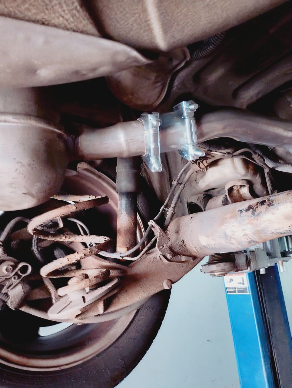

I'm now setting out my plans for *stick welding a new pipe [onto the Mazda box] and sorting a bracket to allow the box to sit on the two Vx rubber bobbins >> per standard.

Studied my back box, for reference to the Mazda fitting
Looks like we have space  >> both depth & width. Link pipe will be about a foot long.

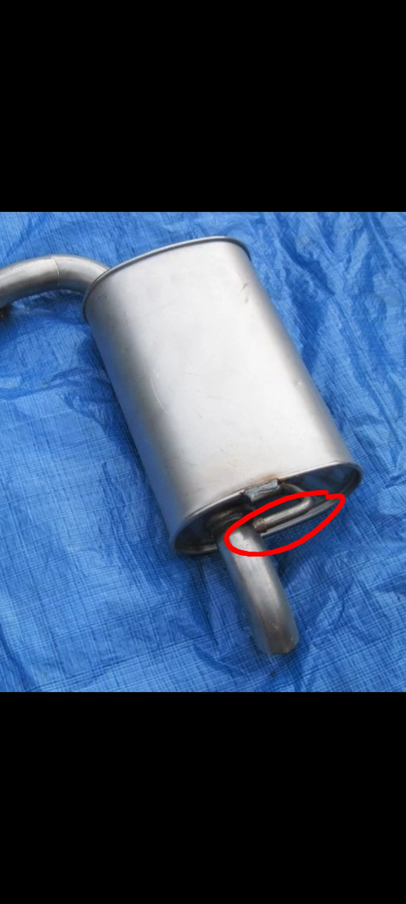

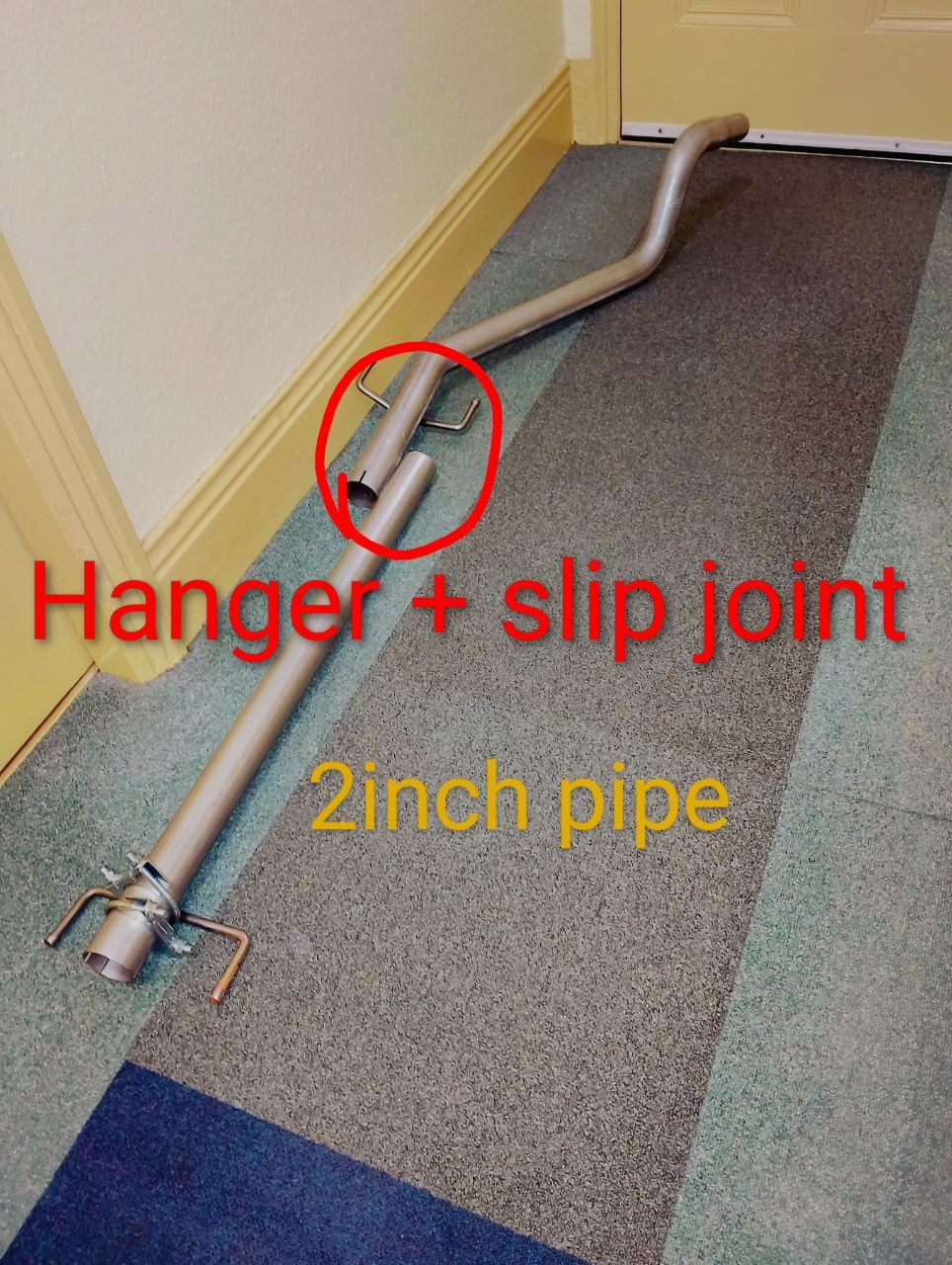

Re:.Back-box shenanigans 📏🛠️
I have this >>
.... at the top of pic you see the 'unused bit' of the car pipe [no good for Estate car]....
So I reckon just one more piece of 2", kinked a bit, will fix it all. Lobbed a cheeky offer 😁✔️

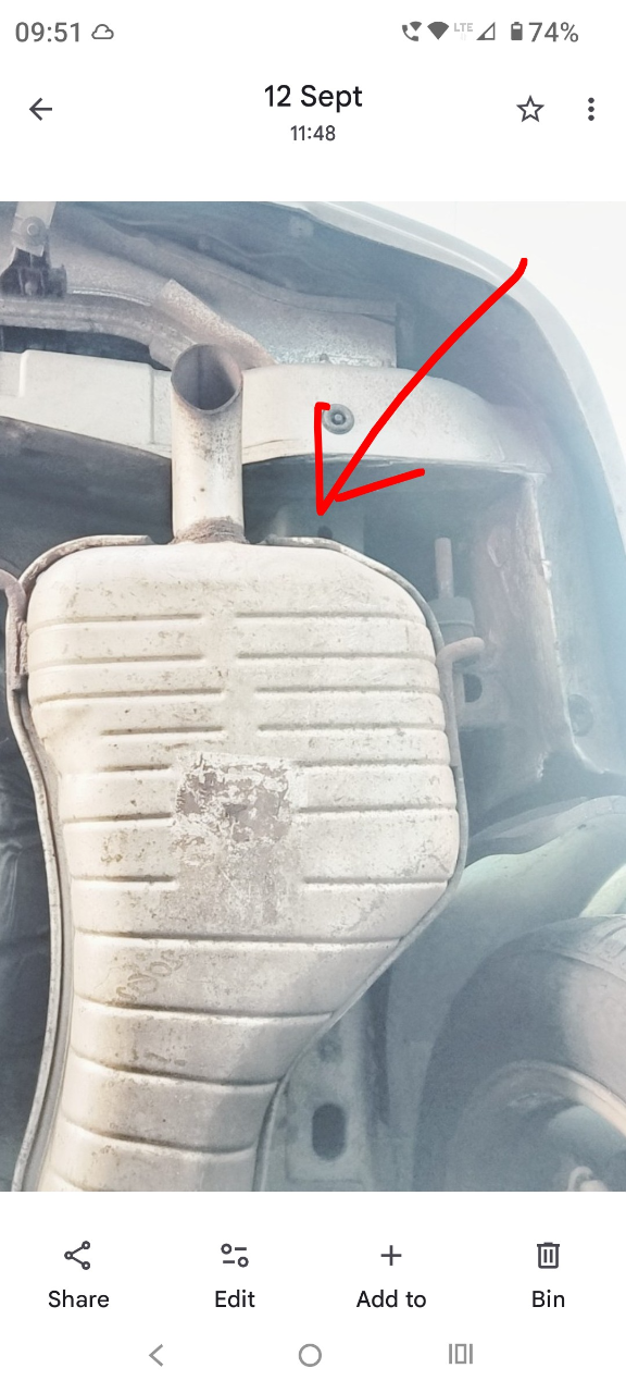

I have turned around my back box problem - the box not being suitable for the Vx bobbin mounts.
The box has a top-mount hanger fitted...
.... and (having checked space + clearance) the chassis above the back box has a preformed hole ....
I will fabb up a bracket, with a long bolt coming off at 90°, and the two bobbins....
.... will keep everything suspended ✔️👍
An elegant + simple solution.

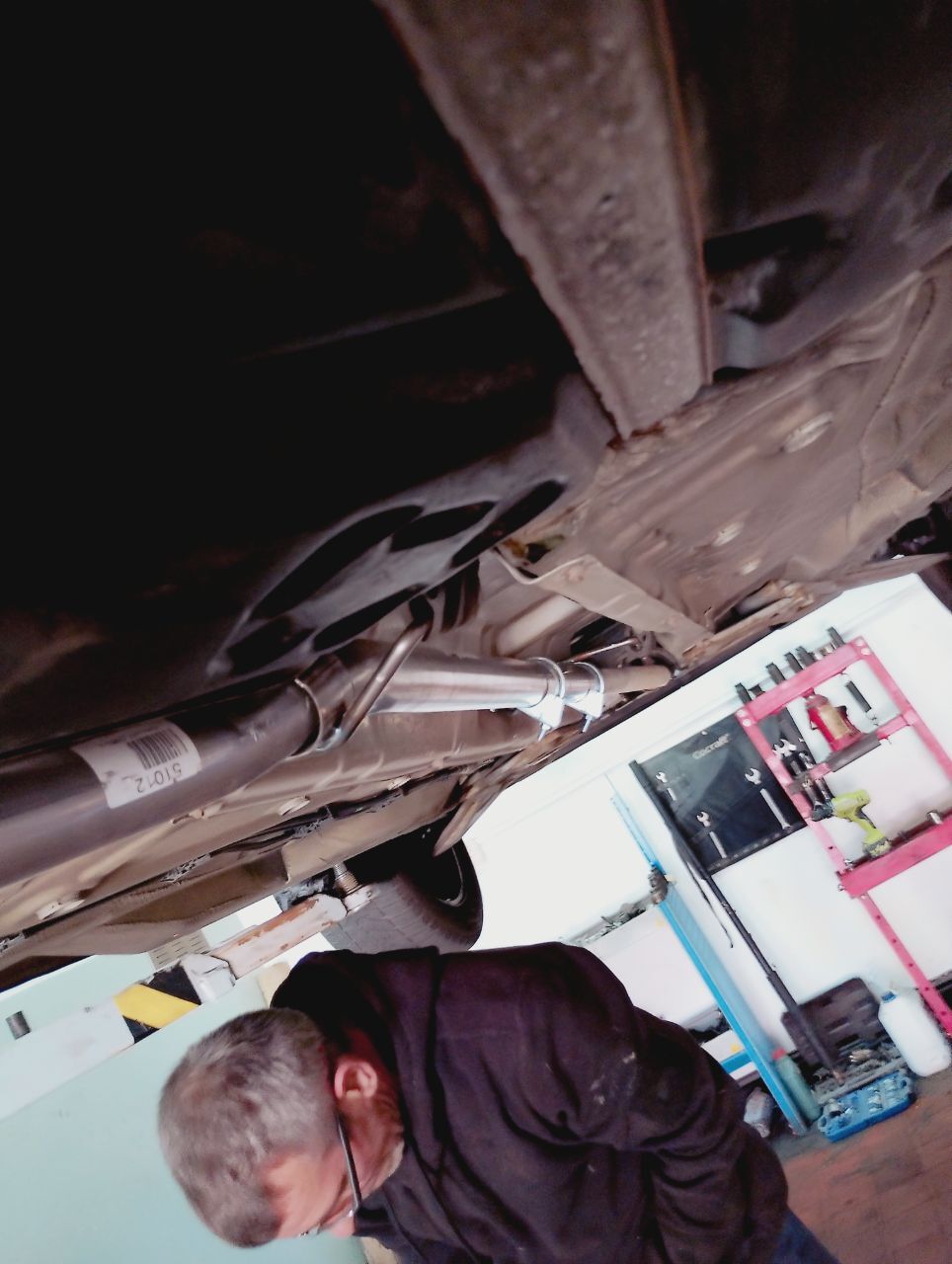

Using an axle stand I managed to stop the stock box landing on my head ✔️
Success with barrel nut + bracket attachment...
...... Insurmountable differences between the Vx pipe and the Mazda box 'orientation' = the 30° inter pipe is too much >> needed 15° 🙄.

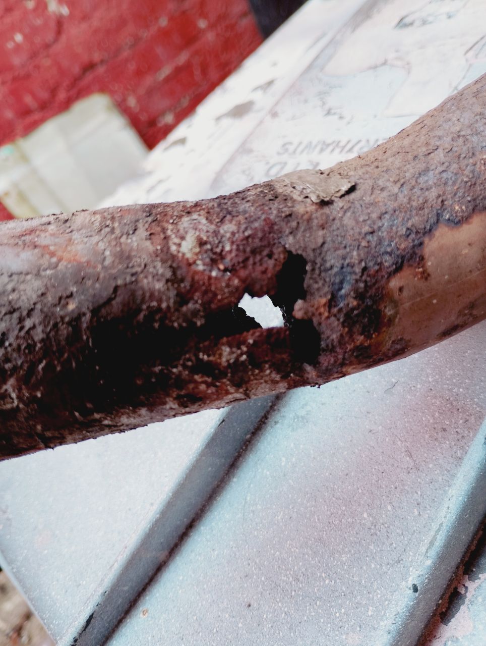

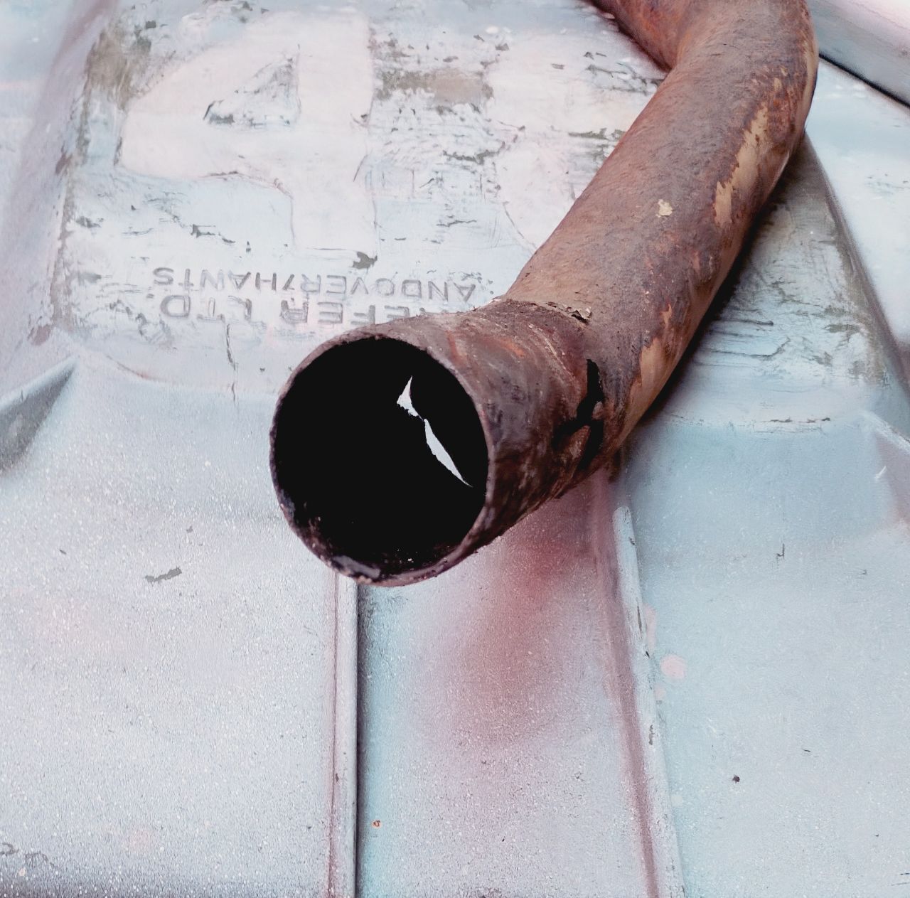

The reason for *attempted welding of back box pipe...
.... the stub I had clamped on was squashed out of shape and I couldn't get a pipe to insert.
Scrub that and *weld a nice sweet stub on 😵‍💫
I just lashed the Vx box back on with tywraps around the rubber bobbins (cut to remove).
Ahhh.... 😶‍🌫️
I will try it that way round next time....
#Homer 'Doh!'
