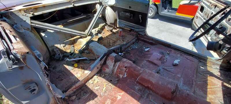

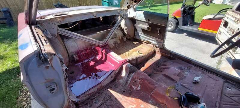

Decided to get back on doing stuff to the car. Least enjoyable- grinding. Emptied all the stuff out of the cabin.
Vacuumed all the trash out, leaves, dirt, bits of tarpaulin.

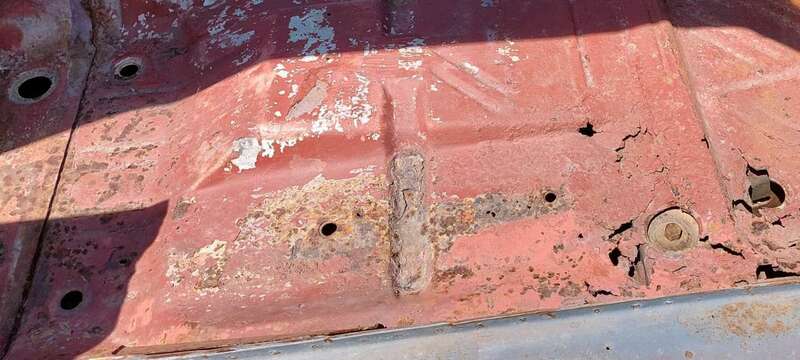

Decided I wanted to see what condition the rear floor is in.
Got this far with the grinder and it gave up the ghost. Put some paint on to protect the metal.
That's not too bad actually.ย
Now I just need a new angle grinder.
ย

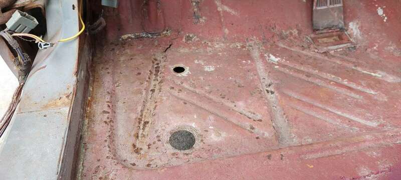

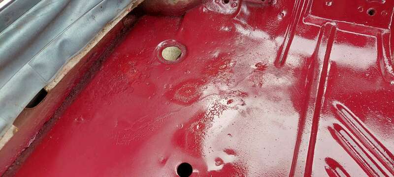

Drivers side rear footwell was less bad than I thought it would be.ย
Passenger side doesn't look as healthy.
Started in on the corner closest to the camera there, and it disintegrated.
Patch. Needs another one across the ribs there too.

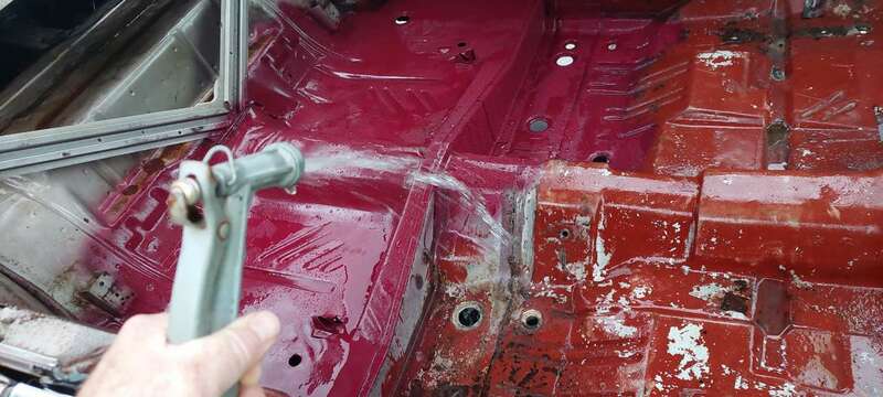

It pissed it down with rain.ย
Thus, it got washed out.
Quick and easy method of getting rid of all the grinding dust. Utilitarian.

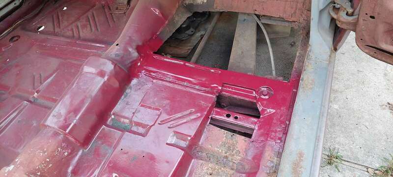

But that's the rear footwell done on the driver's side.

This side is a bit crusty. It's lost all shape due to the rust, so I made up a template based on the other side.
Fairly straightforward. I can get that cut out and welded in.
Oh yeah. I also got a bit heavy handed with the grinder...

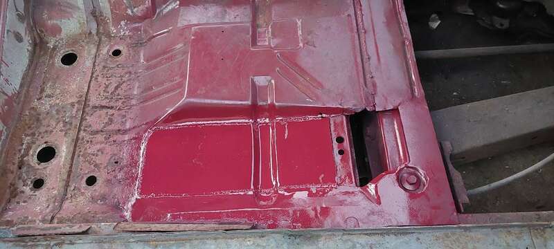

Made the flat cross section, with strengthening ribs and welded it in.
Looking at how to move on with the rest, and still get it mostly right. It's going to end up patchwork.

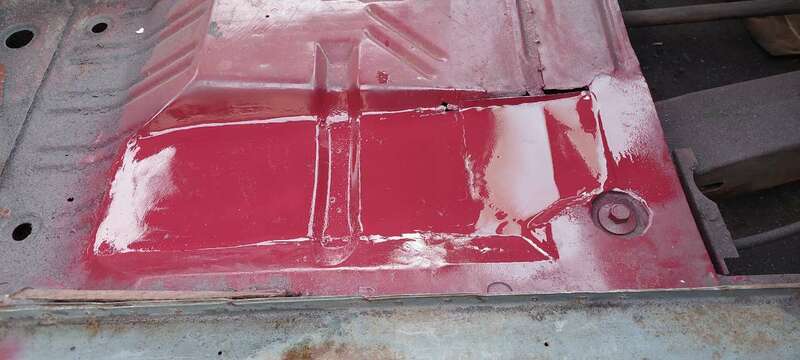

Old.
ย
New.
ย
Getting there slowly. Looks better, significantly less air in the floor now.
