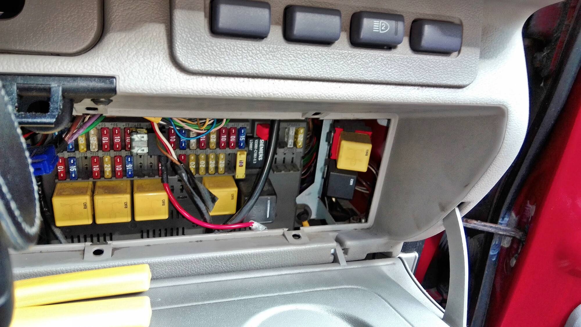

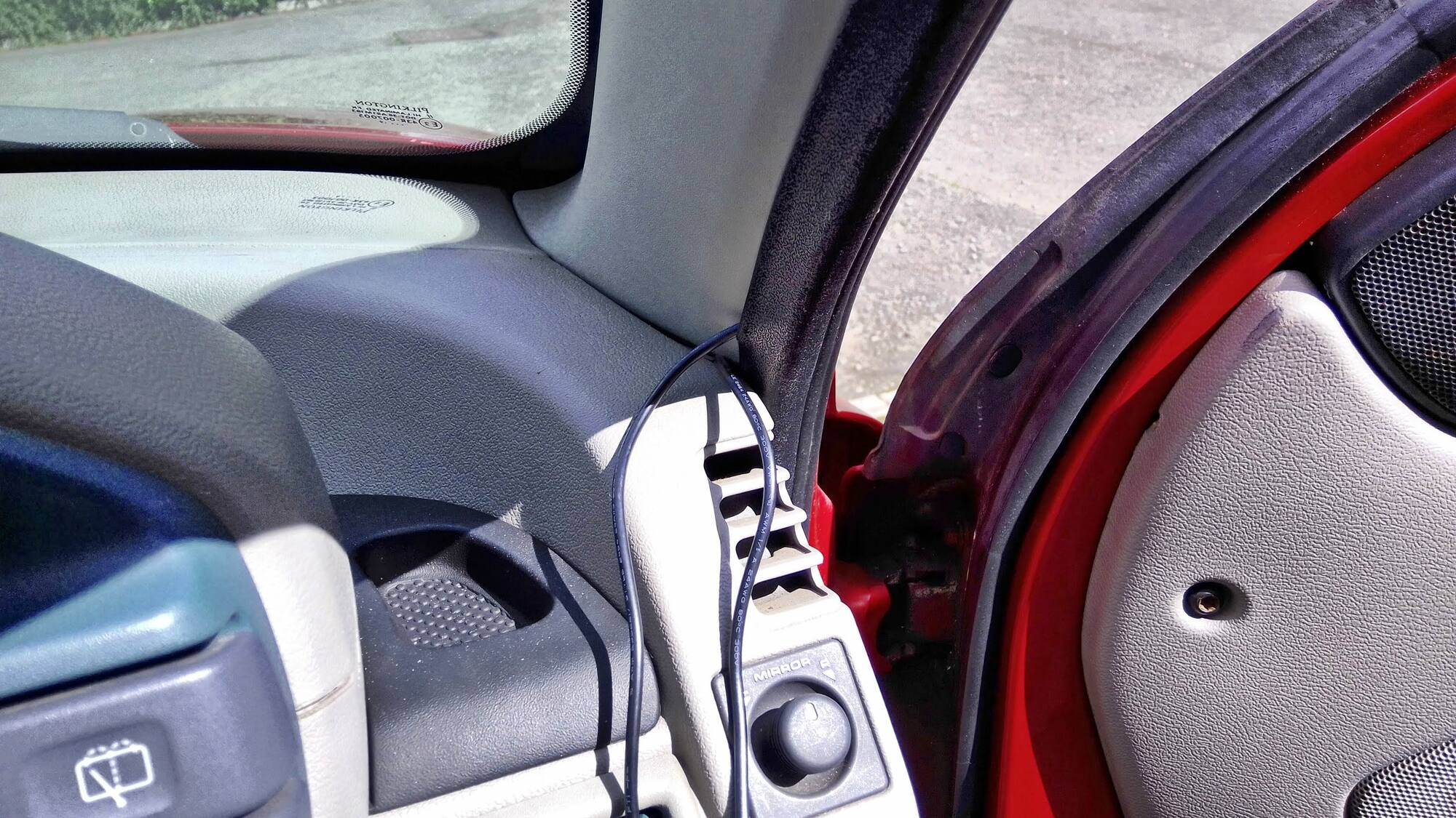

Spiny Norman Posted August 24, 2020 Author Posted August 24, 2020 Also hard wired the dashcam so I don't have power leads trailing up from the fag lighter to the top of the screen. I bought a kit a few years ago and it's been in every car I've had since. Again pretty easy, just piggy-back off a circuit that comes on with the ignition (I usually use said fag lighter, they've got extra capacity if all you ever use the socket for is a phone or satnav), find an earth, often the screw holding in the fusebox is a good place, and so it was in the Hippo, then tuck all the wiring out the way up inside the door seals, behind the dash (Thanks Land Rover for using such flimsy, bendable plastic for the dashboard, it was a doddle!) and tuck it under the headliner at the top of the screen. Fiddly, but I've done it often enough that it's another easy chore. privatewire 1
