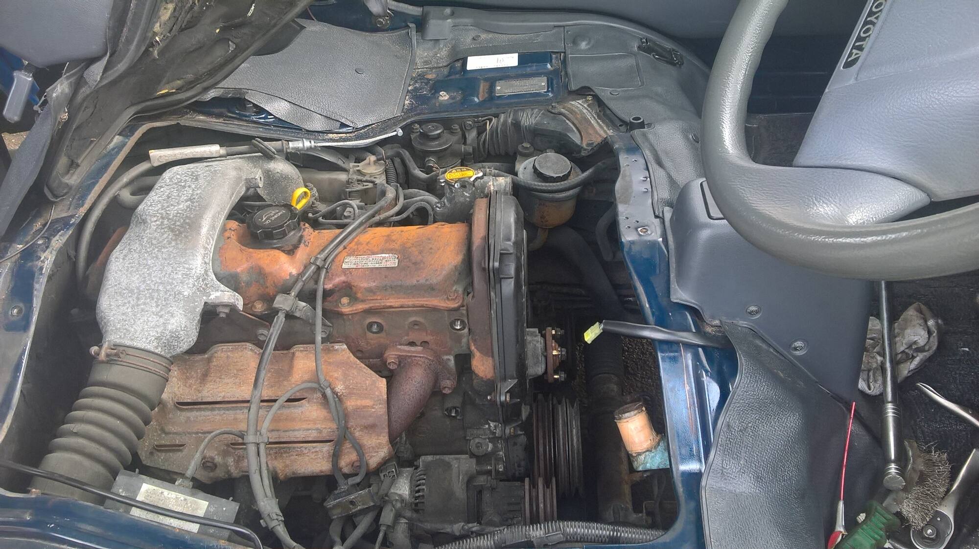

Gratuitous pic of some old Japanese iron, they do not make them like this anymore, etc....
Note the easy* access provided by simply removing the driver's seat/handbrake assembly/floorpan!  Left it at that following a short and successful test fire, will put it all back together after work tomorrow.
