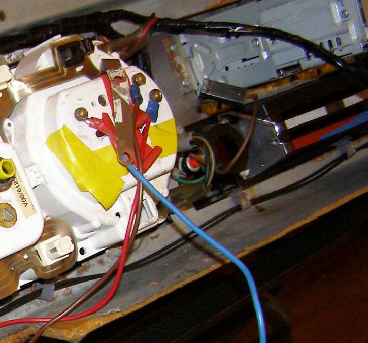

I think we need a diagram of how it's wired and pics of the tacho if poss - do you know if it's an RVI tacho? (it may be printed on the dial).
It's a Smiths tacho - standard fit in Allegro 1750. The red wire goes to coil, blue to ignition, brown to earth.
*The wiring has been tidied up since this 2015 photo.
