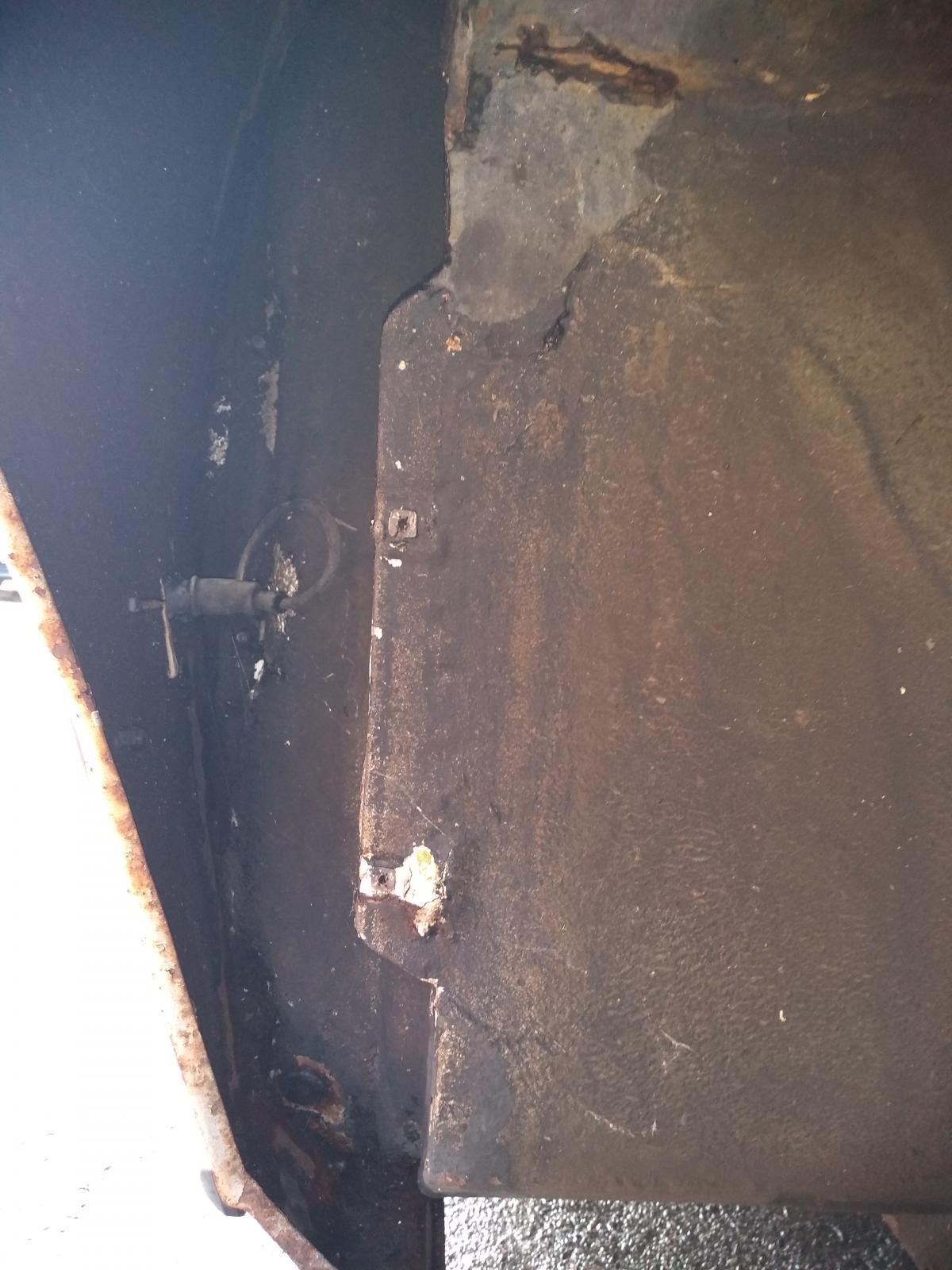

Tadhg Tiogar Posted September 1, 2018 Posted September 1, 2018 O/S/R: IMG_20180831_134530955.jpg...There used to be a vertical plate welded to the bottom of the well to shield the fuel tank. Mine fell off on the A41 one afternoon.... Crispian_J_Hotson 1
Crispian_J_Hotson Posted September 1, 2018 Author Posted September 1, 2018 This one most likely fell off in 1986. Dave_Q, michael t, DeeJay and 1 other 4

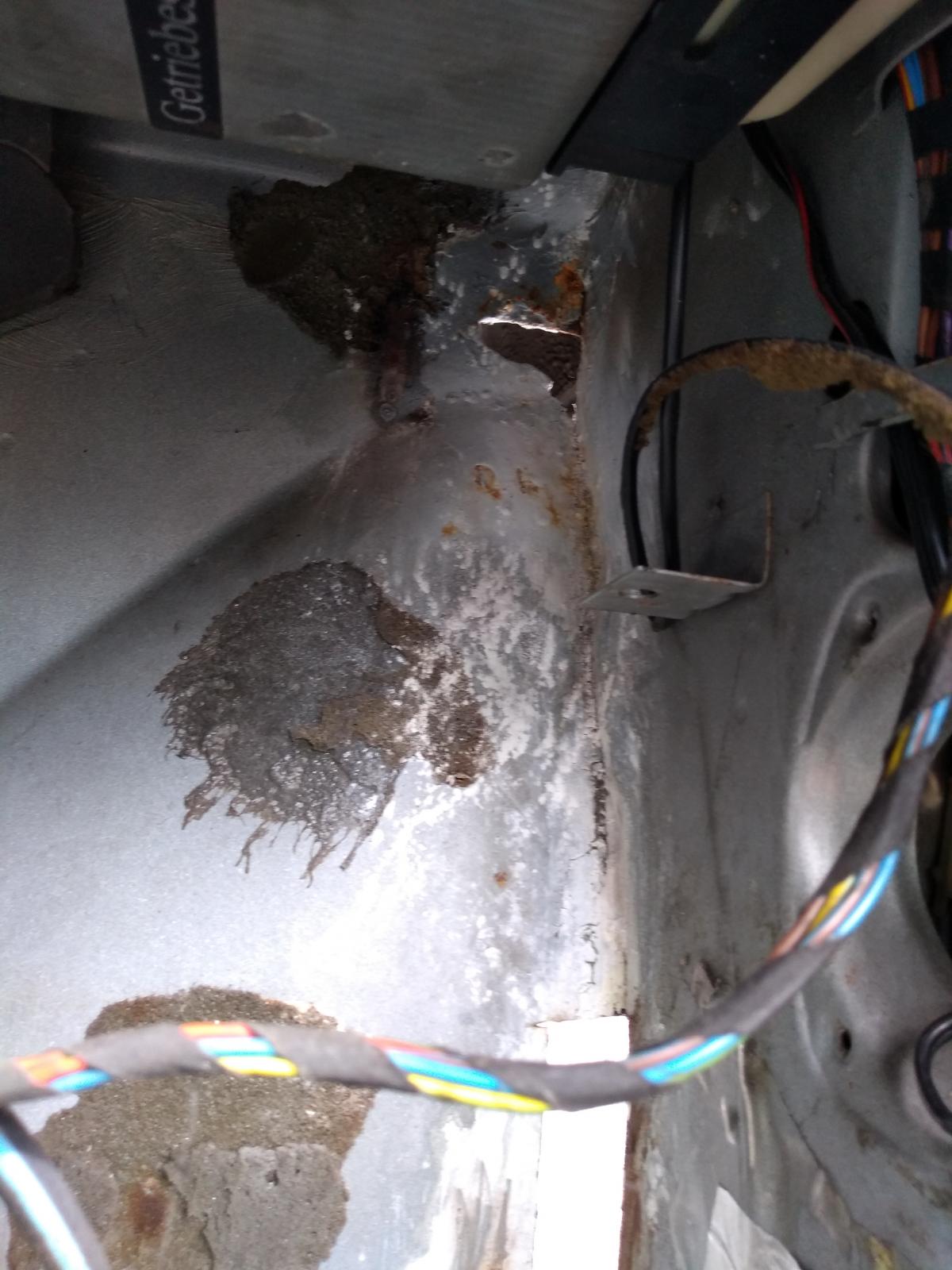

Crispian_J_Hotson Posted September 12, 2018 Author Posted September 12, 2018 La-de-da-de-daaaa.... Oh, I found the leak into the cabin... Which inevitably got bigger.... I wouldn't expect anything less. uk_senator, somewhatfoolish, Scruffy Bodger and 1 other 4
Tadhg Tiogar Posted September 12, 2018 Posted September 12, 2018 La-de-da-de-daaaa.... CanOfWorms.png Oh, I found the leak into the cabin... IMG_20180912_114823219.jpg IMG_20180912_114853744.jpg Which inevitably got bigger.... IMG_20180912_124011025.jpg I wouldn't expect anything less. If it's any consolation, mine had problems with the left footwell being damp whenever it rained or if I went through the car wash because the drain tube from the sunroof had failed.
Crispian_J_Hotson Posted September 12, 2018 Author Posted September 12, 2018 Well, that's the second one I need to look at. Let me guess... It was dripping from the dash/ side panel, the inside of the A pillar?
Tadhg Tiogar Posted September 12, 2018 Posted September 12, 2018 Well, that's the second one I need to look at. Let me guess... It was dripping from the dash/ side panel, the inside of the A pillar? That's what happened on mine. If it rains on the rear passenger seats, that means you've got a problem with the rear drain tubes. Or there's another hole in your roof skin.
