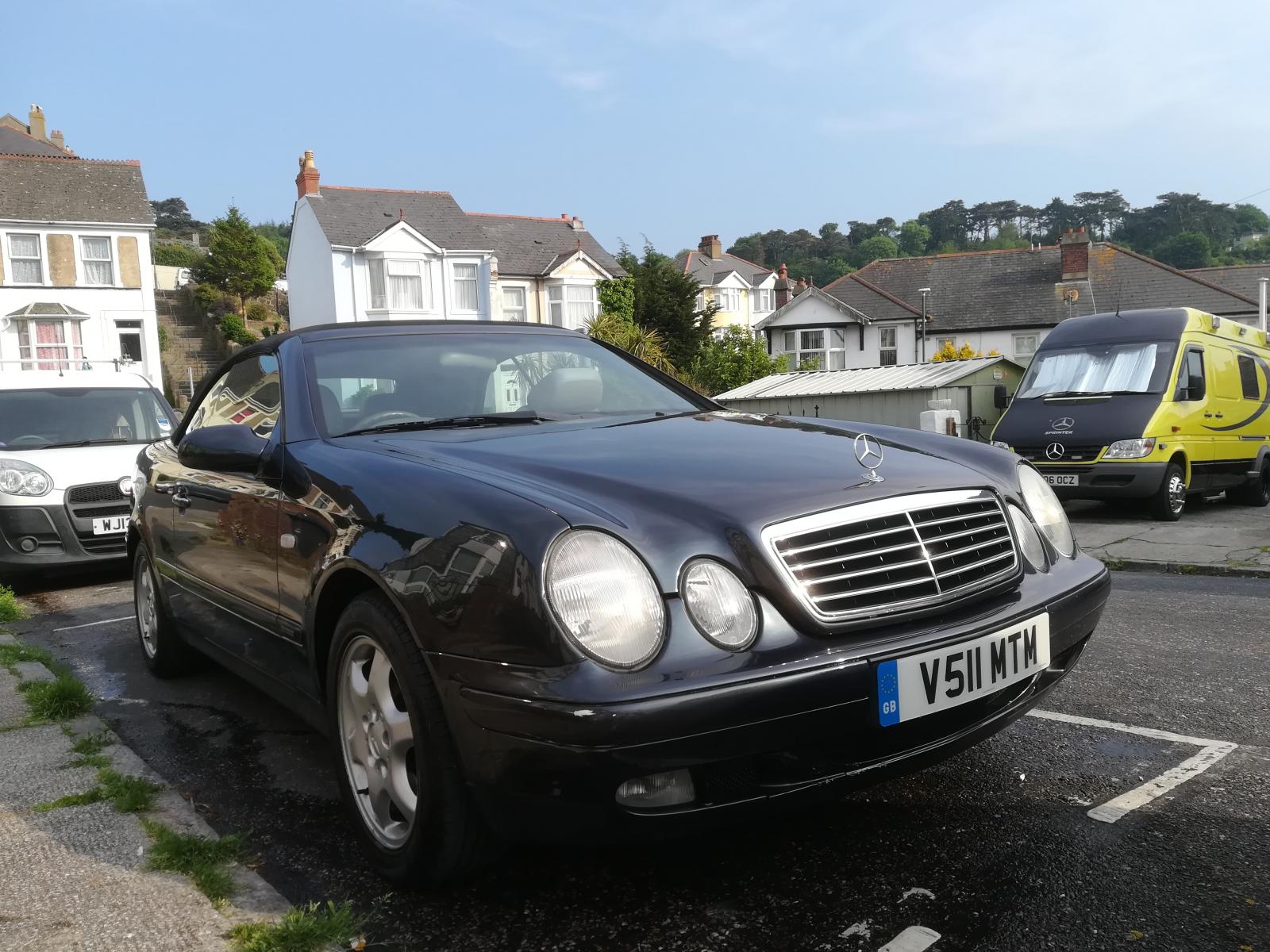

Mercedes CLK 320
I used to be really REALLY good at buying cars, I could spot a 'wrong un' at a thousand metres and knew within seconds if it was any cop or not. Now, I seem to buy any old shite with barely a glance, so I bought this Merc with loads of undisclosed (and undiscovered!) faults. What a prat I am.
Paid £1800 for it with a mew MOT and three new tyres, last owner for 14 years and always looked after but the history was lost (apart from all the original books which had a few early services in it) but, hey, the guy had it forever and he was in his 70s so a good buy, gotta be right?
To be fair, yes, it is. It drives really well, the engine has lots of poke, no smoke or nasty noises, brakes good (more on that later) suspension all good. Bit of rust around the arches but hey, it's slap bang in the middle of Mercs darkest times for rust so the fact that other than the blisters, it's sound everywhere is a bonus! Interior is good: leather (grey) and apart from wear on the drivers seat and one split seam, spot on. Roof in perfect order. Get it bought... so I did.
