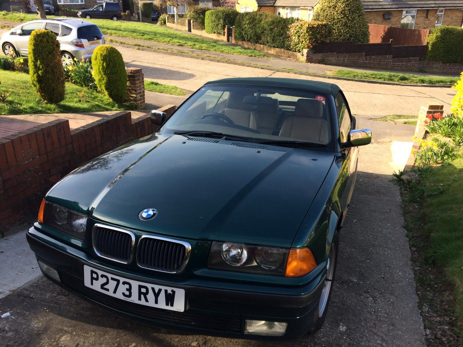

Vince70 Posted May 9, 2018 Posted May 9, 2018 I thought I would use the E36 cab the last couple of days after it’s been sitting around on the drive for the last 8 months and it started up lovely and runs nice.But driving for about 20 minutes on some fast roads (around 70mph) and then coming to a stop it will try and stall and the idle is around 400 rpm.I just wondered if anyone would know the answer before I take the engine apart for it never to go again.

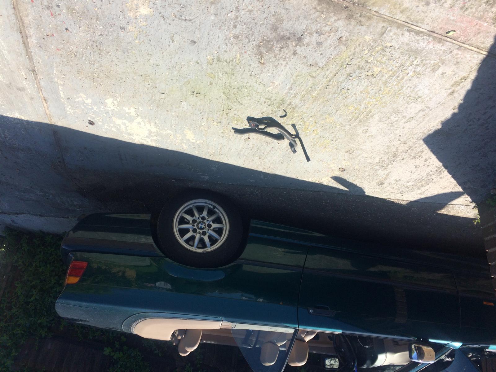

Vince70 Posted May 19, 2018 Author Posted May 19, 2018 Yesterday I fitted my new £8 (second hand) air flow meter and thought I had cracked the problem when it was sitting at around 850 rpm and was most pleased with myself then I went for a drive and the problem came back so I Bought a new CCV valve as it’s on its 22 year old original hoping that might help the problem and it’s due next week sometime. But then I saw the problem and it was plain as day as a breather pipe (the expensive smaller one) from the fuel rail to the airmass boot had a big split in it and when I put my hand over the split the car ticked over lovely. I might try BMW for the part as I’ve found sometimes they are cheaper than eBay and the dealership which is about 15 miles away drops the parts off for free which is nice of them. I’m blaming it on being vain and not wearing my glasses for not seeing the inch long split in the pipe and it looks a bit of a shite to change though as it looks like lots of parts need to be removed to get to it as I think it runs under the intake manifold. I might change the back breathers while I have the thing apart as they don’t look much better. I wouldn’t mind but it’s not my car anymore and my father wishes to sell it as he has trouble getting in and out the thing and it just doesn’t get used But I could buy it back if I wanted but I already have 3 cars but it’s completely rust free and original with low miles and I know I wouldn’t be able to get another. On a brighter note though I cured the slight coolant leak which I was told was a bottom hose by buying a new febi expansion tank and cap while at it I gave the car a coolant change so it has some lovely blue coolant again which is a bonus. binbag 1

Vince70 Posted June 3, 2018 Author Posted June 3, 2018 Today I managed to fix the idle problem and I also fitted a new ccv while at it and it’s now running lovely again thanks for the help.Also it got its new aerial base fitted and I also managed to fit a new base on the Z3 as well this weekend and put a new thermostat and housing on the Ti.I was going to wash the cars as well but that can now wait for another day.Plus it got a nice JVC Iphone stereo fitted which doesn’t look over the top and it only cost £28 rather than about £80 as it was ex demo.And having a roof that works off the remote makes me a right poser down the seafront. Jim Bell 1
