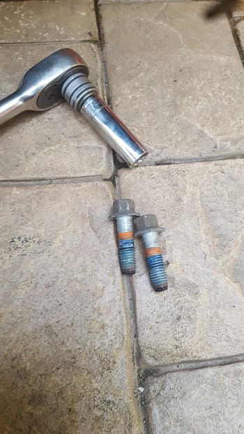

Removed caliper and carrier. Held on by nasty small headed bolts.......

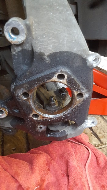

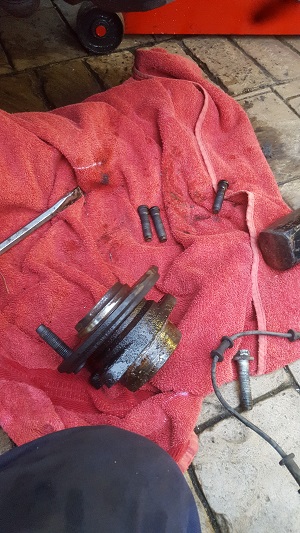

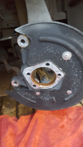

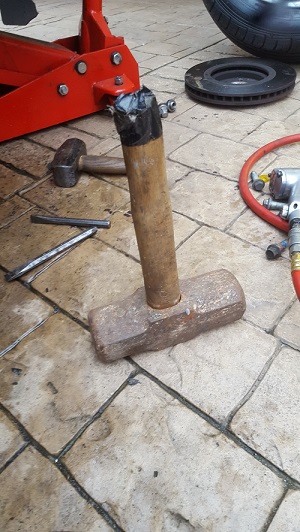

I then undid the bolts holding the hub on...........to find it was solid. Belted fuck out of it......nothing.
So got bigger hammer......and a bit of heat
Success

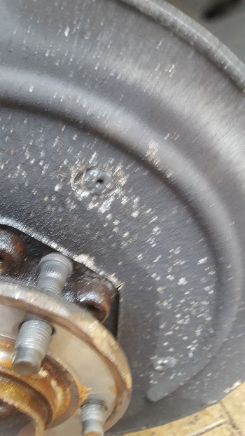

Reassembly was a reversal of the removal procedure...........and because it had taken me nearly and hour and a fucking half to do I didn't take any pics apart from this. And then only because I nearly forgot to put it on. It was held on with pop rivets! Bloody Yank build quality right there. Spent a bit of time cleaning the mating face of the disc in case it didn't sit in exactly the same place.

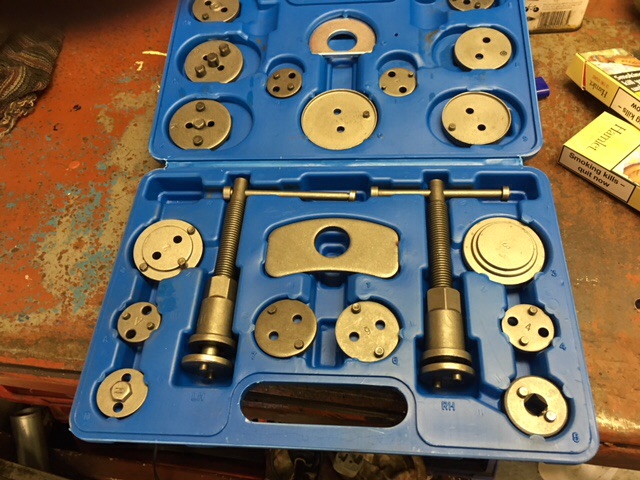

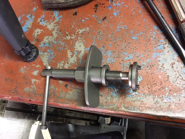

I bought this on Amazon for 17 quid.......I've avoided buying one for years but this time I just wanted to avoid the faff.
Great bit of kit in fact....the shaft is magnetic so hold the adaptor head nicely
Easy enough to get apart.....I've had my money's worth out of the inner pad at least but no meaningful damage to disc so it is just getting pads.

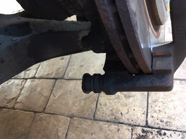

Put it all back together and moved onto the other side. This turned out to be a bugger.....guide pins were solid so I took the carrier off before something nasty happened. No pics at this point because got Anger. Carrier bolts also very very tight...thought one was going to shear. Much easier to sort guide pins on bench though.
