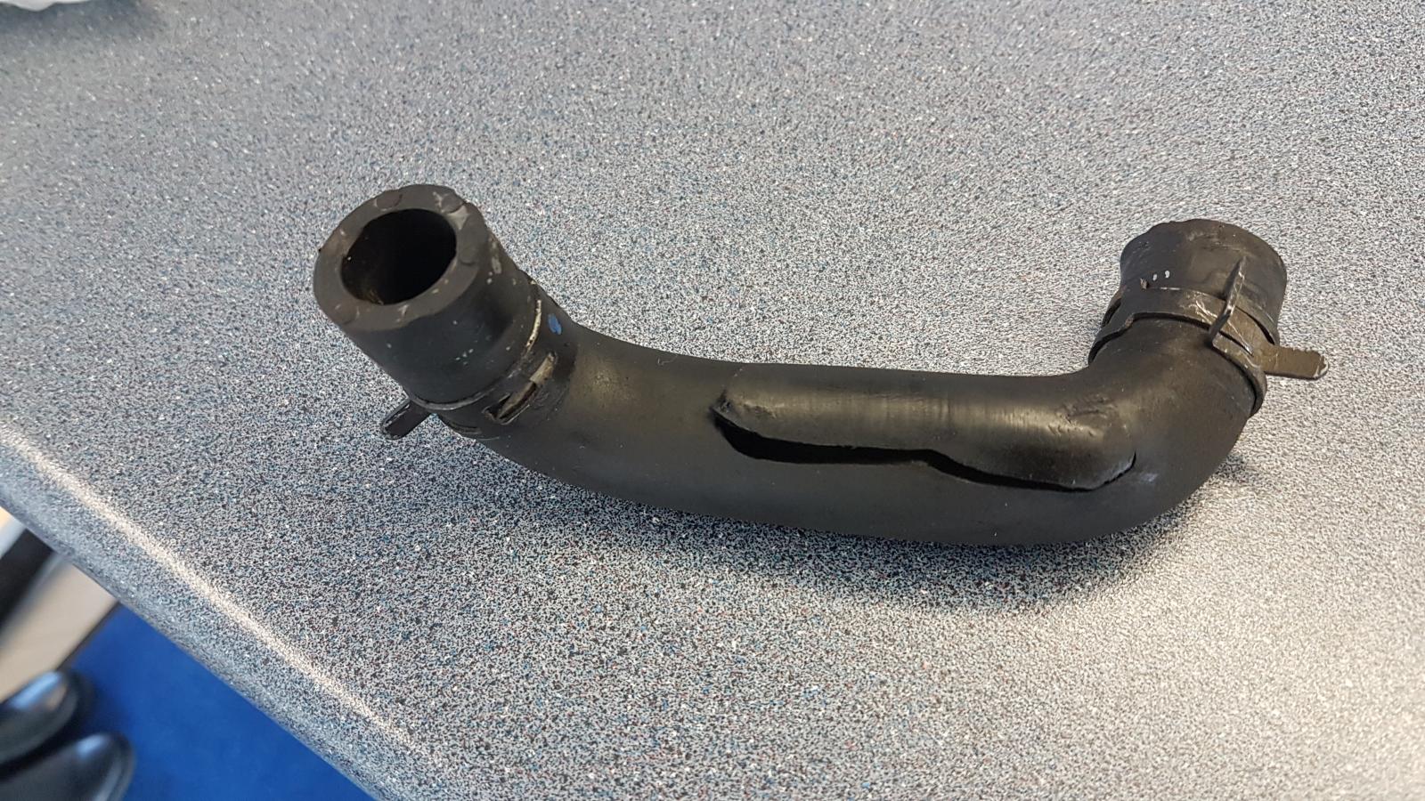

Ford dealers have rung. It does have a split intake breather pipe and replacing it should* fix the problems.
£40 for a new one. Fitting no idea, an hour or two max. They've never done one before so not sure. Cost maximum £200.
I'd say no and do it myself but the inlet manifold is plastic and half of its buried being the plastic slam panel. I don't want to take half the front of the car off. Mrs Shrimp would not be happy as it'd take me ages and she wants to take it on holiday next week. Better to pay...

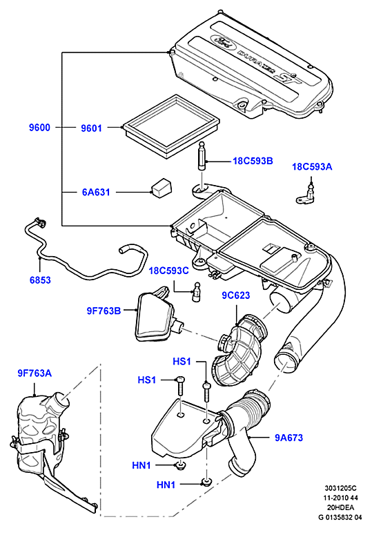

Sounds positive, I'm trying to work out which pipe it is....none of these?
Sadly none of them it's one on the back of the inlet manifold.

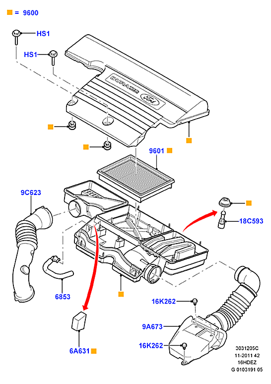

Where did you get that picture though? I must be really crap at searching as I could find next to sod all.
Edit: that's not the air filter housing on the Mk6 ST.
Very useful site (why couldn't I find it??) anyway I think it'll be part 6853 looked like it's got a plastic plug on one end.
If it is then it's near impossible to get to. Still not my problem now but will definitely be ordering a spare.
I couldn't find that part on eBay, maybe start with fordpartsuk.com, but as their postage is ridiculous, you may be better getting a spare straight from the dealer.
No neither can I... The guy that breaks them has some. It's taken about 10 year to fail so I think I'll just get one or two spare from him just in case.
I notice the breather pipe in both pics is 6853 yet totally different. And we wonder why the wrong parts get ordered for cars...
A split pipe there would make sense, it'd cause a massive air leak after the throttle body.
Might be worth getting that little crankcase filter changed as well if it hasn't been done. 6a631 above...
6A631 small sprung filter has turned to mush. I left what was left of it in, but the guy in the garage says it does sod all and they normally don't replace them.

Just been rung by the Ford dealers. Breather hose changed and car working all ok!
Bloke says the guy from ebay knowing about the pipe splitting has saved tons of work. Took an hour so £118 total.
Going to pick it up soon. Will have to see if it's back 100%.
ST picked up, all back to normal.
They saved the damaged hose

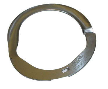

January 1st was fun as the ST decided it no longer wanted its nsf spring just as it was being taken to work. Made a very lovely bang and stopped in the middle of the road just outside the house.
With scrapping sounds abound it was moved to the side of the road damage unknown as it was dark and I could only just get my hand in.
Next day it was taken the the main dealers, by the AA via Ford assist, who said there was exactly sod all extra damage and they supplied both front springs (thought it best to get both) for about £200ish.

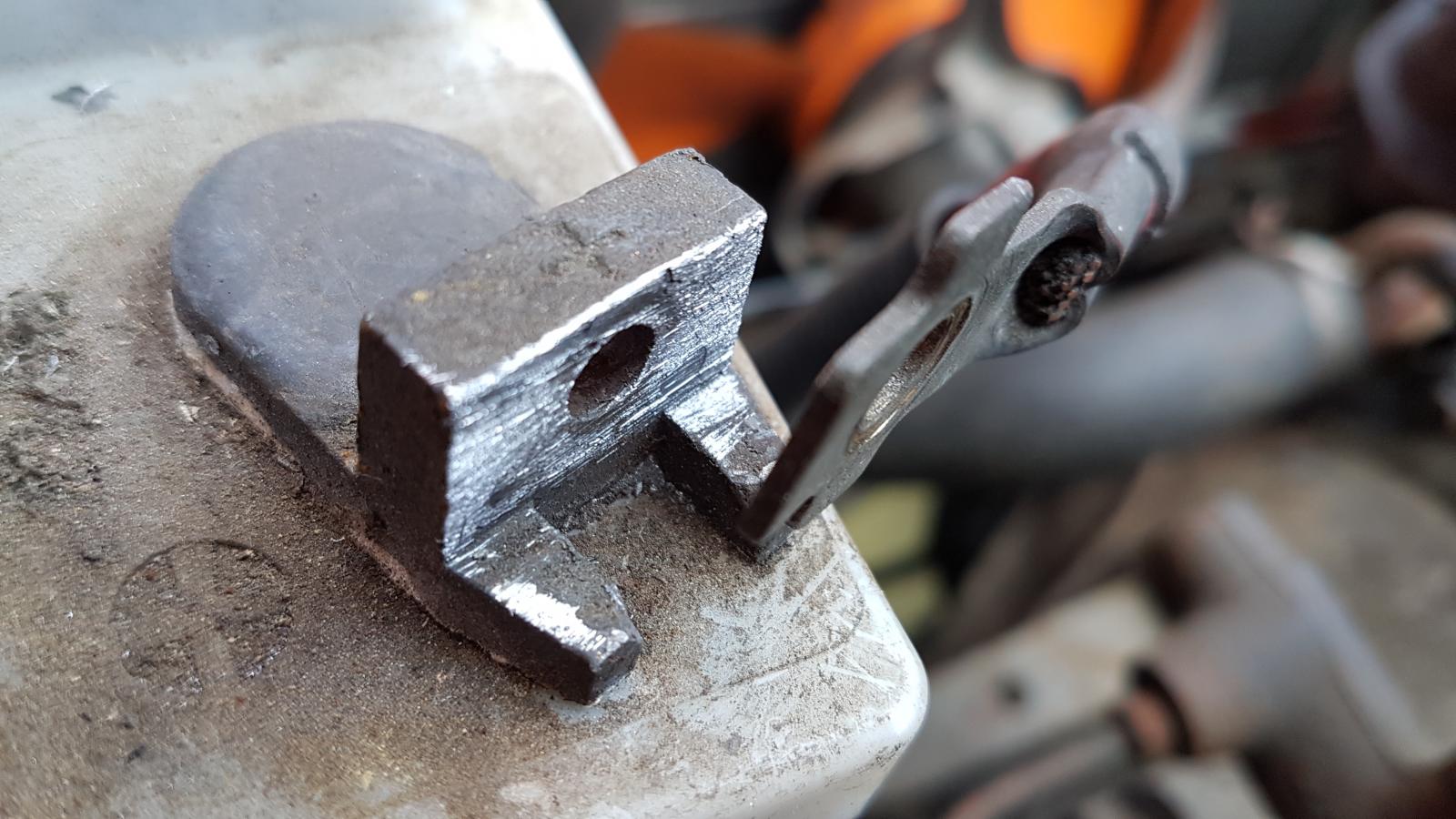

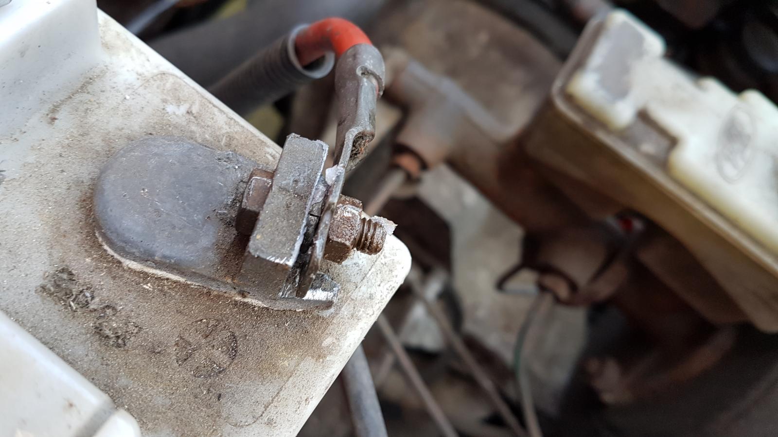

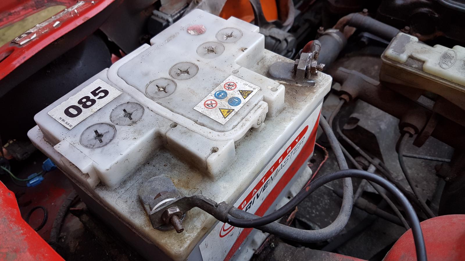

As has been documented in another thread last week the Mk2 Fiesta wouldn't start when I was in a car park in town.
Retightening the nuts on the battery to super tight made it start just as the recovery truck turned up. It's started every time since then.
Today though it's not been raining so I finally managed a whole 15 minutes to mess with it.
So following advice each contact was taken off and given a rub down.
Did the lead as well and both got a light coating of vasaline.
Two random washers were found in the street and I tightened it so much that the spring washer flattened out
Both sides done and it started first time
Will this fix it? Who knows but better than nothing.
