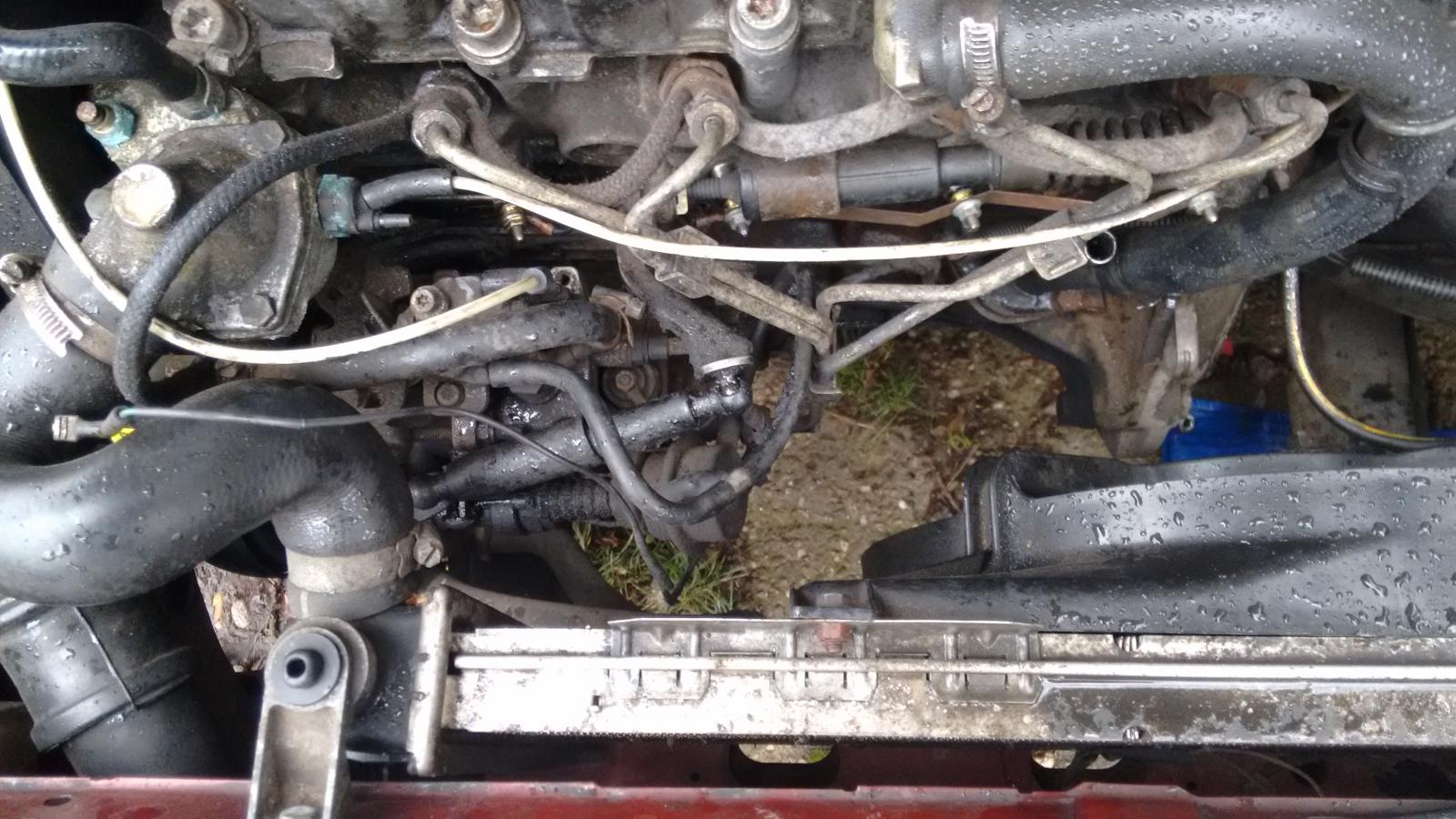

I decided to change the glow plugs on my 1993 Astra 1.7D today.  Nice easy job i thought.  It went well until the last glow plug which had very limited access.  Eventually managed to get that one done too.  Only thing is that in my haste to connect everything back up i had a long wire left over with a spade connector at the end.  I can't for the life of me see where this came from.  I decided to try starting it anyway,  Needless to say it didn't want to only managing to fire after much turning of the starter motor so all i have managed to do is make it worse!  It then started raining and became very windy so i retreated to the house.  Can anyone advise where this should go?  It's the longest wire at the end of the glow plug wiring shown on the left of the photo.

Also isnt there supposed to be 2 vac pipes on the unit on the side of the tstat hsg . Iirc its the cold start device
Thanks for your help. The photo does show a vacuum pipe missing from the thermostat housing but that was removed to give me better access to one of the glowplugs and it was replaced.
I've reconnected the spade connector to the top of the thermostat housing. It now starts with the usual 5 illuminations of the glow plug light so I think it's the same as it was. The glow plugs I removed didn't look that old so I think the previous owner must have changed them too. It does always start eventially just wanted to improve it. Seems like the glow plugs themselves aren't at fault. I read there's a timer for them so maybe it's that but I might leave it alone for a while!
