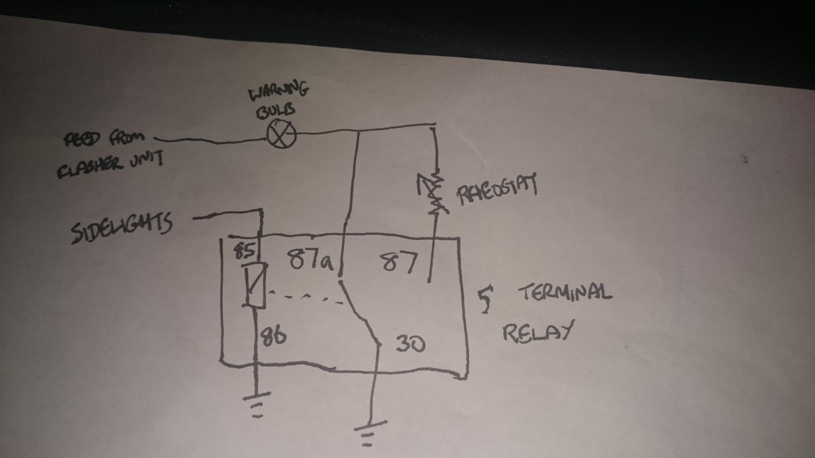

I'll sketch somethingCitroens. ght - the resistor value will depend on the bulb so if you give me details of the fitting I'll check that out; I have a slight obsession with things that light up...
Probably the best option would be to raid a rheostat from a scrapyard instead of a fixed resistor, as that will be of the right sort of resistance range and can be tailored to suit the right low brightness level.
Sorted. Why didn't I think of that? I've got a variable resister from a GS Citroens that will be perfect. Thank you.
Here you go; personally I'd cut into the earth side of the wiring for the warning bulb but it doesn't matter really.
attachicon.gifDSC_57591.J
Cheers, I could do that, just couldn't think of doing it!
