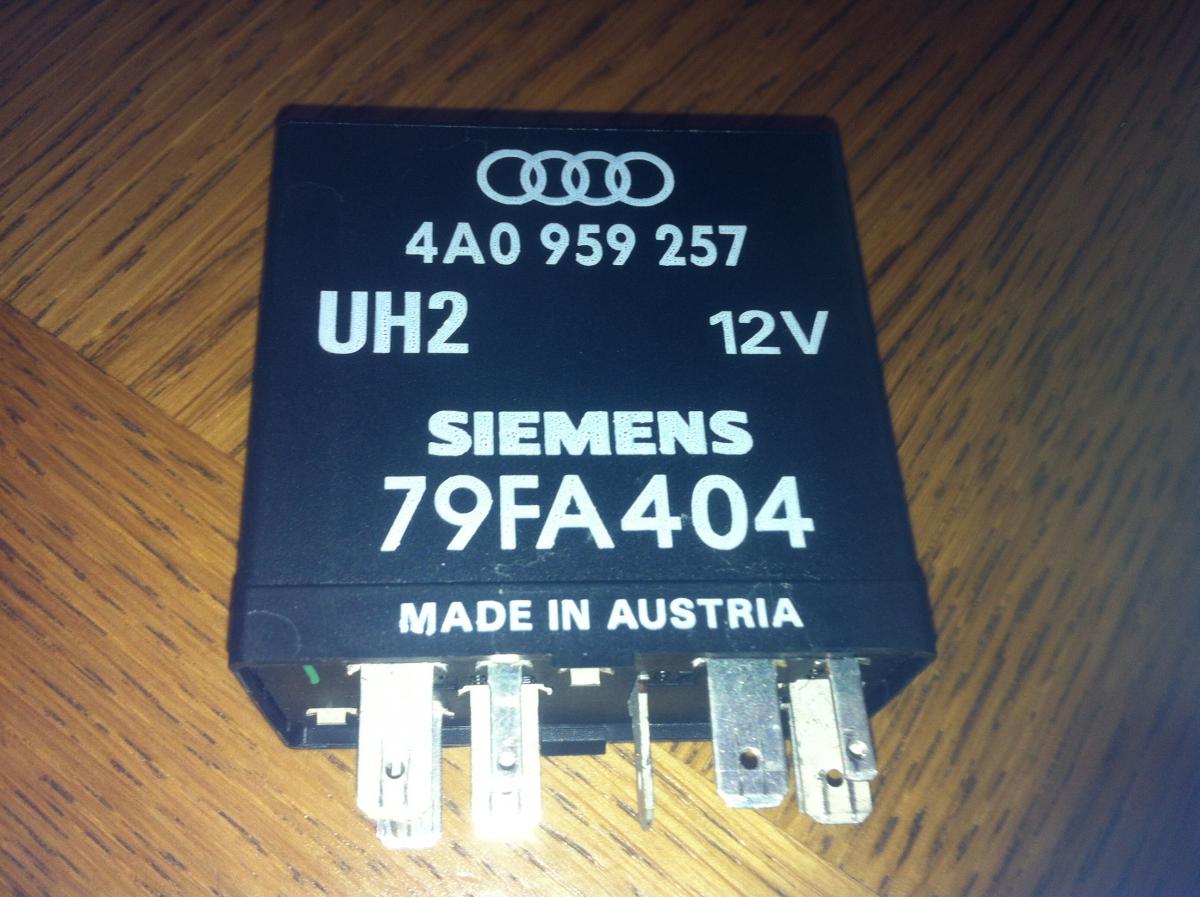

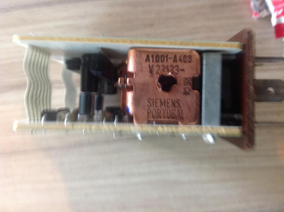

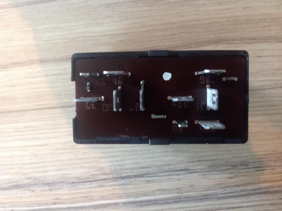

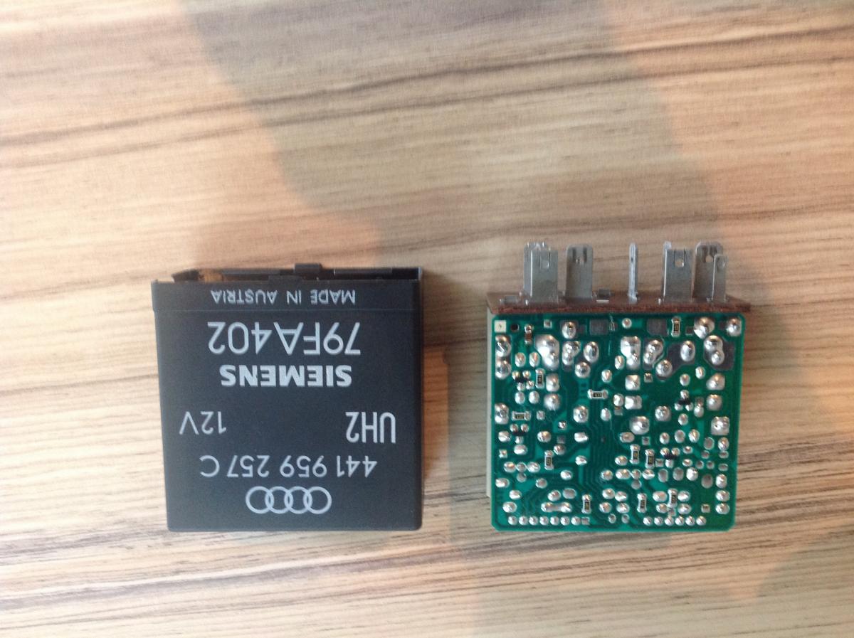

Vince70 Posted March 15, 2014 Posted March 15, 2014 I'm looking for a bit of advice really I've got a knackered relay on my Audi Cabriolet (common fault apparently) so my drivers window won't work, so I've been looking on eBay and there going for silly money.. There's one I've found off an Audi Saloon which the pins match perfectly but with a different serial number and different numbers on the pins. I'm not to worried if I loose automatic closing on a touch of a button as I find that a pain anyway but would it be worth a gamble as it looks like complex bit of kit as you can see with it opened up.

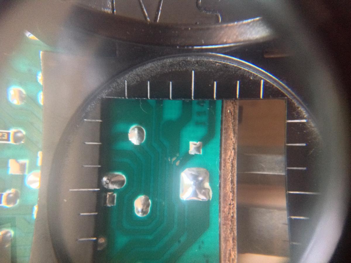

brickwall Posted March 15, 2014 Posted March 15, 2014 Have you checked all the solder - common problem? He says 50% of the time it's an obvious bit of solder The con is the double plug Vince70 1
Vince70 Posted March 15, 2014 Author Posted March 15, 2014 Thanks Brickwall that's very kind of you.That's the problem it does all 4 windows but although the other relay has the same pins it's out of a saloon which only has front electric windows so I don't know if it will work plus my old casing will have to be used.

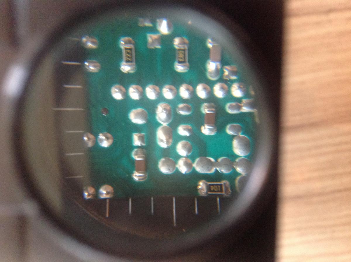

Vince70 Posted March 15, 2014 Author Posted March 15, 2014 Cheers Brickwall there's nothing I can see with the human eye (not mine anyway lol) but I put it under an eye glass and can see what looks like a bit of white haze around a couple of joints and on the other board there's a copper colour mark. I may buy a solder pen and see if it works, the board is so minuet that I don't think I would have the skill or eyesight to solder it up properly.
brickwall Posted March 15, 2014 Posted March 15, 2014 On the lower pic there seems to be a blemish or burn through. Is that the bit you're kalking about. Online scrappy search?
Vince70 Posted March 15, 2014 Author Posted March 15, 2014 I don't think it's a burn mark it looks and feels like a metal pin that goes through the circuit board.. I was wondering if it was the white mark around the solder joint that may be giving me the problem around the solder joint.. I've given it a bash and it still won't work lol.. The pictures I've put up are quite enlarged as I've taken them through my old linen tester from my print days.

Vince70 Posted March 15, 2014 Author Posted March 15, 2014 I took a gamble in the end and managed to get one off an 80 sport for £9 off good old eBay..The pins all line up the same so it's fingers crossed when the part arrives...
Grundig Posted March 15, 2014 Posted March 15, 2014 There are two small solenoids inside & contact points that pit/burn their surface - a very gentle clean up with fine production paper will 99% of the time sort them, on the coupe it controls the windows & sunroof (if fitted) The switch should illuminate with ignition on This was the relay fitted to my coupe Vince70 1
Vince70 Posted March 15, 2014 Author Posted March 15, 2014 Cheers Grundig I will give that a go... Its just I'm not too sure where the contact points are and I couldn't see a way of getting into the solenoids as it is sandwiched between two circuit boards...
Grundig Posted March 15, 2014 Posted March 15, 2014 Cheers Grundig I will give that a go... Its just I'm not too sure where the contact points are and I couldn't see a way of getting into the solenoids as it is sandwiched between two circuit boards...They should be attached to that copper thing in your 1st pic - sure mine only had 1 circuit board though
