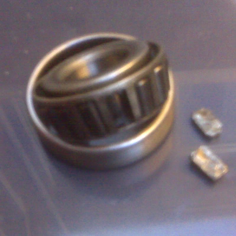

tooSavvy Posted December 18, 2013 Posted December 18, 2013 Hmmm... I had a full set of TAPERED rollers + 2 halves. Dealer wound the nut up 'well tite' and 'log splitter-ed' the weakest one [replaced under warranty & went again....] I'm a really slow learner ..... fitted my own, from a local brg shop, and told the dealer to F**K OFF touching them, next service!! never had a problem since... TS
