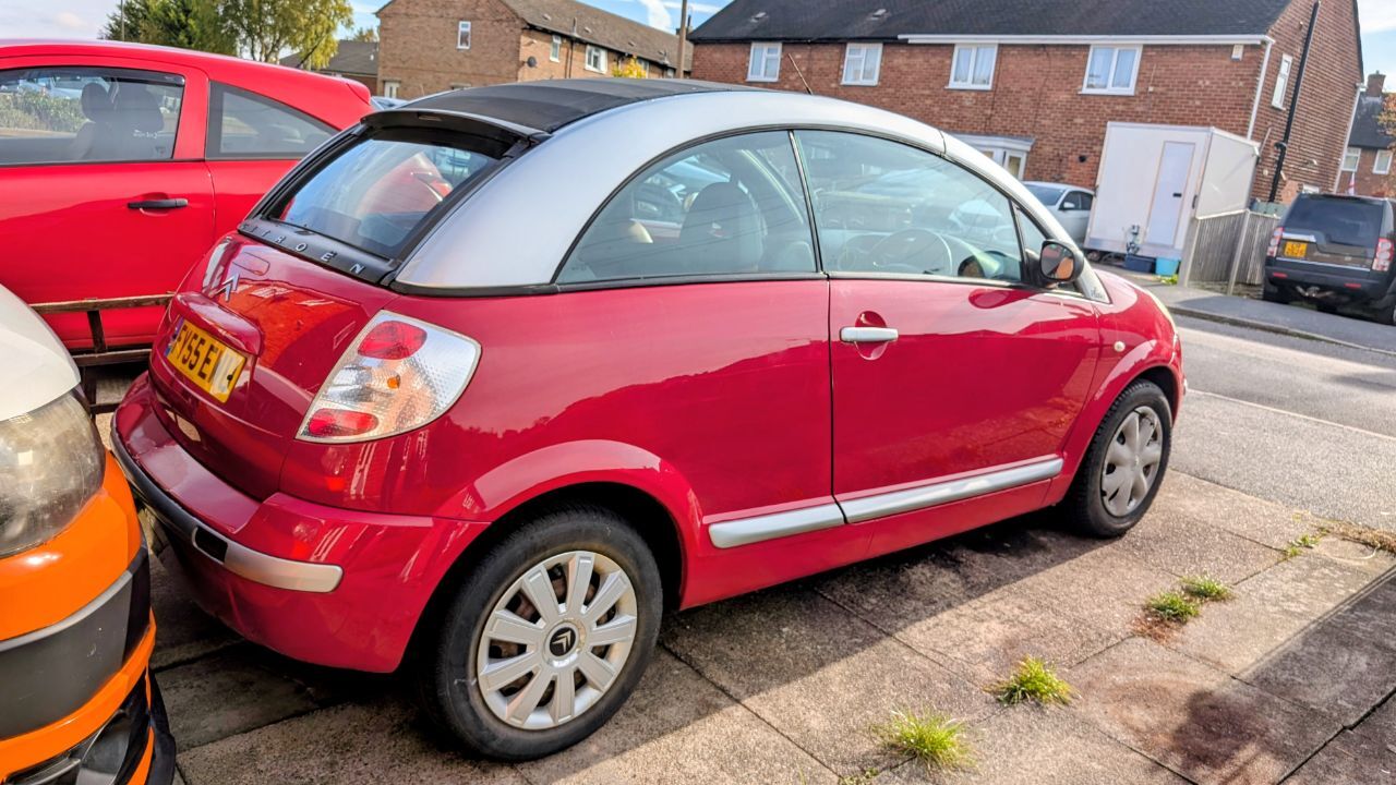

autopaul Posted October 11, 2025 Author Posted October 11, 2025 Just needs wheels and a headlight polish and the old pram will look presentable once more Bear, RayMK, FakeConcern and 4 others 7

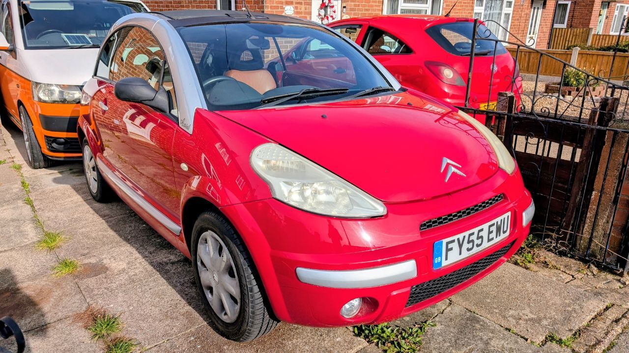

autopaul Posted October 17, 2025 Author Posted October 17, 2025 I managed to quickly polish the headlights last night. I forgot to take the obligatory before picture, but did remember to take one when I'd done one light And both done Not bad for 5 mins, a mini polisher and some 3m fastcut. I'll wax them for winter, then have a proper go at them come spring. When I'll probably machine polish the whole turd. Just need some alloys, preferably with tyres already fitted, so I can get rid of the 05, 13, 13 and 21 stamped tyres. The 20 year old Michelin worries me slightly. Bear, stuboy, FakeConcern and 3 others 6
