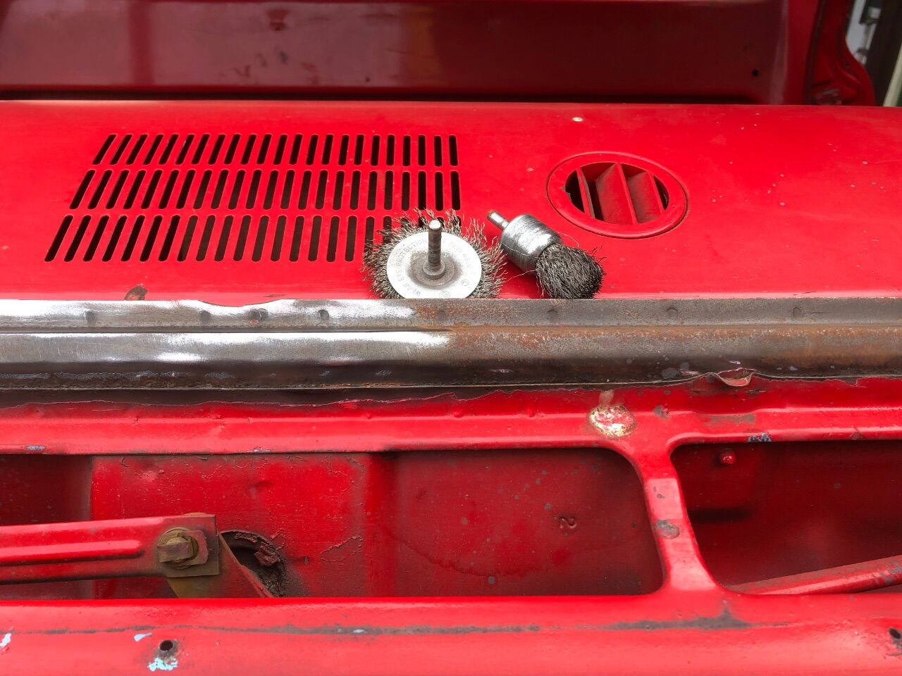

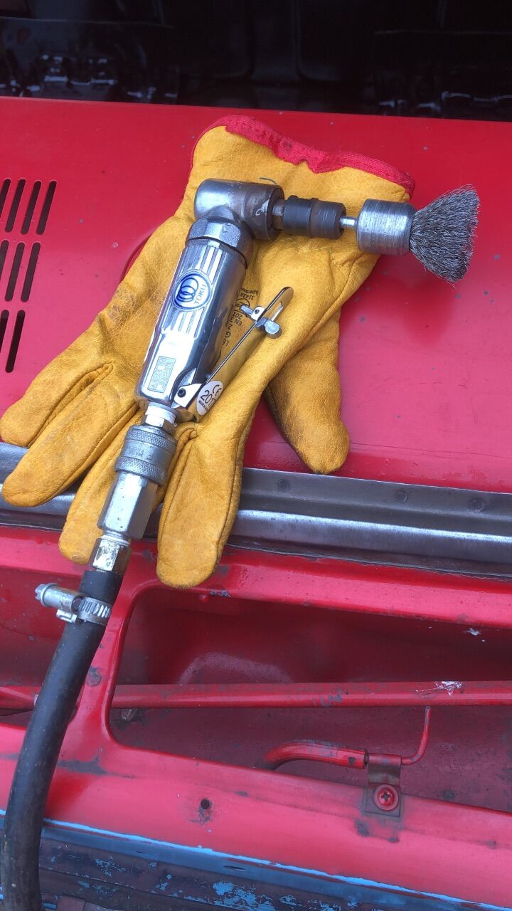

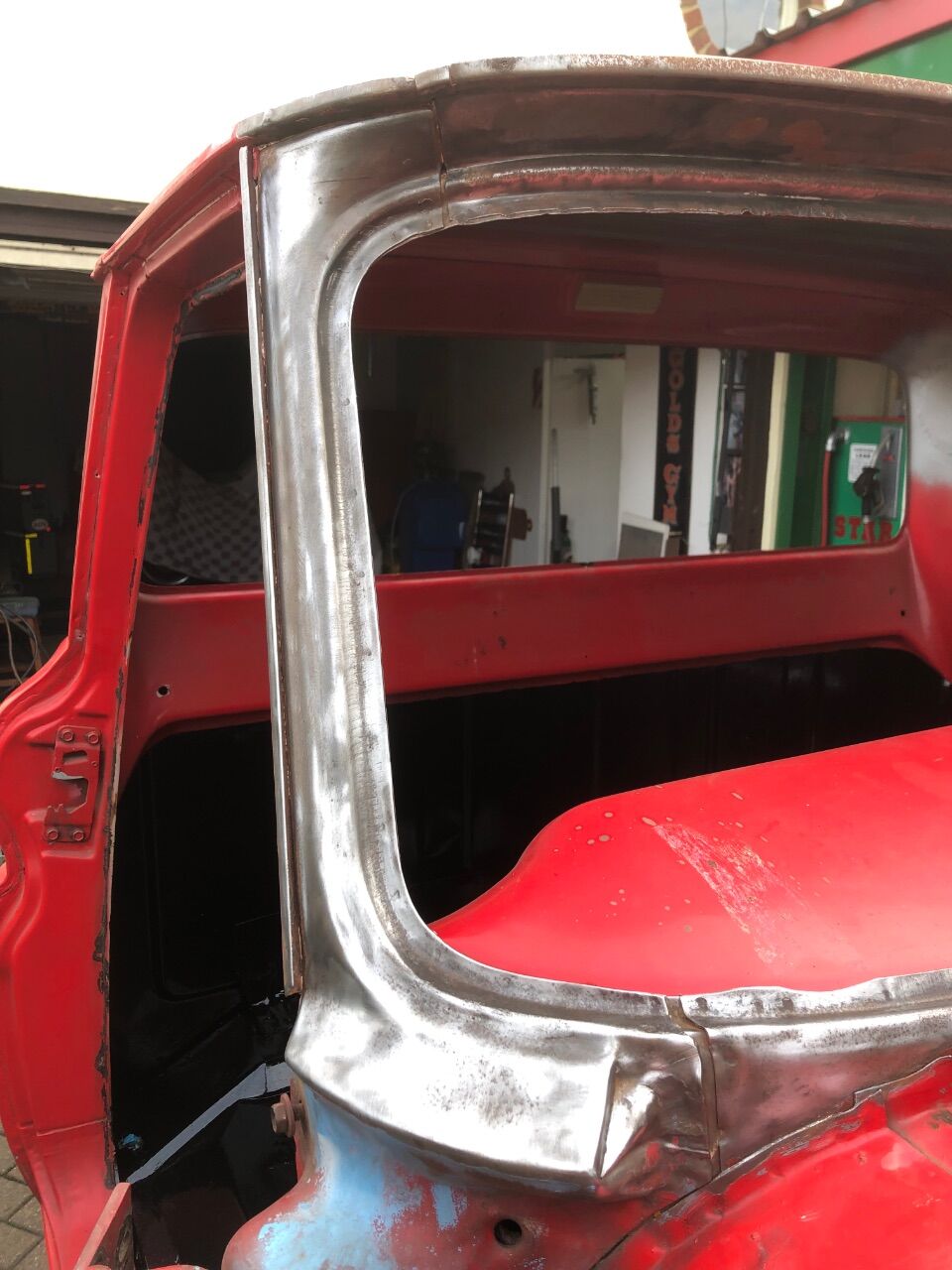

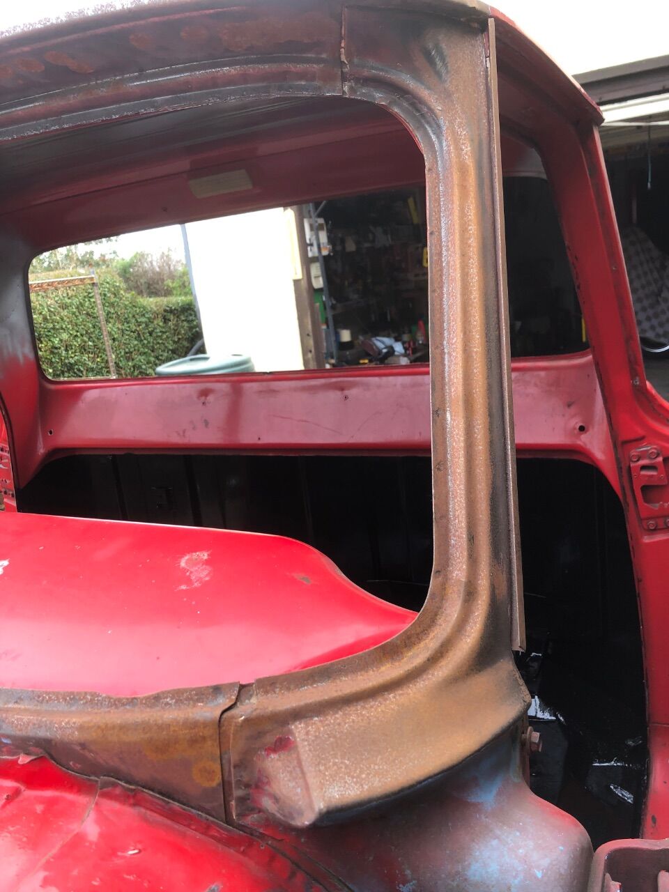

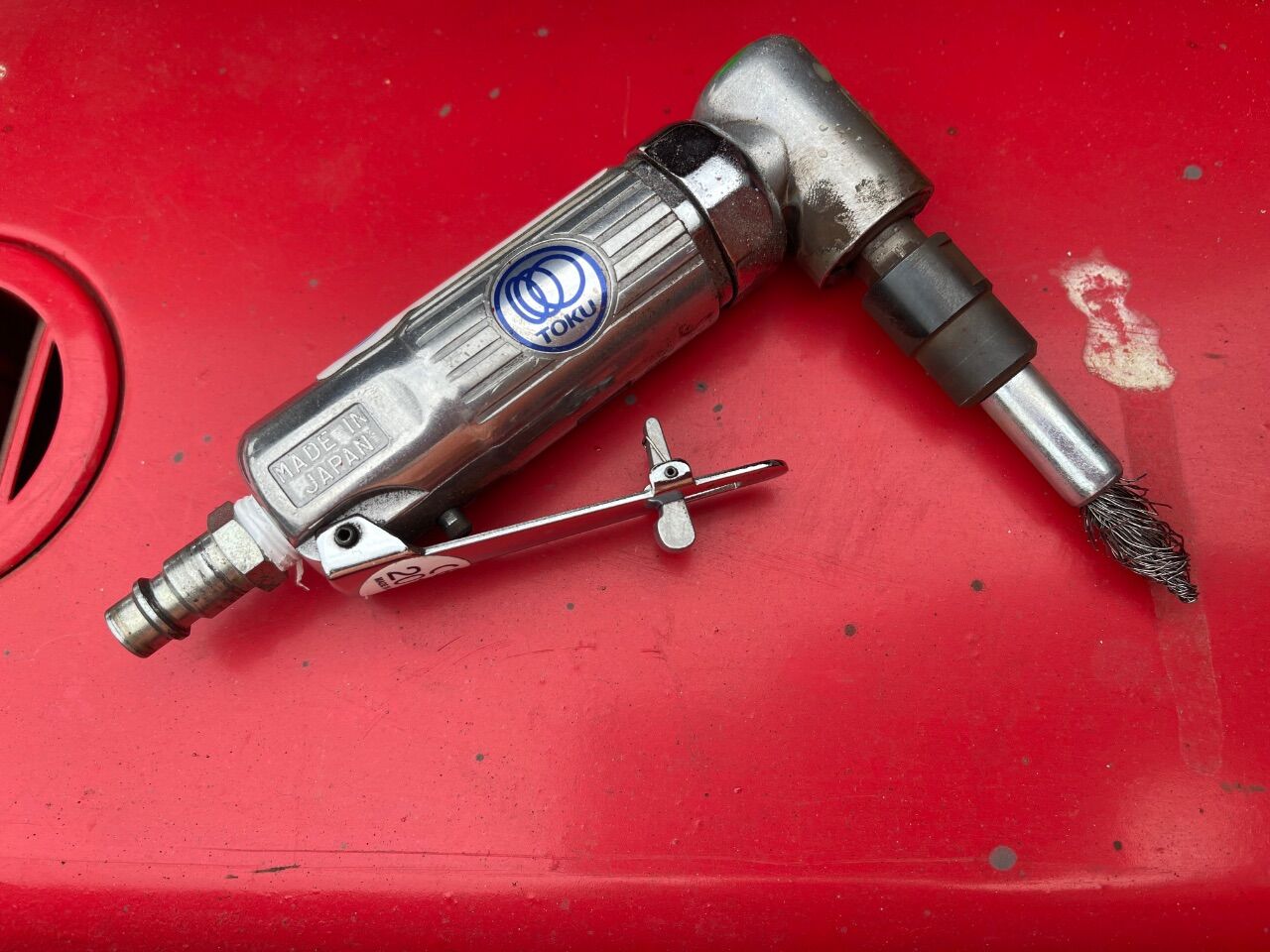

So I got onto the front screen frame with a wire brush on my air die grinder

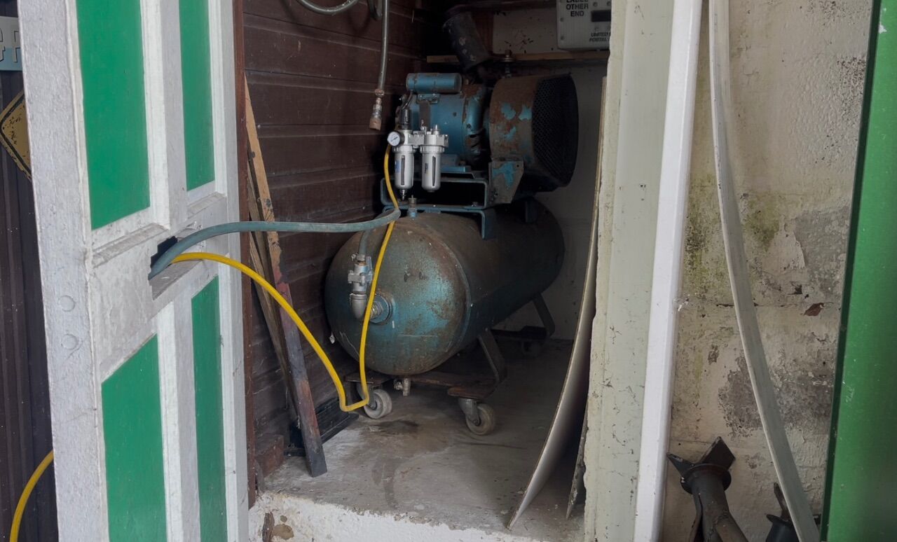

It is very air hungry but the compressor almost kept up with it.
I also tried some new shaped pointy wire wheels….. Absolute Junk in my opinion
I would not recommend them unless you know something about them that I don’t know
Post advice in the video comments or down here, to show you are alive
Photos of before and after
What rust  potion treatment are you using ?
Yeah, those brushes aren’t really that good. A die grinder is probably a bit too fast for them too.
  • Agree 2
Nothing
i actually ended back on the drill in the next session
Well…….
It seems like I may have unknowingly pissed in someone's ear.
According to the boxes, those brushes are rated to 4500 rpm, die grinder will be way way faster than that, they must be pretty good to have not disintegrated at the speed you were running them.
Air tools are expensive to run, afaik a drill will use about 350 watts, an angle grinder a little more but your compressor will be using about 2800 watts, so guzzling the electric
Ttfn Glenn
Ttfn Glenn
Thanks Glenn
Guzzling electricity and actually not doing the job as well as I thought.
Video below to illustrate.

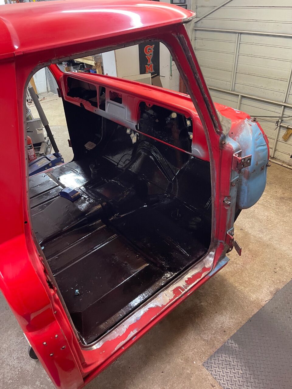

Next little job to get done was the door frames.
At some point in the past the door seals were glued in place.
So when I took them out  in 2015 there was rock hard residue on the door frames.
Using a knife an a scraper both chipped the paint and glue all the way down to bare metal.
So I decided to try using the air driven die grinder.
Passenger door done that way with the die grinder and with other things,  The high speed of the grinder unfortunately melts the glue and spreads it.
So I changed to the cordless drill with a wire wheel on the driver side.
Much better.
VIDEO.
Ultimately, I carried on and sanded back some more of the paint on the sills and eventually shut shop
I had also done a few other things that needed doing

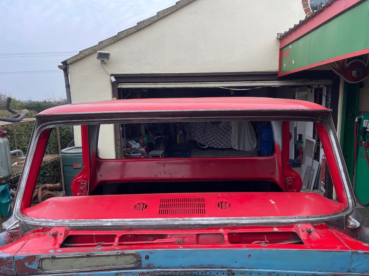

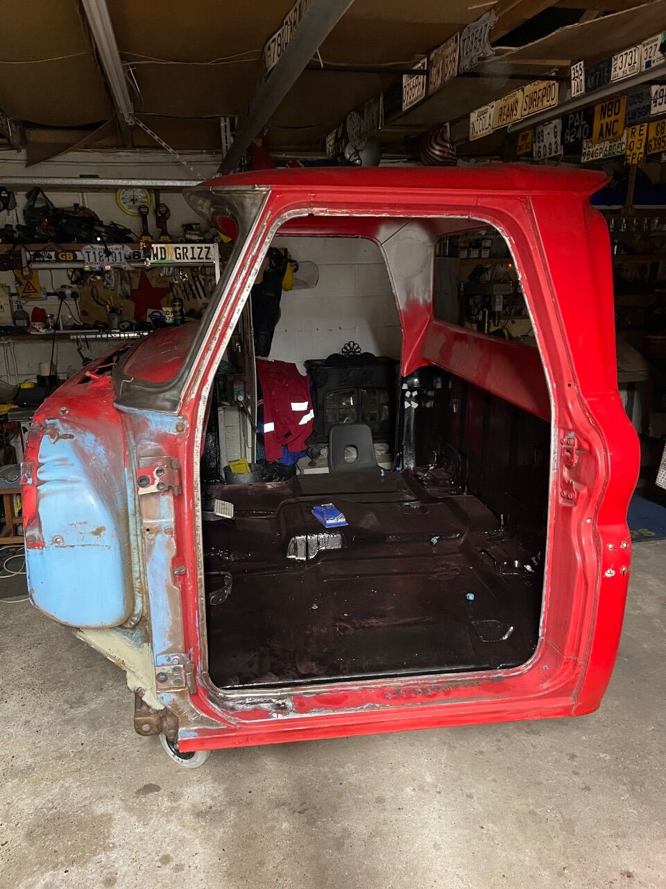

So on Saturday I had a long chat with Dennis and he suggested that I do a bare metal repaint because of the layers of paint already on the truck
I really didn’t want to do this
More discussion about this to follow
Thanks for checking in
I think, given the layers of paint, I’d be agreeing with Dennis.
Not sure if I’d want to be stripping it by hand though, even though it’s small. Have you considered getting it blasted?
"So on Saturday I had a long chat with Dennis and he suggested that I do a bare metal repaint because of the layers of paint already on the truck
More discussion about this to follow  "
... seem to recall a conversation , week ten days ago .. :)
I will pass on the logistics of blasting.
nearest place is Rye.
Mate Martin ended up with a new cab after blasting. Maybe not their fault.
However, I am not going down that trail.
I already had doors, fenders and some other parts done and etch primed 5-6 years ago
I will continue with the orbital machine or a DA sander.
I will do all larger flat surfaces bare metal and possibly live to regret not getting the rest blasted.
Thongs like bedsides are both fragile and if you look at the cost of a pair, delivered……. Nope.

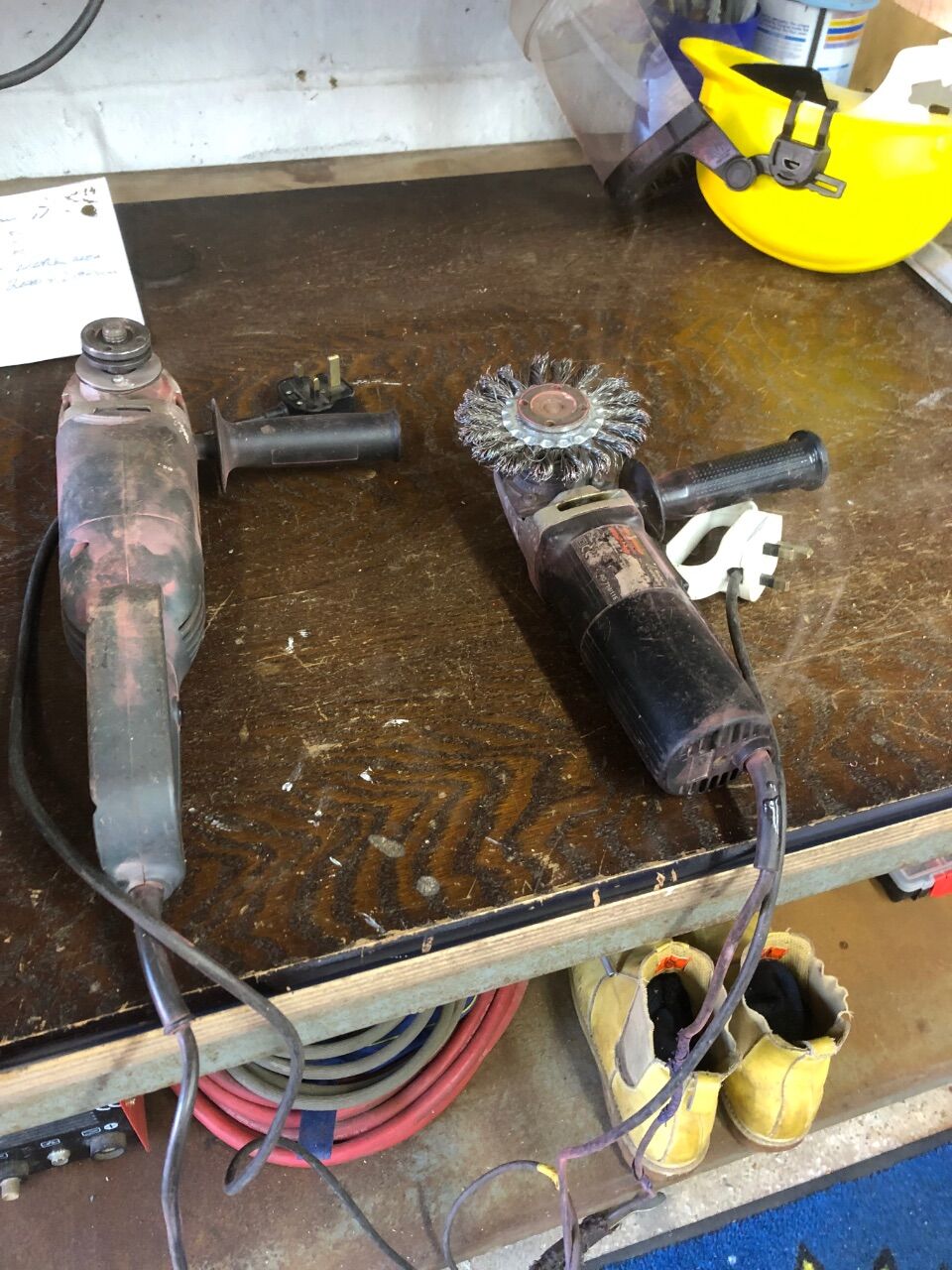

BRAVE GRINDER 😢
You gave your all…..
And I pushed you beyond your limits.
Till you gave up the fight with a POP-PFFFFFFTTT…
And smoke from your gills.
SOOON YOU WILL BE A DISTANT MEMORY
I am off to Evilbay to look for a replacement 125mm brutal grinder to intimidate me once again.
RIP

also killed a vintage Atlas Copco 115mm grinder Mickey had thrown out.

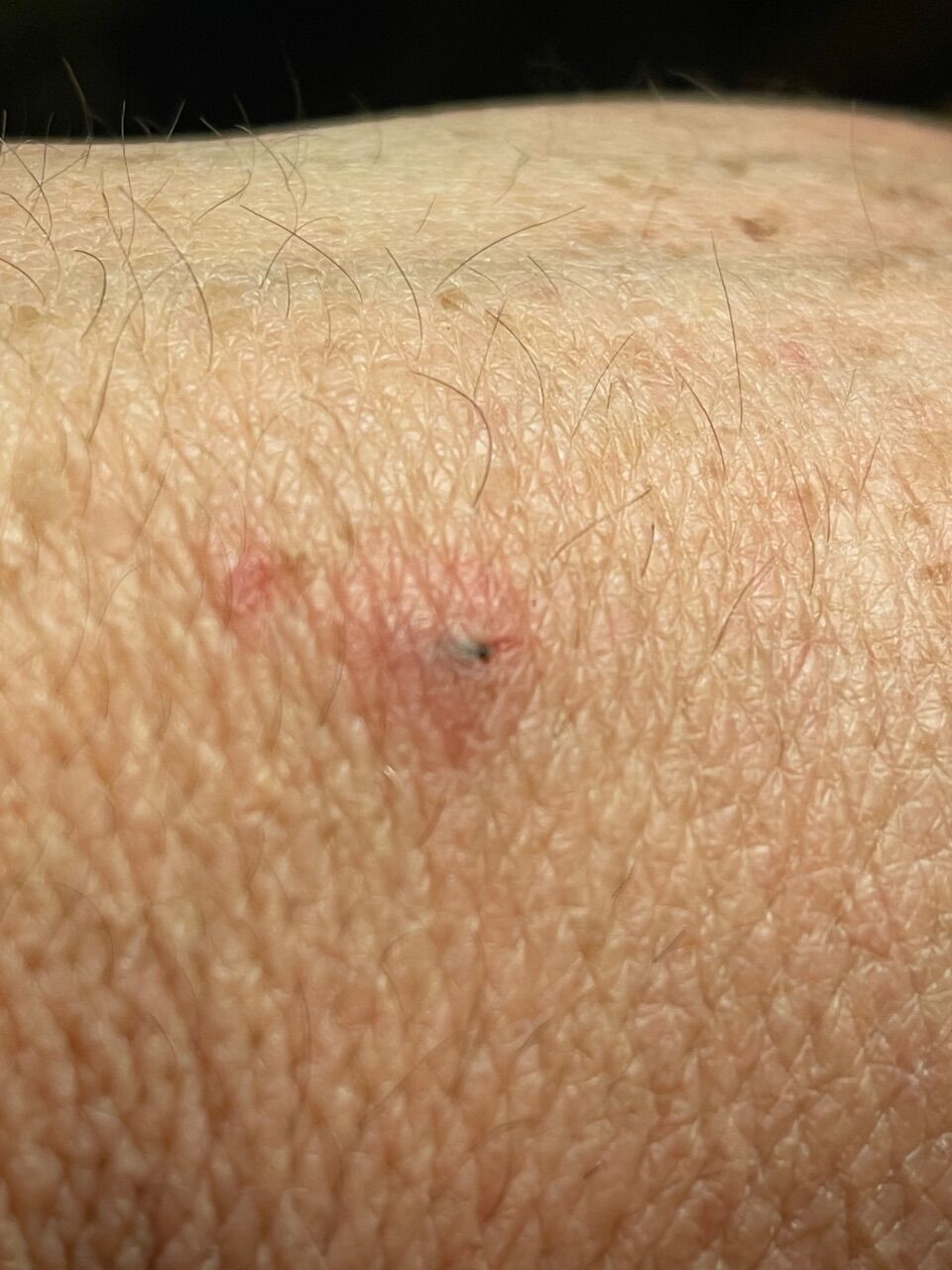

11.15pm last night, lights of, turned over to go sleep……
Felt a grrrrrrrr….. on my wrist against the duvet cover.
Lights on, mobile phone torch, tweezers…. Fail.
Balancing act with torch and sharp knife, dig, dig, fail.
POKE DIG SCRATCH LIFT SUCCESS……
Klein bliksem.
Was straight vertically embedded.
