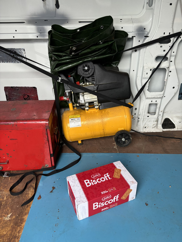

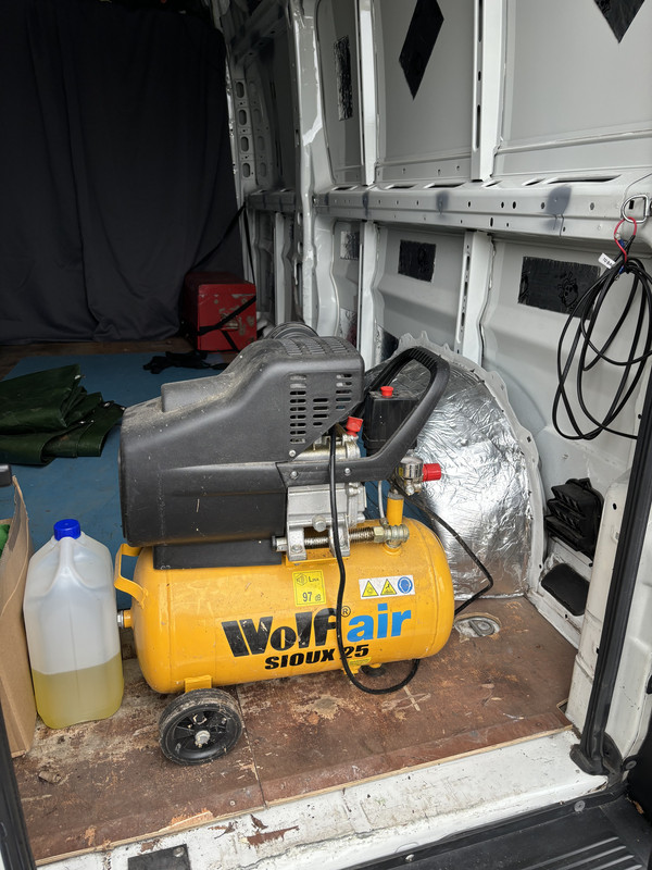

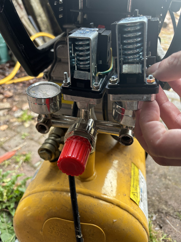

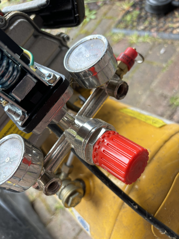

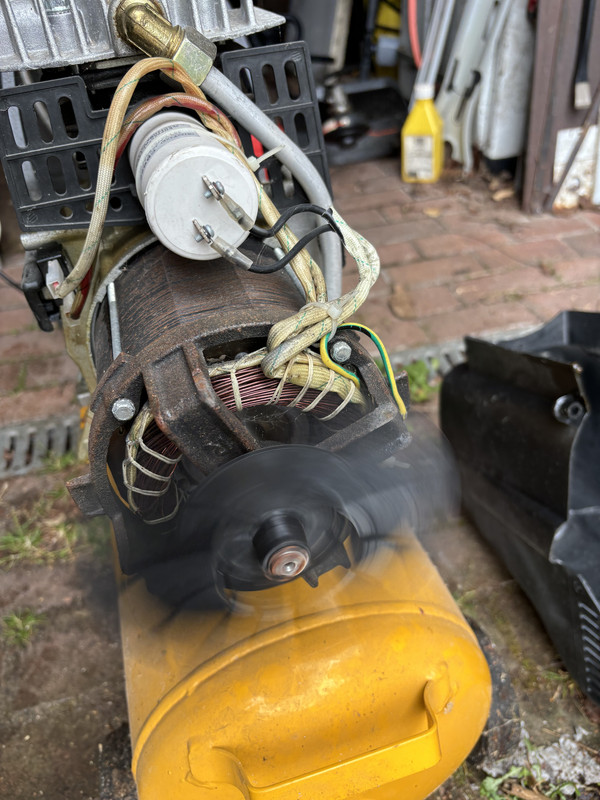

Took advantage of a lull in proceedings at work to have a look at the broken compressor that [USER=8280]@Mr Bean[/USER] very kindly offered up in the 'free' section and which I picked up from him on Monday.
With nowhere else to store it it's been living in the back of the van.

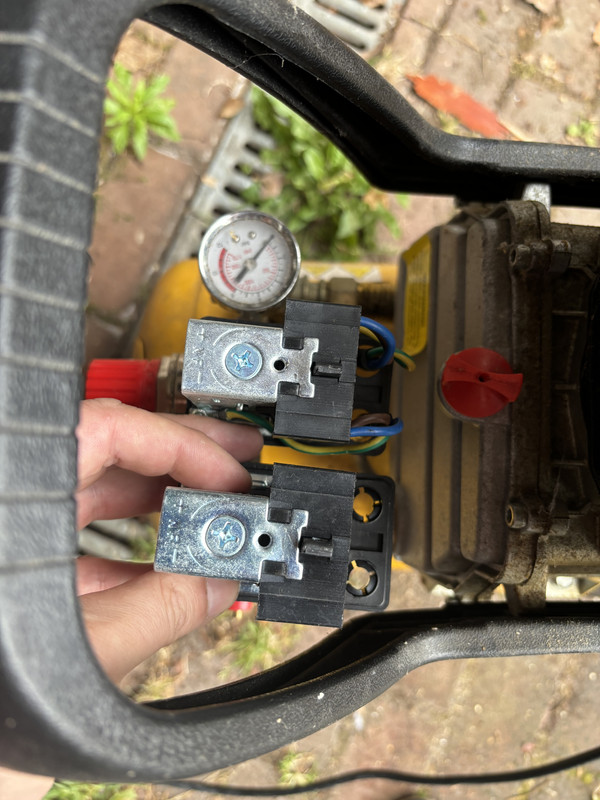

Mr Bean suspected the switch, as it had made a click but then nothing happened. Fuse in the plug had been replaced but still no joy.
As it happens, I have a spare switch from when I snapped the manifold on my compressor a few years back.
Initial side by side comparison suggested a match.
Happy with that, I decided to run a continuity test before starting to remove stuff.
I didn't get any pics as I'm not an octopus :D
However, the multimeter doesn't lie, and it was saying the switch was fine.
It also said the fuse in the plug was fine.
It said that the cable from the plug to the switch was fine.
So, everything pointed to where the switched side of the cable went to.

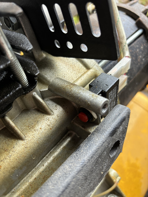

Took the cover off only to find what I assume is a trip switch.
Pushed that in and plugged it into the mains.
Success :JB

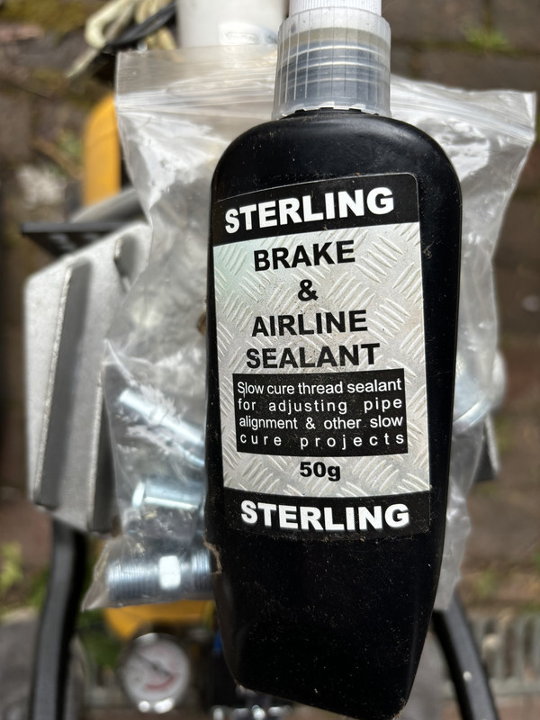

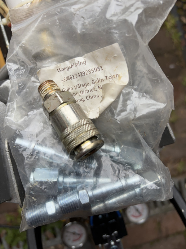

That's as far as my testing went as the airline connectors were removed from this compressor and put onto Mr Bean's new one so there was no way of seeing if it was compressing and holding air, but there's no reason why it shouldn't be as it was working fine before.
I had a look in my compressor 'bag o spares' and found one connector
I also found my airline sealant
Decided not to fit, just in case this is not Grizz's preferred airline connector type, but it's all packed and ready.
From skip contender to working tool for pennies and ten minutes with some screwdrivers and a multimeter :thumb2

Compressor was loaded and lashed down, and some of the 'Grizz Pile' in the form of Biscoff biscuits which cash and carry had on their 'clearance' shelf. Those that know Rian may know the story, but I always associate these with him.

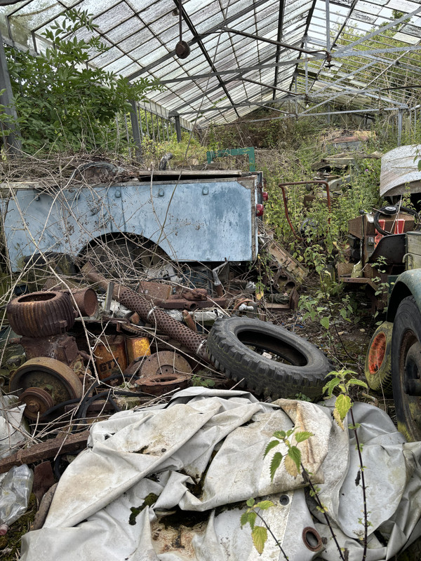

The bastard only went and took my to Uncle Bob's place.

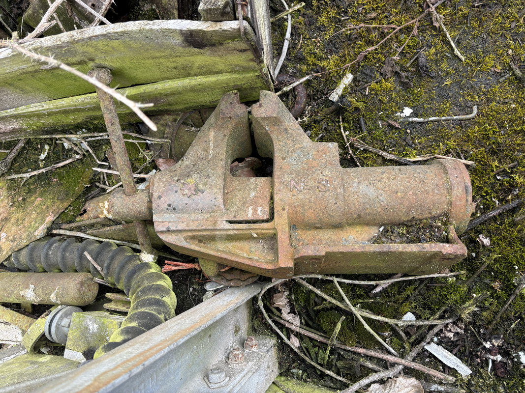

I fell in love with almost everything there and wanted to take it all home and do something with it, but thankfully I don't have space for 34 tractors....
This little beauty however....
Once back at HQ we pooled our pile of compressor odds and sods and managed to fit and seal two new connectors to the manifold and the final testing of the compressor took place.
As expected, it fired up and reached pressure without issue. The only other work it required was a tightening of the switch cap as I hadn't done that for whatever reason.
One fully working compressor rescued from the tip, cost to fix £0. Value = priceless.
