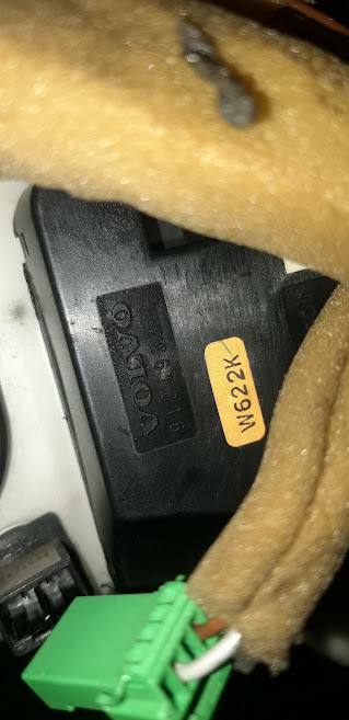

Whilst the dash was going to pulled apart i thought its time to get the resistor changed at the same time. Yet another wrong resistor had been sent to the seller again, so i decided to get one sorted as winter will be on its way, and my insurance renewal was getting ever closer.
The heating set up on this car is the Electric Climate Control , which makes this resistor unique to the ecc. ARSEHATS
But surely being a Volvo it wont be hard to get a replacement. Oh how wrong was I.
Nothing with the same part number on ebay, this part is unavailable from Volvo anymore. So i looked on forums etc and it seems to be a rare part, I phoned a Volvo breaker near Hull who had a part from a V70, he sent me the part number and i looked online, it looked identical to mine except different part numbers, He wanted £25 and £10 postage. I could send it back if it didnt work.

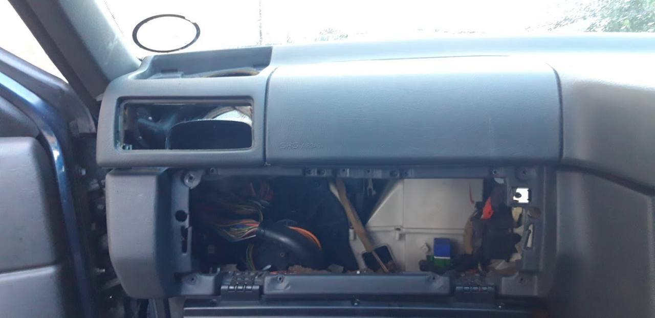

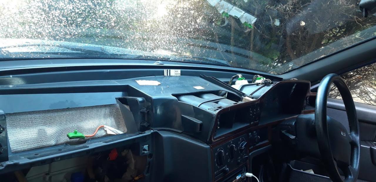

Heater vents out, glove box removed, screws unscrewed it was going well.
Dash top removed and finally to free the clocks

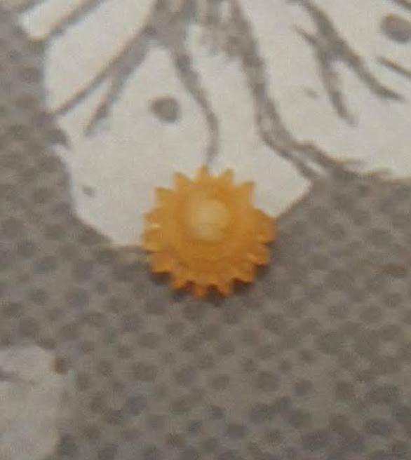

Clocks stripped down, mileometer removed from the cluster and the offending cog replaced.
All this aggravation for this little bugger.
The odd thing is that the speedo is an all electronic affair,  not cable driven, so why does it have an analogue mileage when its an electric motor turning the cogs that keep the mileage. Funny old game eh!

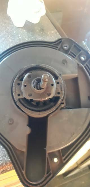

So the rebuilt clocks were fitted i thought its time to look at the heater fan, especially as it should be easier to remove now the glove box is out and dashtop is off.
Heater motor was removed fairly easily, its just the wiring that gets in the way

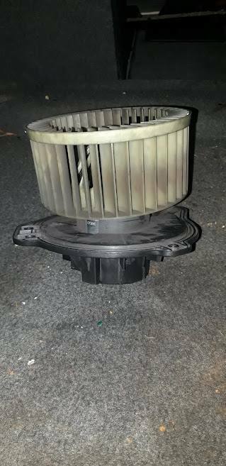

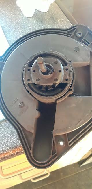

Motor Hamster cage looked in good order and round, so i removed the cage from the motor to be met with this.
759841523_heaterfan1.thumb.jpg.c56535909783df4324abe9e0f63167b6.jpg695670653_heaterfan2.thumb.jpg.8b49096e7b3286e8416b43efc6e3a2fc.jpg
I thought if I get the used motor from Hull, and use my cage from above then its job jobbed.
So I phone the breakers at Hull , only to be told that he has now sold that fan, (It was his last one)

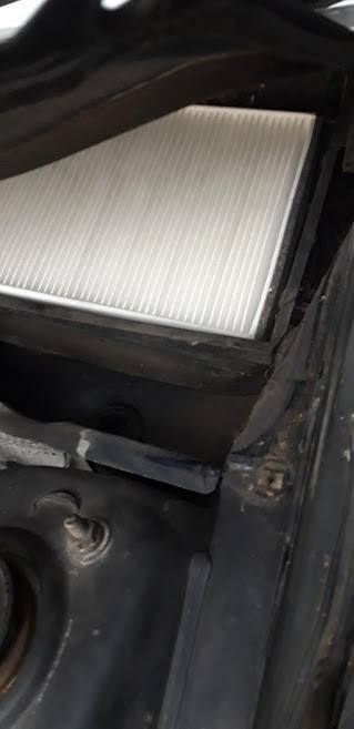

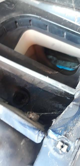

So its time to start putting the car back together,  Everything went back together smoothly fan back in, dash top back in, fan motor about to be installed when i spot 1 or 2 cm's of water in the  area the fan sits in. I drain it out and think to check the cabin filter.
Ar, the none filter
Ebay order and a few days later we have a Unipart filter installed, delivered for less than £5
So everything is in, fan motor installed, trying the new resistor and it spins for 1 second again. Least ive got the original unit being rebuilt. Been 2 Weeks since i sent it off.
Finally go to fit the glove box and it wont fit anymore, the v70 fan is a bit deeper and hits the inside of the glove box molding. WHY OH WHY is such a simple job fighting me so much
