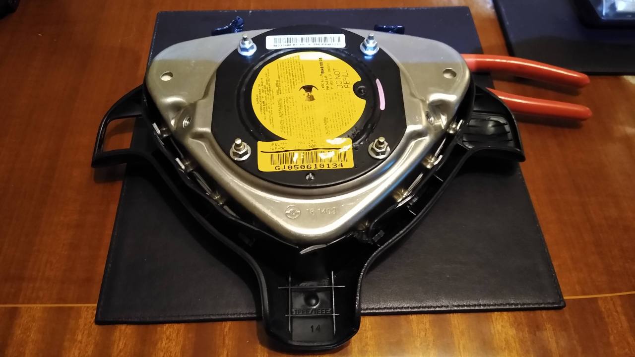

Carefully prise unit out of steering wheel centre. Caution with clock spring connection.
Remove airbag connector from rear of unit.
No bang = win so far.

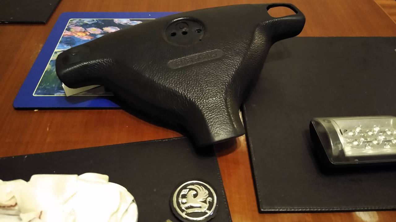

Carefully prise the old cover off the metal casing tags all the way around. A number of times.
Do not stab yourself in hand or the airbag charge.

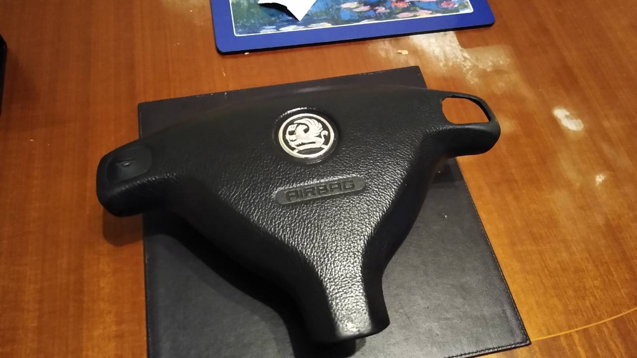

Drill badge off back of cover, 3 plastic lugs welded to rear. Leave approx 3mm to locate in new cover.
Glue or tape badge to new cover.
Refit cover to airbag, up, over and back until it sits in place.
