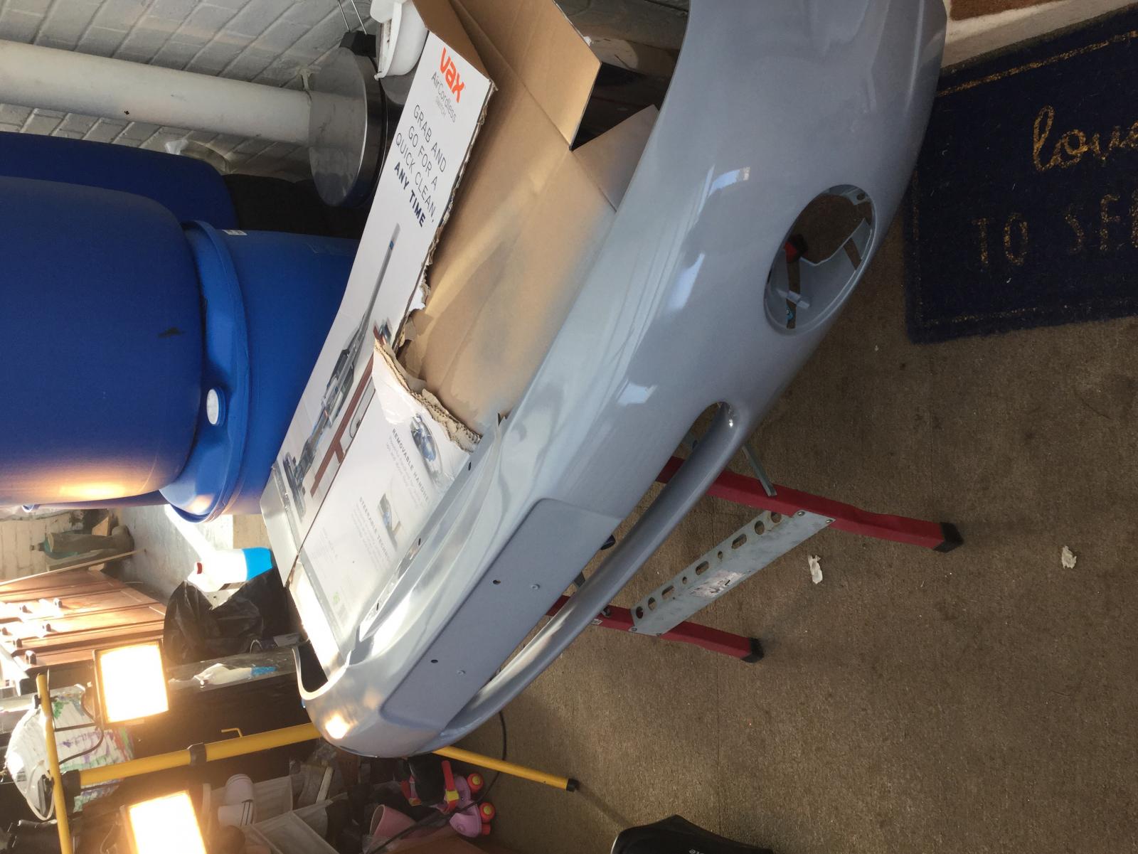

Painting it on the car was a no no. So I used the trusty workmate and clamped it to that. Given the forecasters have predicted the next ice age I decided to use one of those big spot lamps that gives off a shit load of heat to help the paint dry successfully.

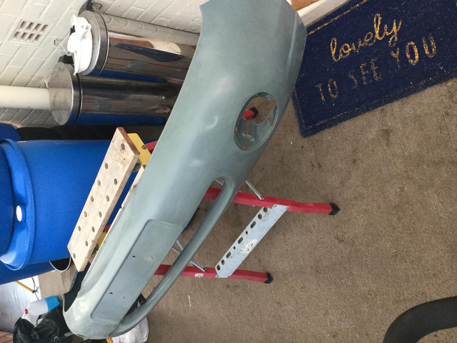

Anyway, started by flatting it down with some 400 grade wet and dry, it comes primed but I felt for the sake of £4 I’d prime it with some fresh primer from ECP. Once it’s thoroughly flatted I’ve then degreased it with some meths. You can get this in an aerosol for £5-6 if you like burning money. I just used a bottle I had in the shed that cost about 80p. But I’m tight.

Coat of plastic primer on it now, the heat from the lights will warm the panel up and speed up drying a bit. The actual colour coat will need to go on in stages otherwise it’s difficult to get it right. Aerosols aren’t really designed for jobs of this size but where there’s a will there’s a way!
I’ll flash a coat off every 30 minutes or so... once you’ve done a coat fuck off. Hanging round wet paint is a recipe for disaster.

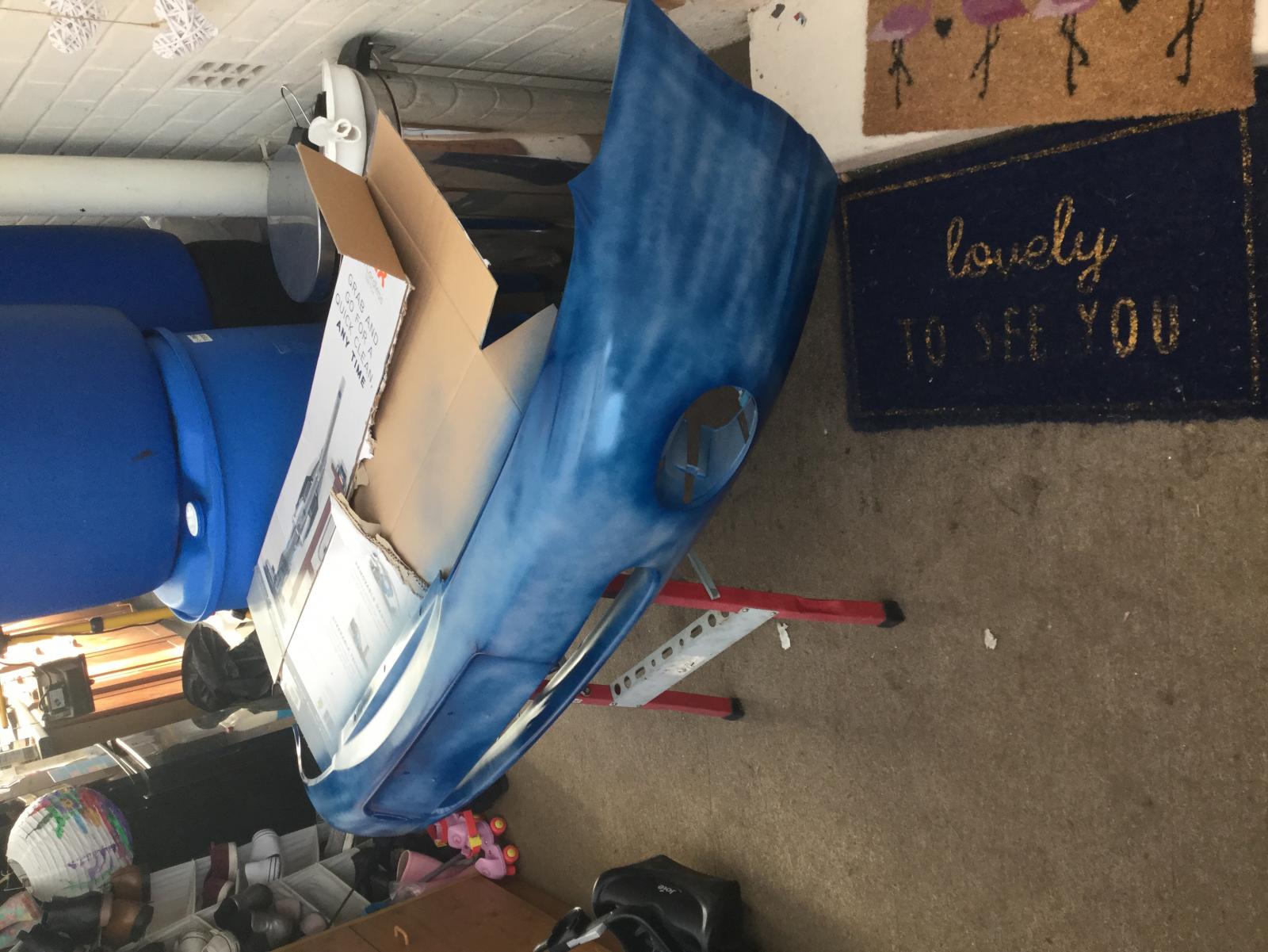

Gave it a mist of colour coat on it and cover off the edges first...
Moar coats of paint. I’ll give it a few more then leave it to harden before lacquer.
