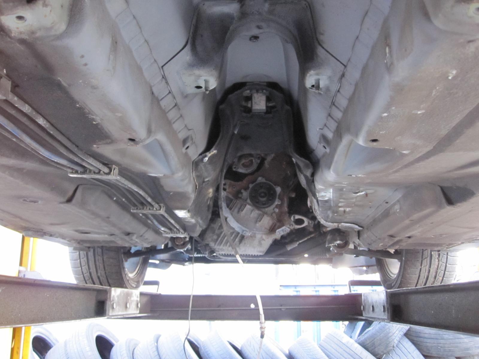

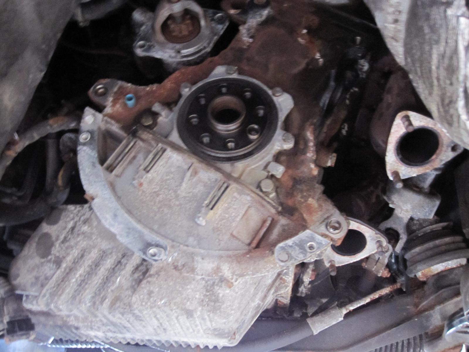

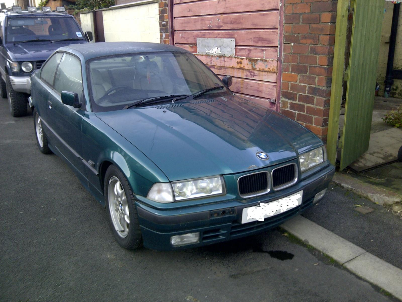

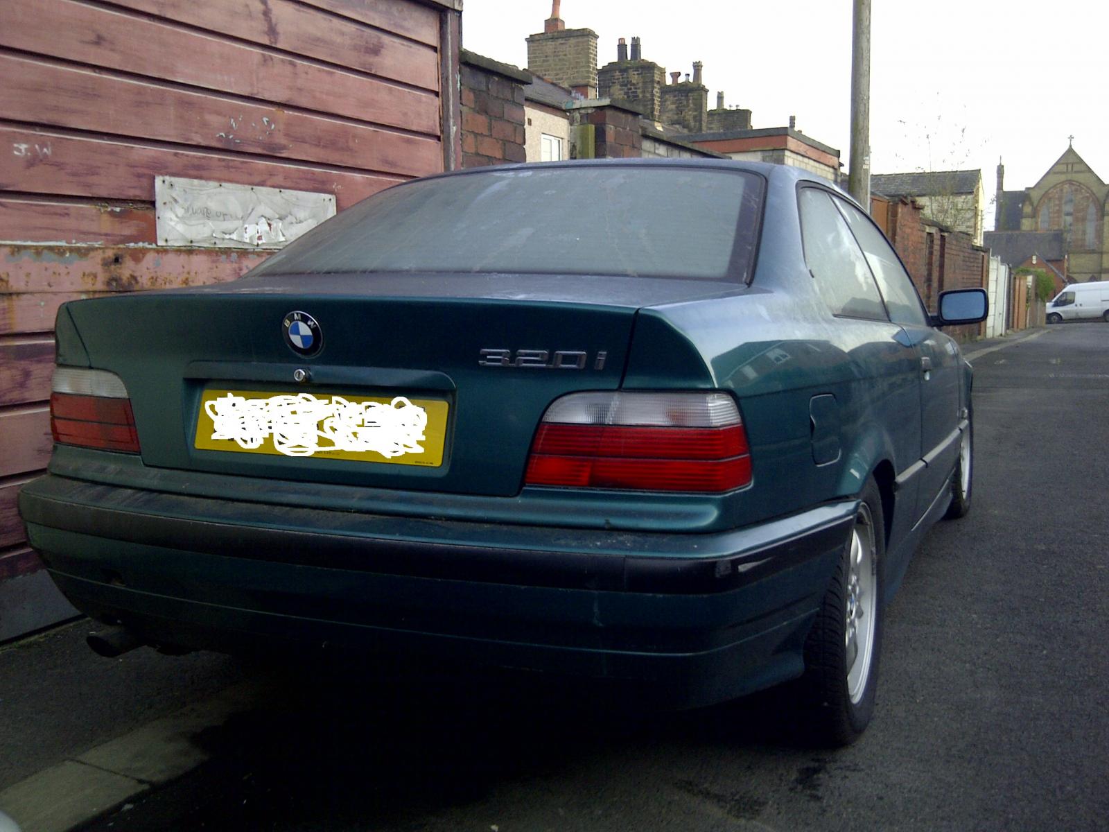

This is it coming out of the slumber, note the rad wasnt happy being woken up after 3 years!
Looking a bit sorry for itself here....

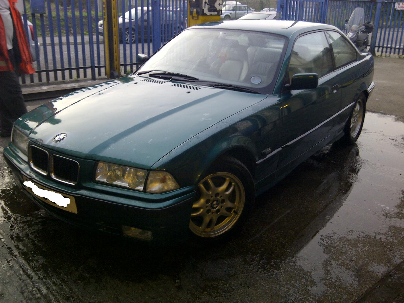

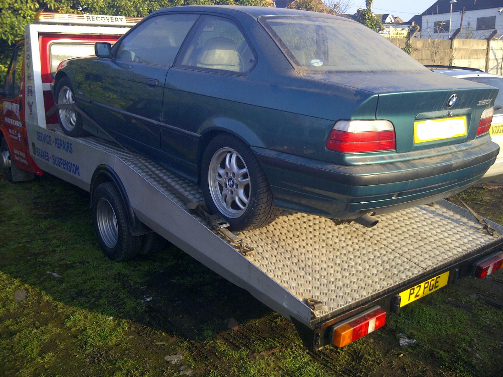

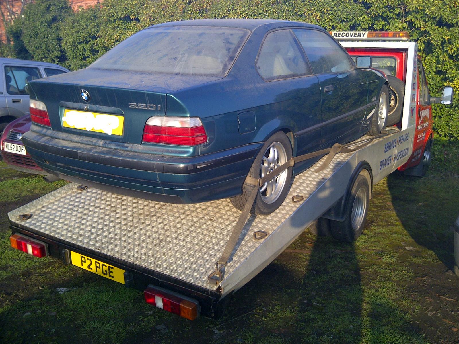

This is it arriving at the compound...

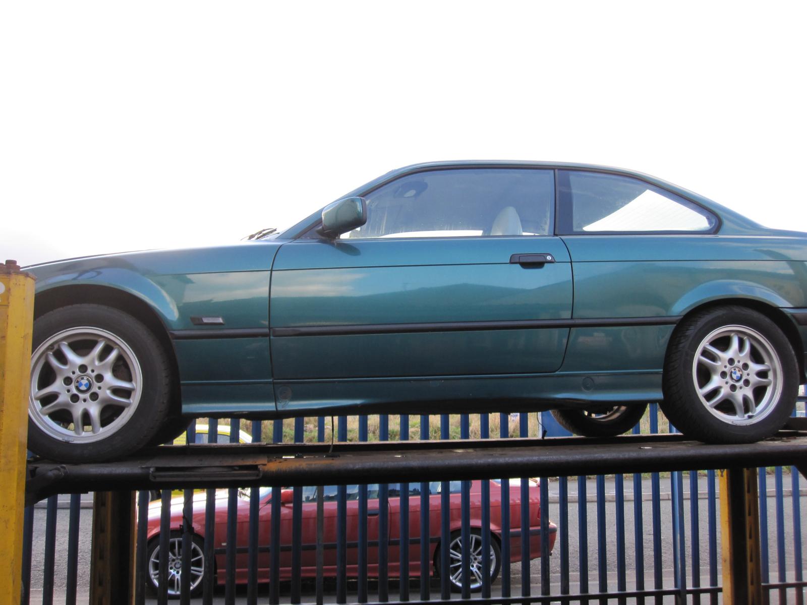

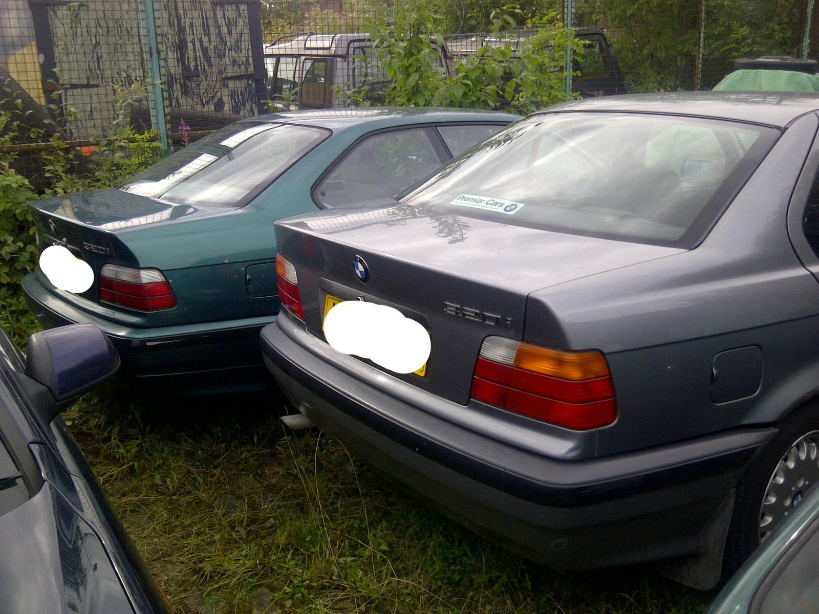

Donor car procured....

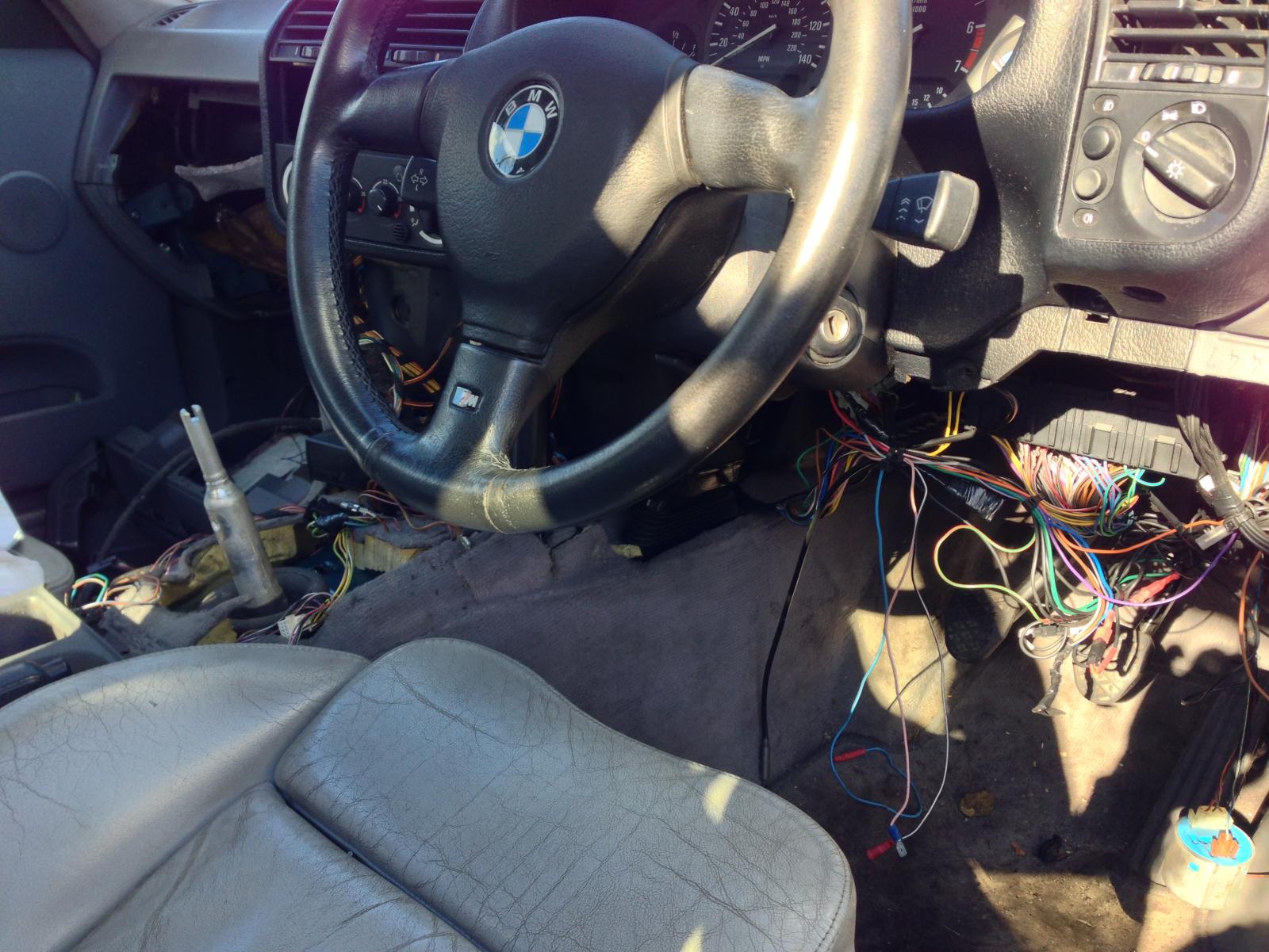

Phils coup in the background, running gear coming out...

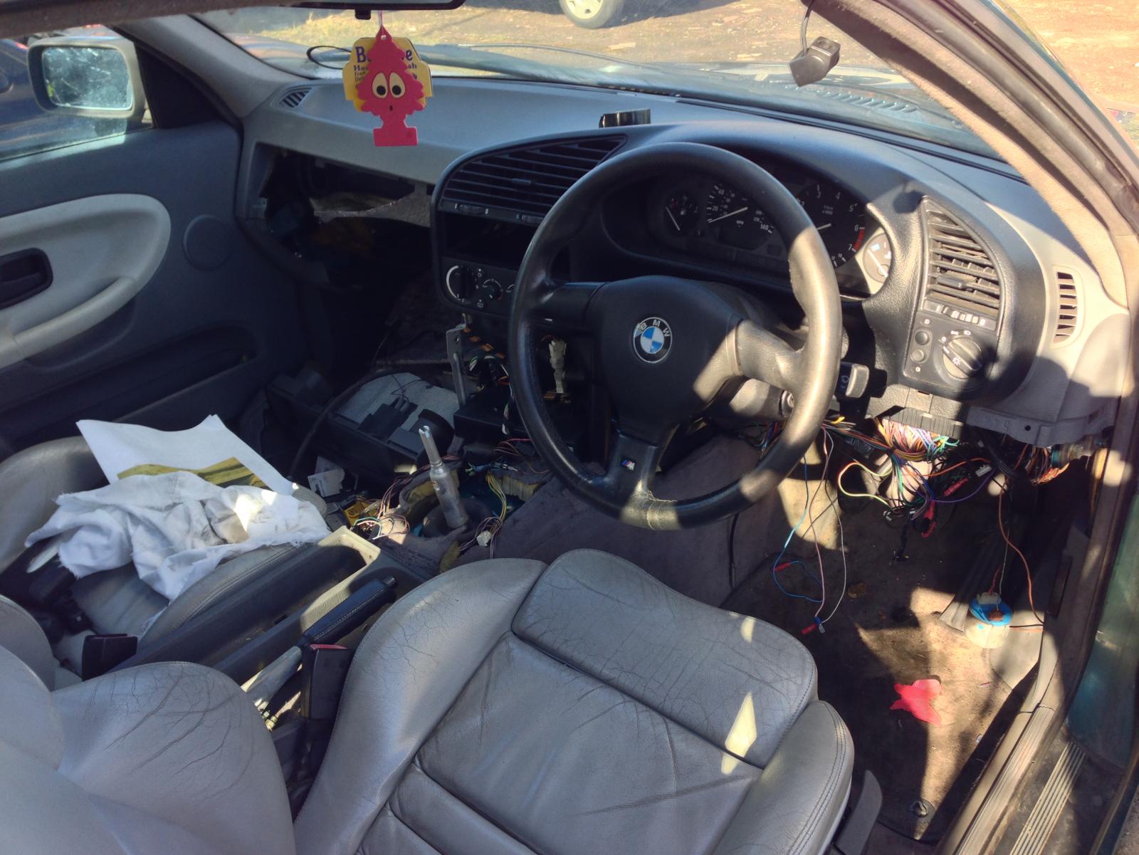

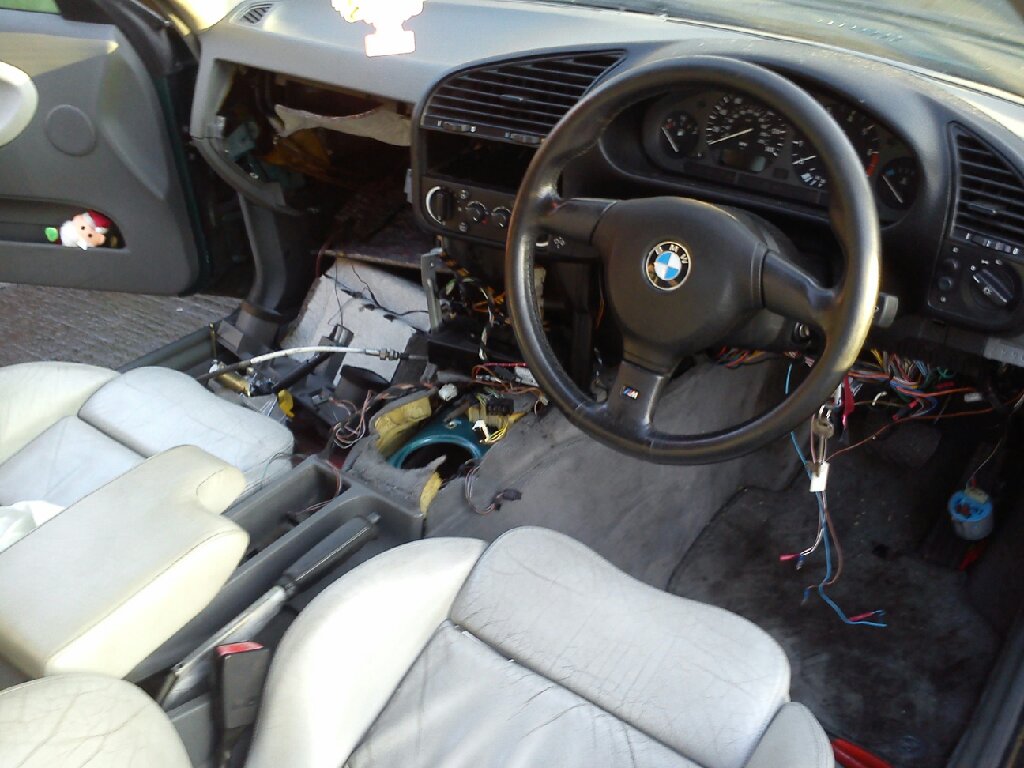

Things getting messy inside....
No comment...

Its an unusual color in that they only did it for 2 years on the e30 (although ive never seen one) and 2 years on the e36, its laguna green.
They later changed it to boston green which is a bit darker.
