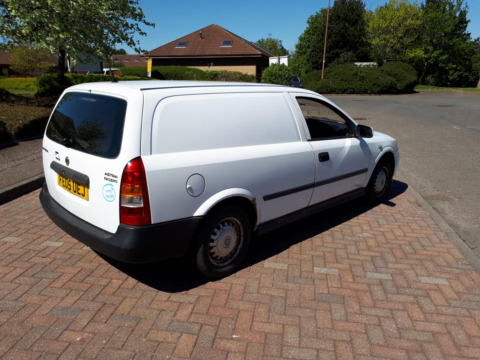

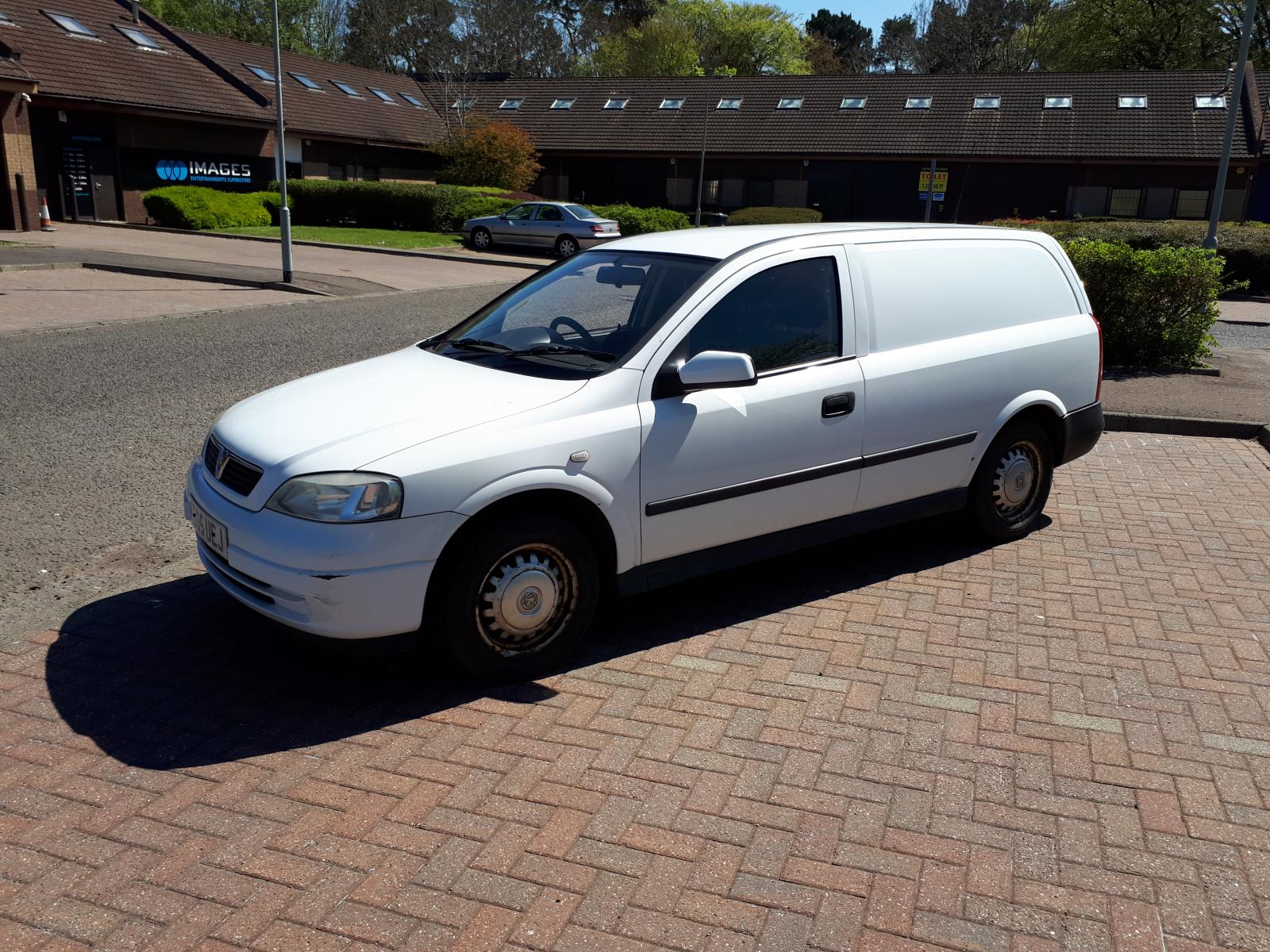

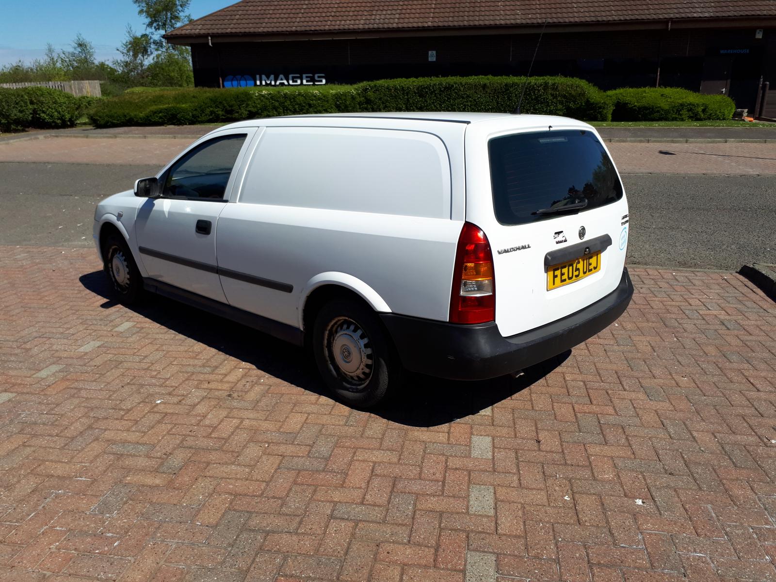

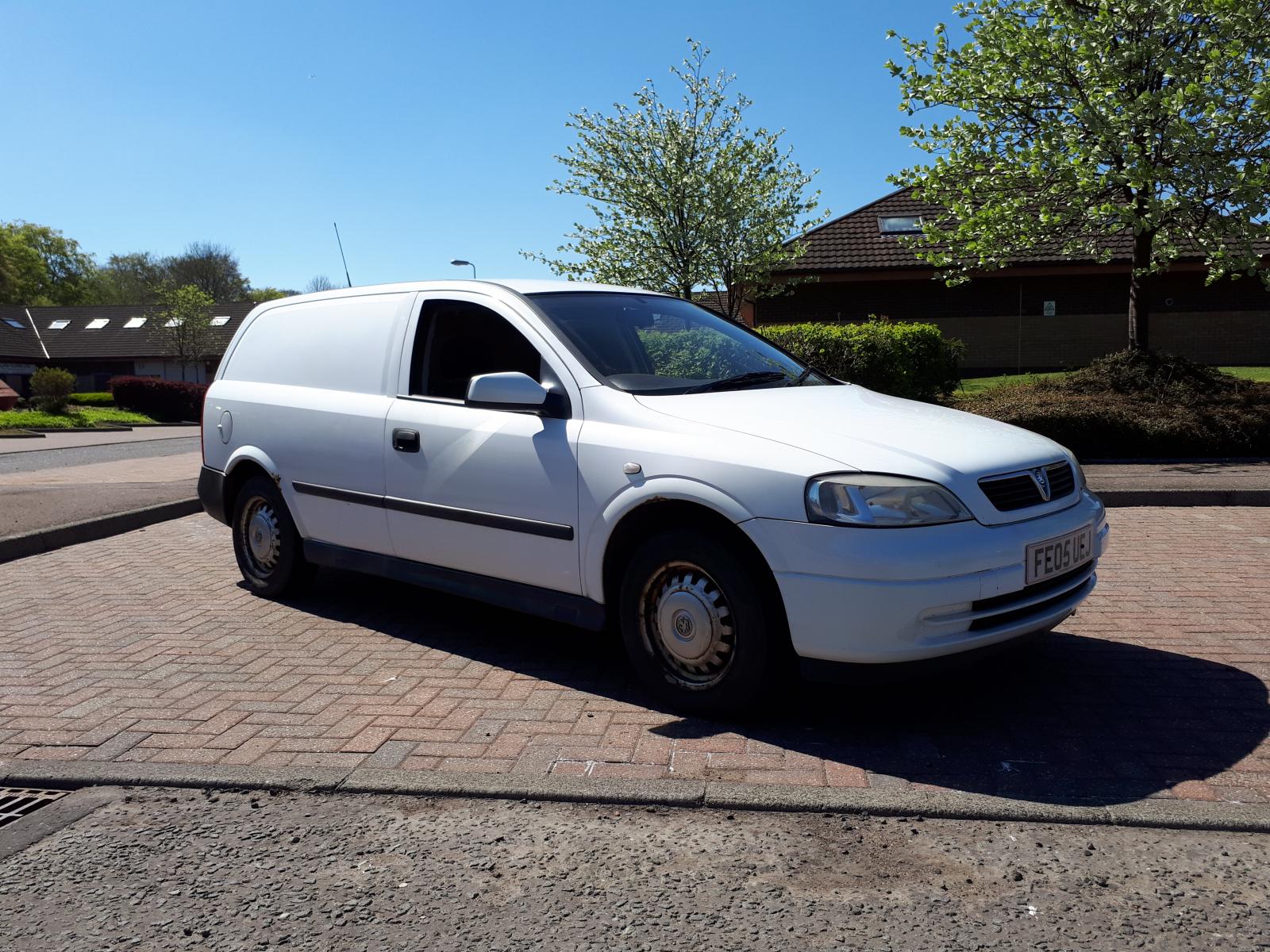

So.....Here, in all it's glory is my now running, Shiteish Van bought for very little.....Pictures taken before I cleaned it today.
