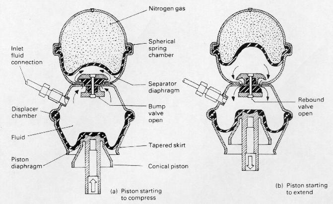

Asimo Posted May 26, 2015 Posted May 26, 2015 Just in case a picture helps. If there is less gas in the unit, when the car is on it's wheels the volume of gas will be smaller, the pressure won't be much different. When the wheel deflects the pressure rises much more quickly if the amount of gas present is too small, ruining the ride. The lower diaphragm is then subject to more stress certainly. The bottom diaphragm is also vulnerable if the height is wrong, ie not enough liquid or if the droop stops are missing. scruff 1

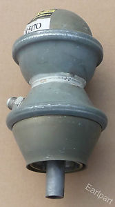

The Reverend Bluejeans Posted May 26, 2015 Posted May 26, 2015 Princess Ambastardor displacer versus MGF unit. The 'Cess one is the single new one. If they can be made to fit, you'd need to machine an extension tube as the MGF one looks like the operating rod is shorter - not beyond the wit of man. The MGF units were very good and represented a big step forward over the previous versions. PRINCESS HANDLING PACK YO
