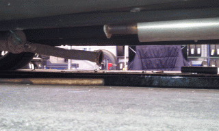

tooSavvy Posted February 1, 2015 Posted February 1, 2015 At 7yr, I think my CAT front section will pop sooner than later. This piccie is of a SAVVY cat , removed off fleebay scrapper, and above is a stock Clio [virtually the same]. Unobtanium (... on back order to Malaysia) £££ rate will likely apply to a dealer part. No one sells them. I plan to get NE Tyre & Exhaust to look into 'will a Clio fit?' and will they extend the tail pipe back to mate with the S/S I have on. Clio shops about £80, timax, bosal, walker or a half dozen others...... http://www.cats2u.co.uk/31145/Catalytic-Converter/RENAULT/CLIO/1.2 Problem with waiting for it to fail will be me off the road/recovered/gassed.... TS
michael1703 Posted February 1, 2015 Posted February 1, 2015 Euroflo sell handy joining sleeves, they are about 6-8 inches long with a split in them and a pair of clamps for about £8 Quite handy if the flanges don't join up http://www.euroflo.co.uk/ tooSavvy 1
