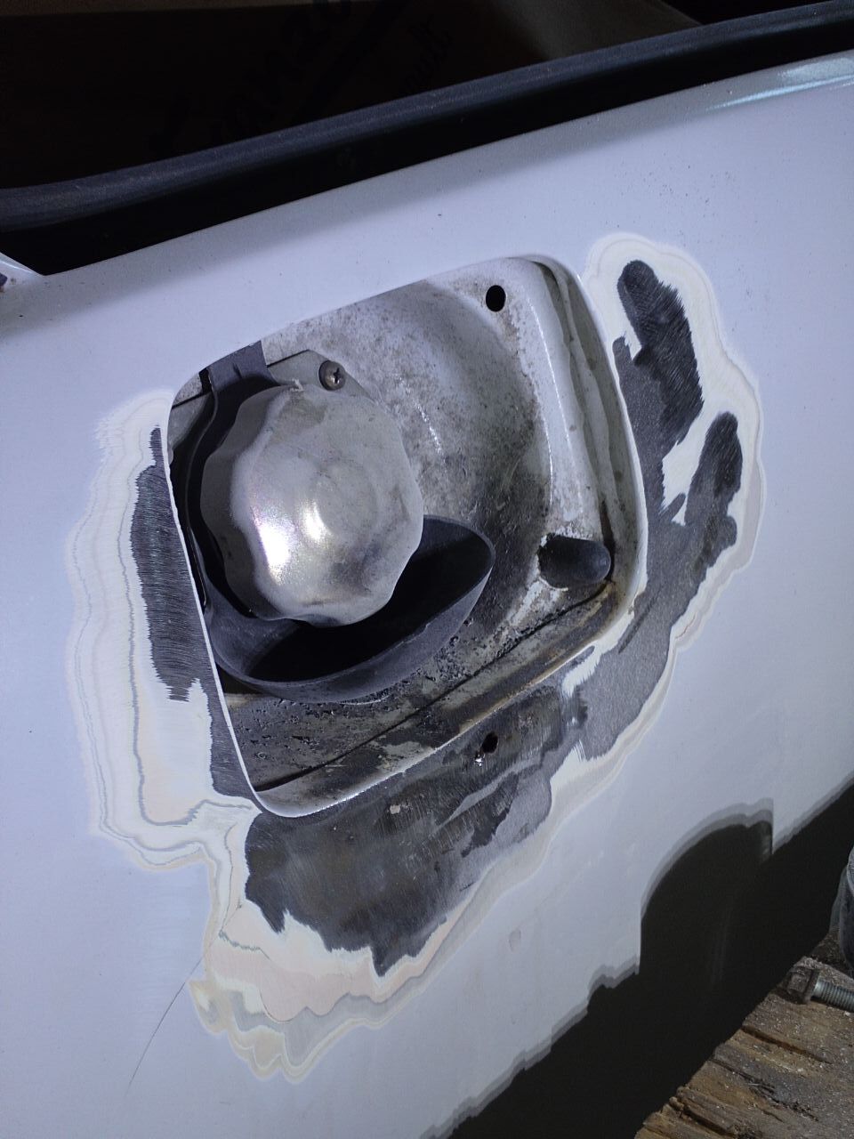

Today Ben ground off the filler on the front and rear wings. Underneath he found solid metal that had been brazed in:-
Front left floor will have to be fabricated and repaired though 20260224_110144900.JPG.e2b74cc0cb524f33e8669e1086a5fb92.JPG

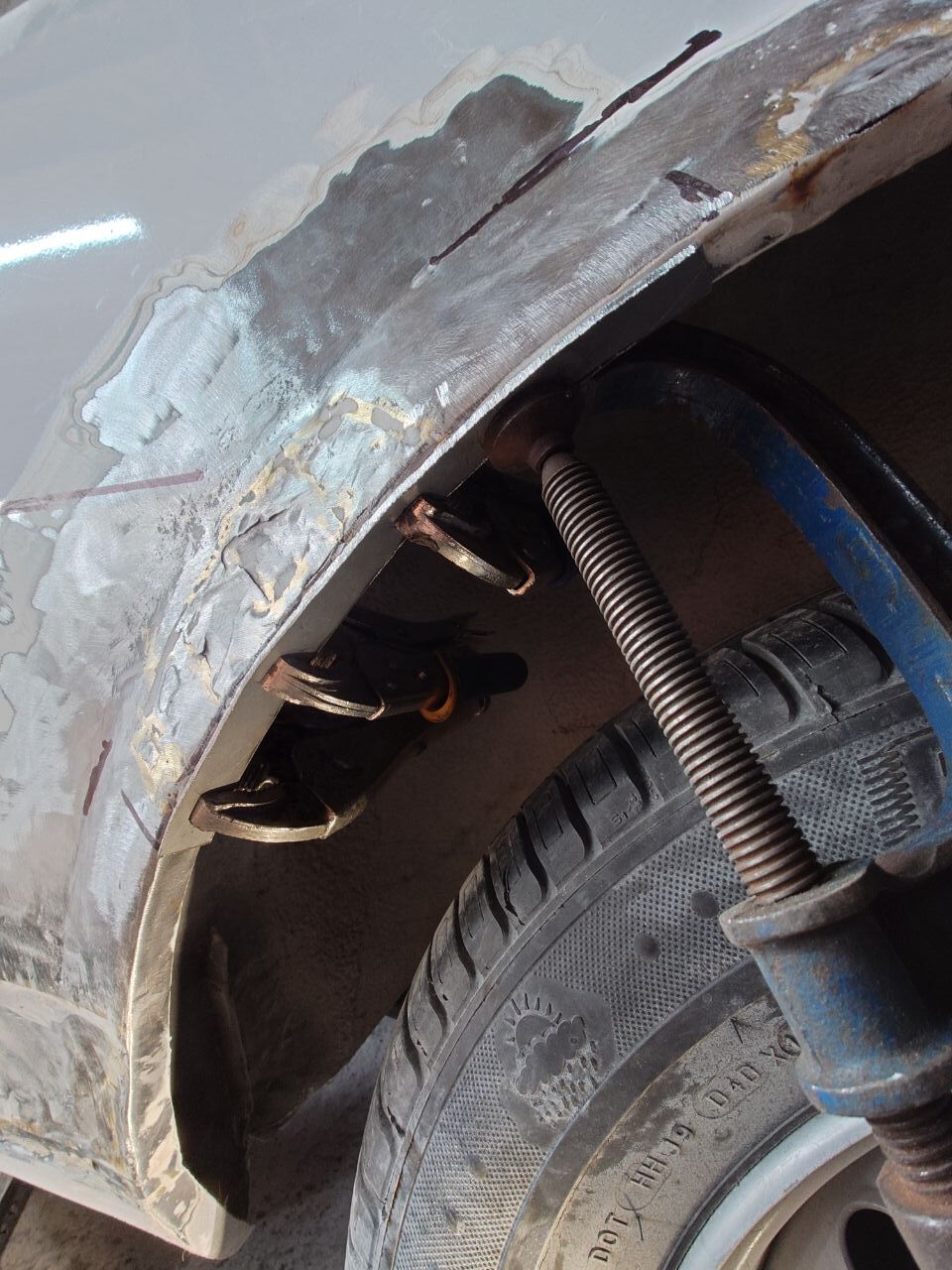

I had four goes at repairing the rear wheel arch this week.

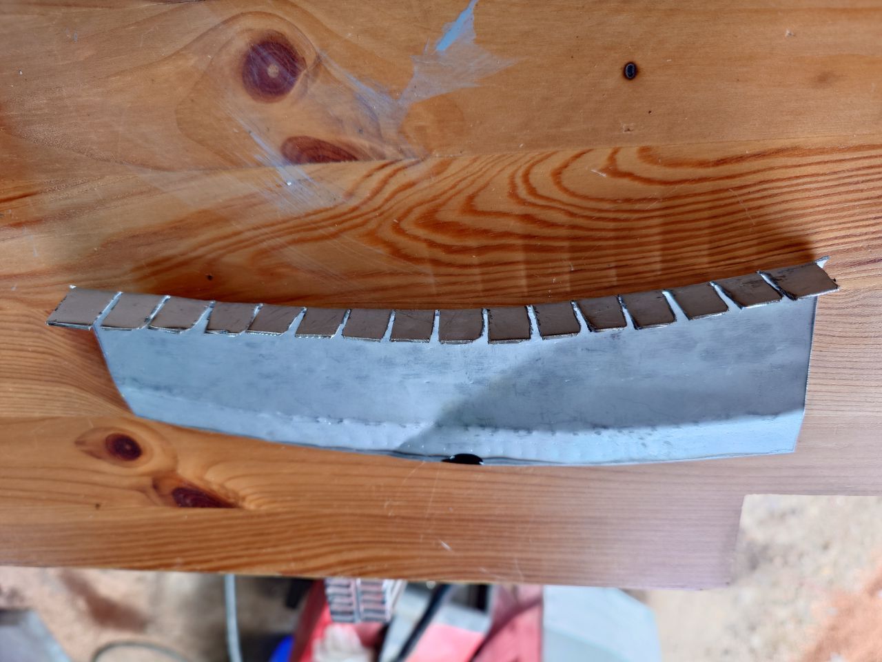

Attempt 1.
20260313_155213142.JPG.87382de0d797d4ddbb4b1e759c3de240.JPG20260313_162124037.JPG.763e57bf4383da914cad1357b931344c.JPG
I tried to weld a bead onto inside so that I could radius the outside. The problem is that my grinder just blew through the side of the thing.

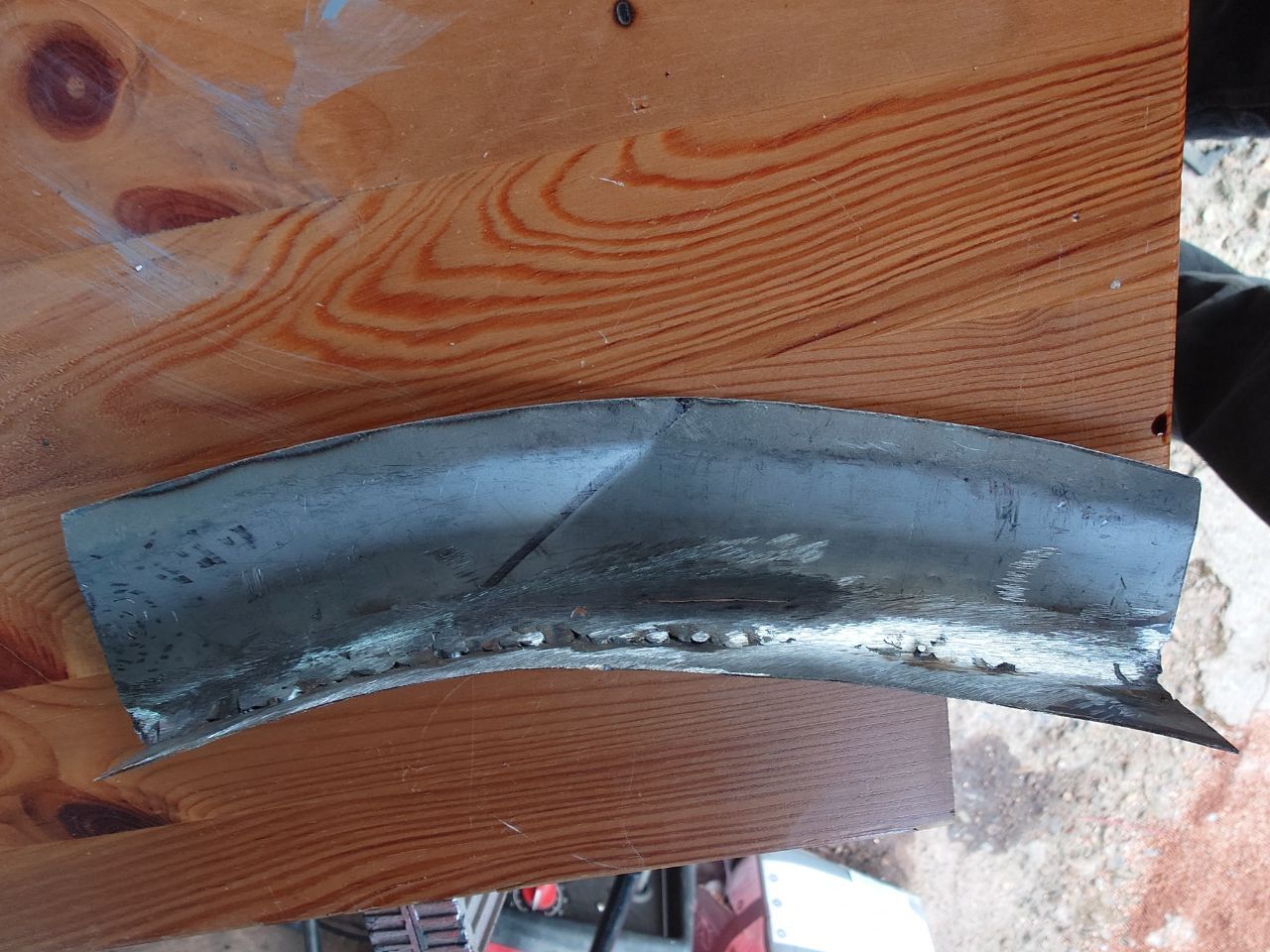

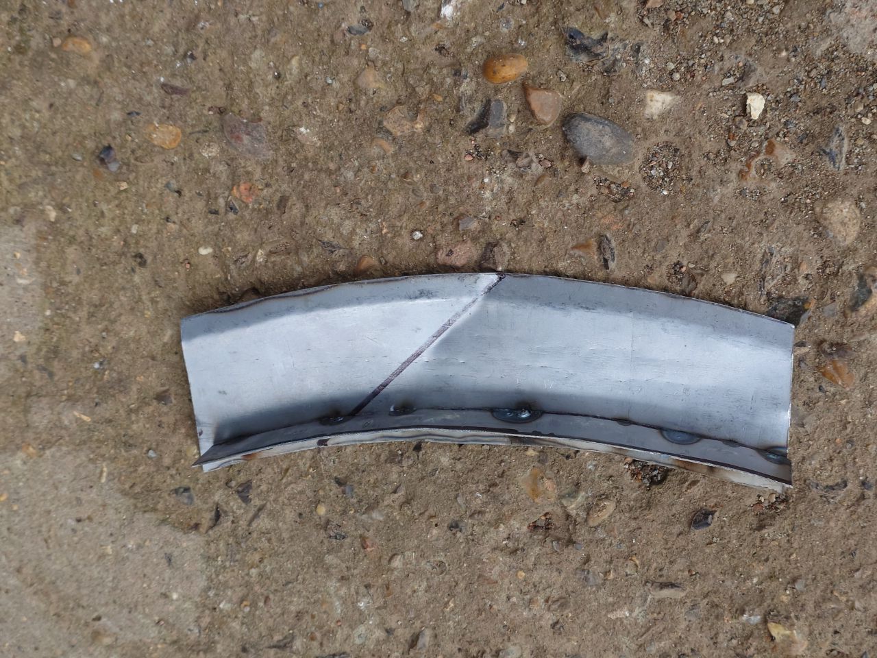

Attempt 2.
I welded all the tabs together but it bowed out away from the body line

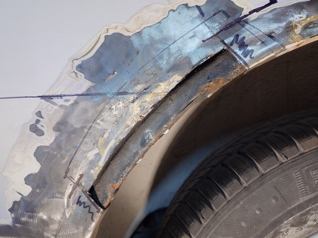

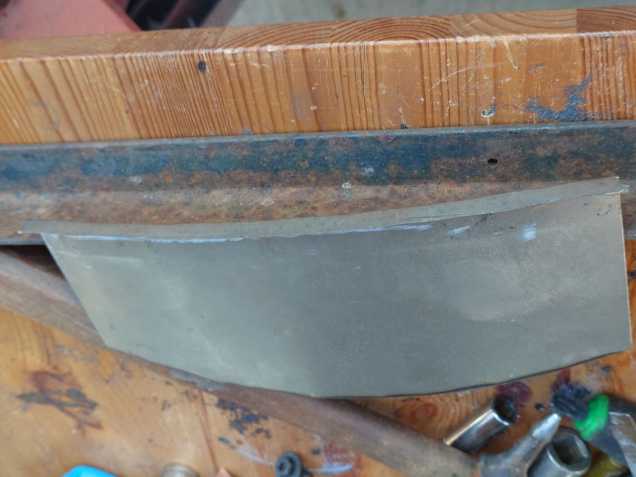

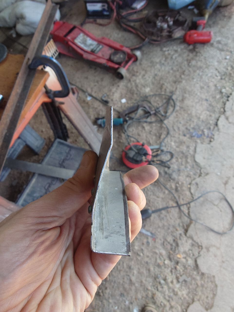

Attempt 4.
I found that a wide piece with a narrow corner could be still be bent.
20260318_161620946.JPG.c5b59e887502e3d6647131445a164f4e.JPG20260319_100903616.JPG.2894d78c2157175fd1de3a7f8c1ac4ab.JPG20260319_101132091.JPG.fc0dae774355ce855097a90ad142afa5.JPG

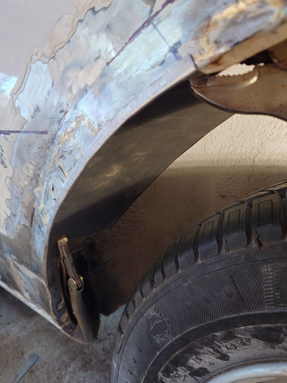

Time to swallow a brave pill
20260319_175306772.JPG.305956463ff11a754a702da6190407ed.JPG20260320_183812129.JPG.4f0af3fb79b300f0e8244ab311ffa6c6.JPG
