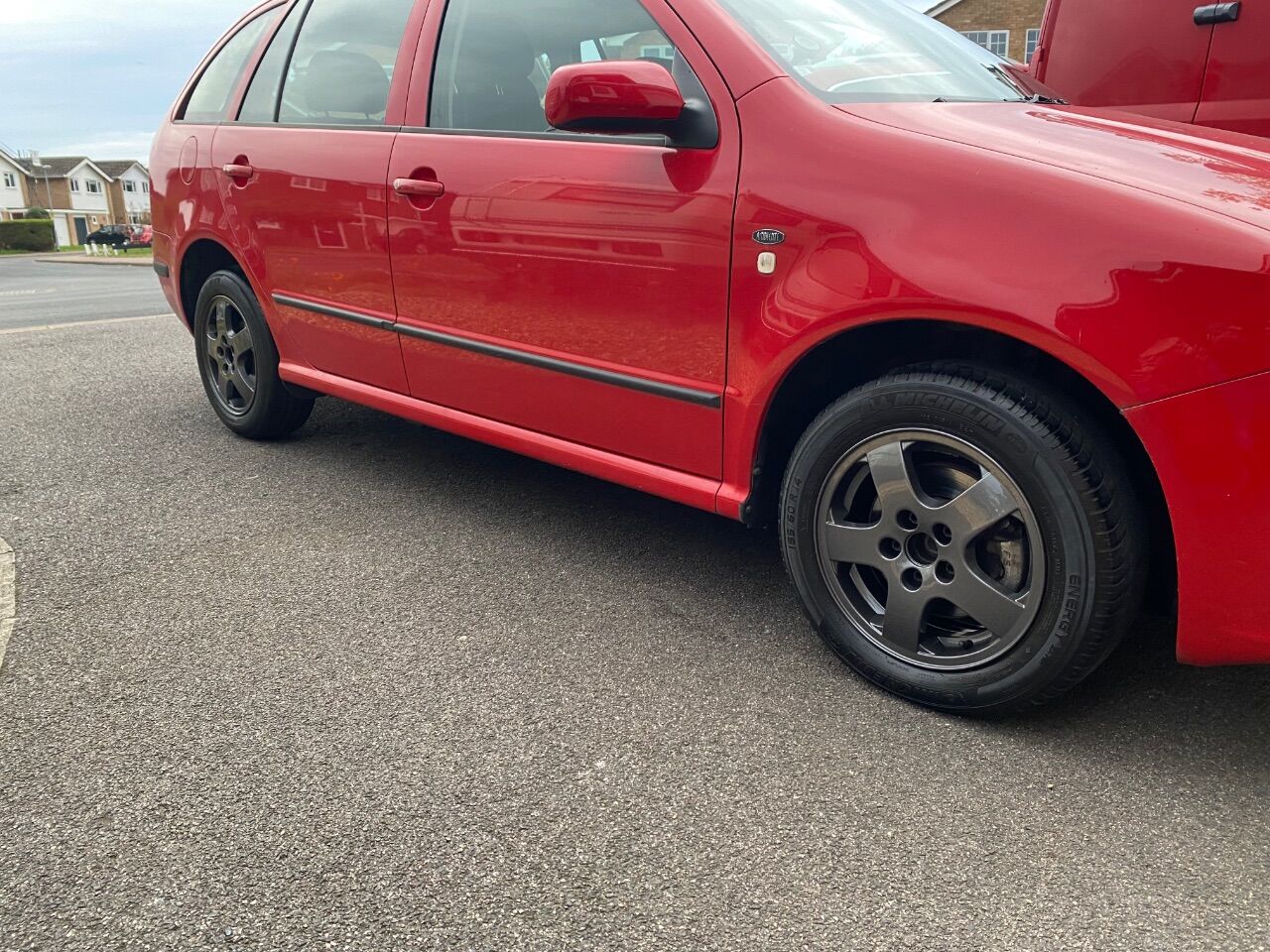

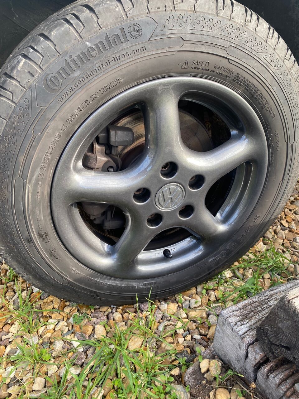

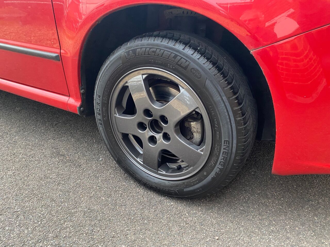

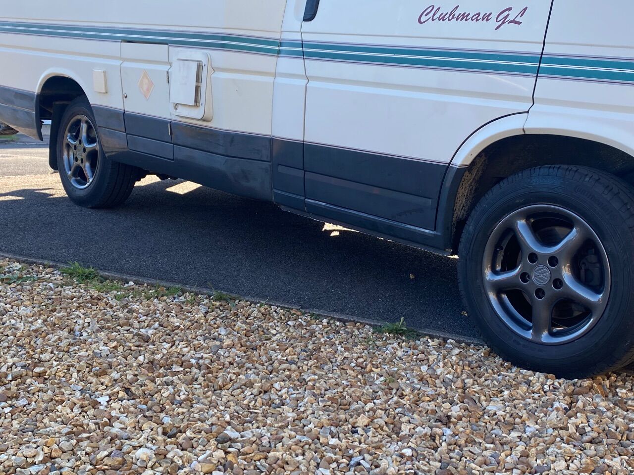

Had the alloy wheels, I bought earlier in the summer, powdercoated last week.  My nephew does it for a day job and has done both the VW wheels and the wifes Mazda6 wheels, as they’d started to suffer from laquer peel.  All done in a metallic graphite and look superb.  So good in fact, I took my Fabia alloys over this morning for the same treatment.
