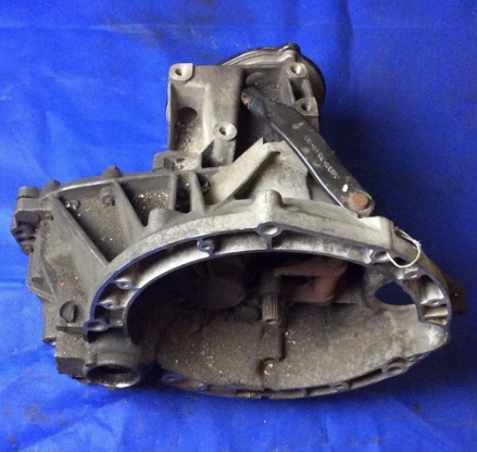

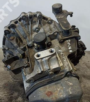

2 hours ago, 320touring said:
Re gearboxes, how do you identify them? Any advice re oil for them?
From a quick google fu.
IB5
Found a post with some info on them here. https://www.mg-rover.org/threads/general-gearbox-informations-regarding-rover-45-mk2-with-ford-getrag-ib5.875937/
R65 (earlier PSA based 'box), https://www.mg-rover.org/threads/r65-gearbox-what-oil-do-i-need.293792/
Hopefully that helps.
Cheers man that's useful. Given it's last year of production it's looking likely it's an IB5, will know for definite when underneath for a mooch about

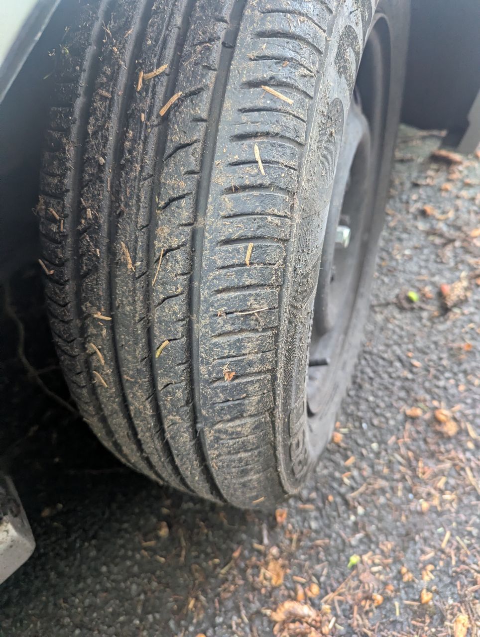

I decided to get in about this tub after work tonight.
First up, I did a light check - all good, which was great news, as I hate the contortion ritual of fitting bulbs.
Then it was time to check tyres.
First up, pull out the spare as it had plenty tread..
Nice!
Ehh, maybe not, it appears to be the original spare. Still holding air so will be suitable for it's original role.

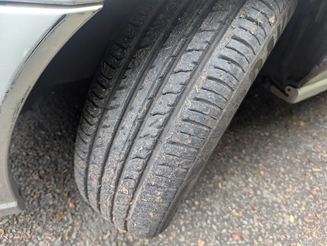

Right rear looks ok, 2018 dated, if getting a bit low on tread.
Right rear similar
But it looks a bit scabby on the sidewallPXL_20260518_171415136.jpg.aed9d84419ac05f6306c82cc4981dbf2.jpg
So I think 2 rear tyres may be in order & Likely just go with Part Worn.
Both fronts in grand condition (as they should be, being only a couple of years old)

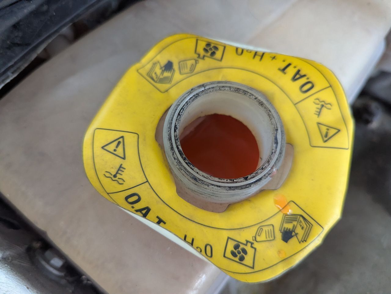

I then had a bit of a nosey round the engine bay - oil was clean and up to the max on the stick - so it can at least do one of the 3 shifts before a change.
Then the coolant check - up to the mark and pretty clean
And brake fluid

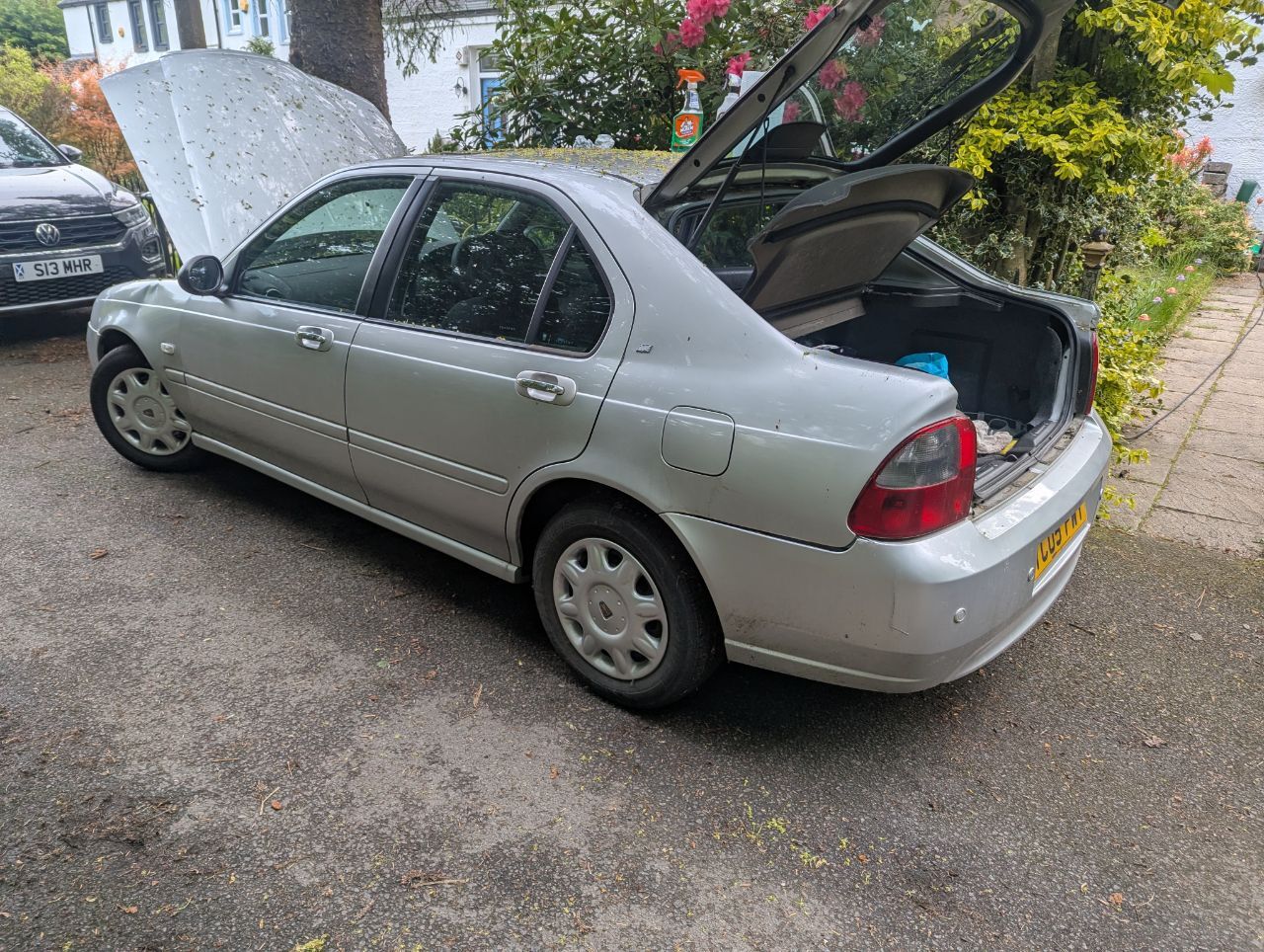

I decided to deploy stealth mode - essentially making it giffertastic again to minimise any "pull me " vibes.
Names removed
Hubcaps deployed
Headlamps given an initial pass to tidy them up

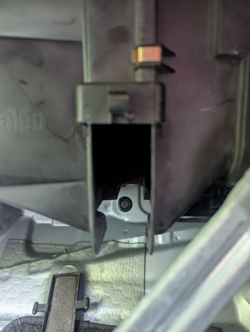

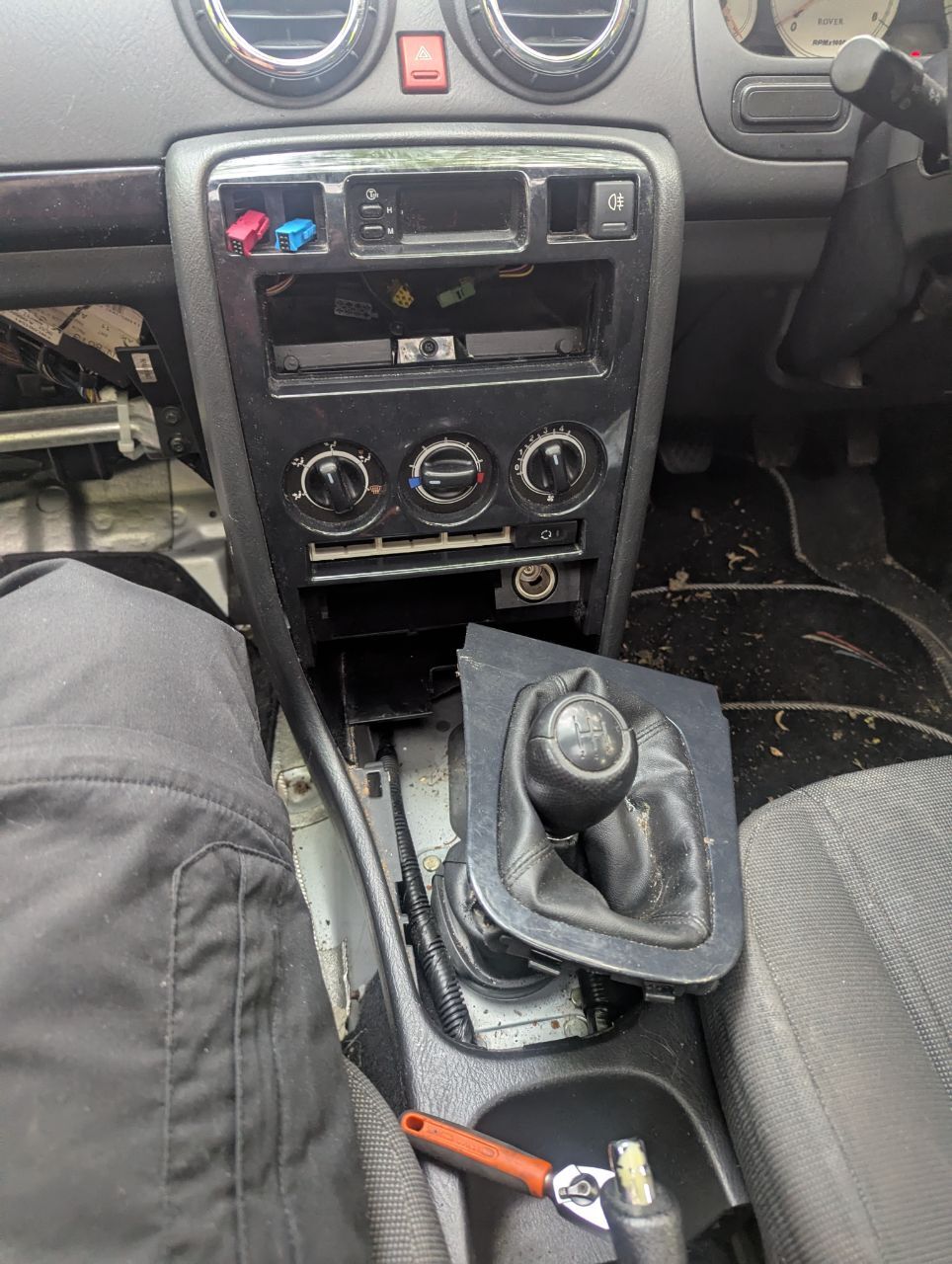

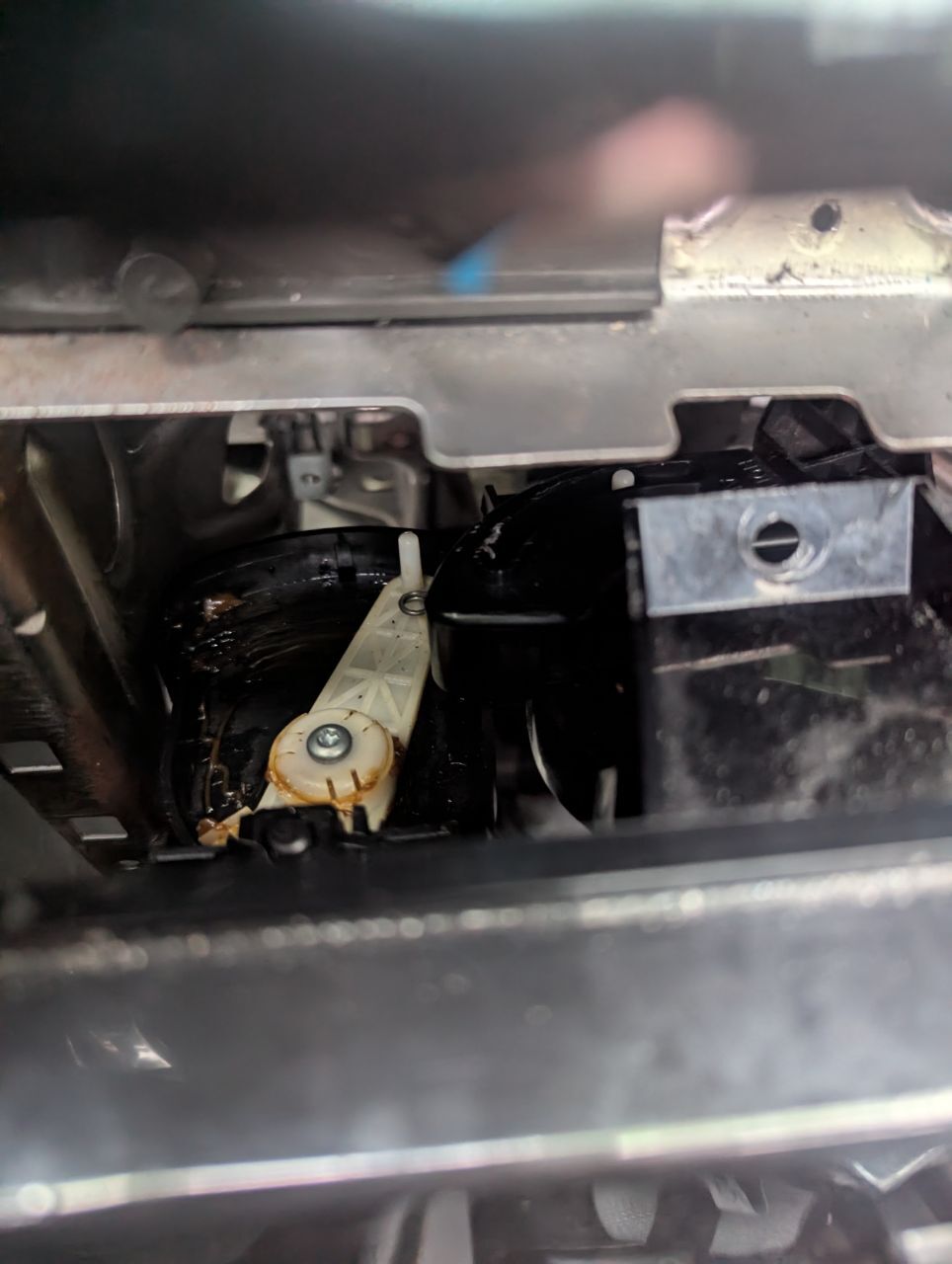

This done, I turned my attention to the important stuff-
Trying to fix the heating being stuck on hot.
Centre console out
Disconnected cable found ( on the direction control side but it moved with the heat dial? ( @RoverFolkUs @JMotor any suggestions?
I got it back on, but it hasn't changed anything. The direction selector doesn't seem great either.

Yes they are radio controls.  Had the whole centre console out to get the ECU out.   In short term if not replacing the radio, you can take the switch 12v from there.  I would cut plug off and then stick a socket in with inline fuse.
Hmmm.
Hard to tell. Are the cable outers secured in properly? Or have they been mixed up?
Truth be told, I've not needed to touch the heater controls on any of mine. My last 45 was a posh 'un with yon climate control panel thingy.

Couldn't really see too much. I've asked on the owners groups on FB to see if anyone can provide info.
Those do look like standard ISO plugs on the radio wiring though, so any* radio should* go in there with minimal* hassle.
