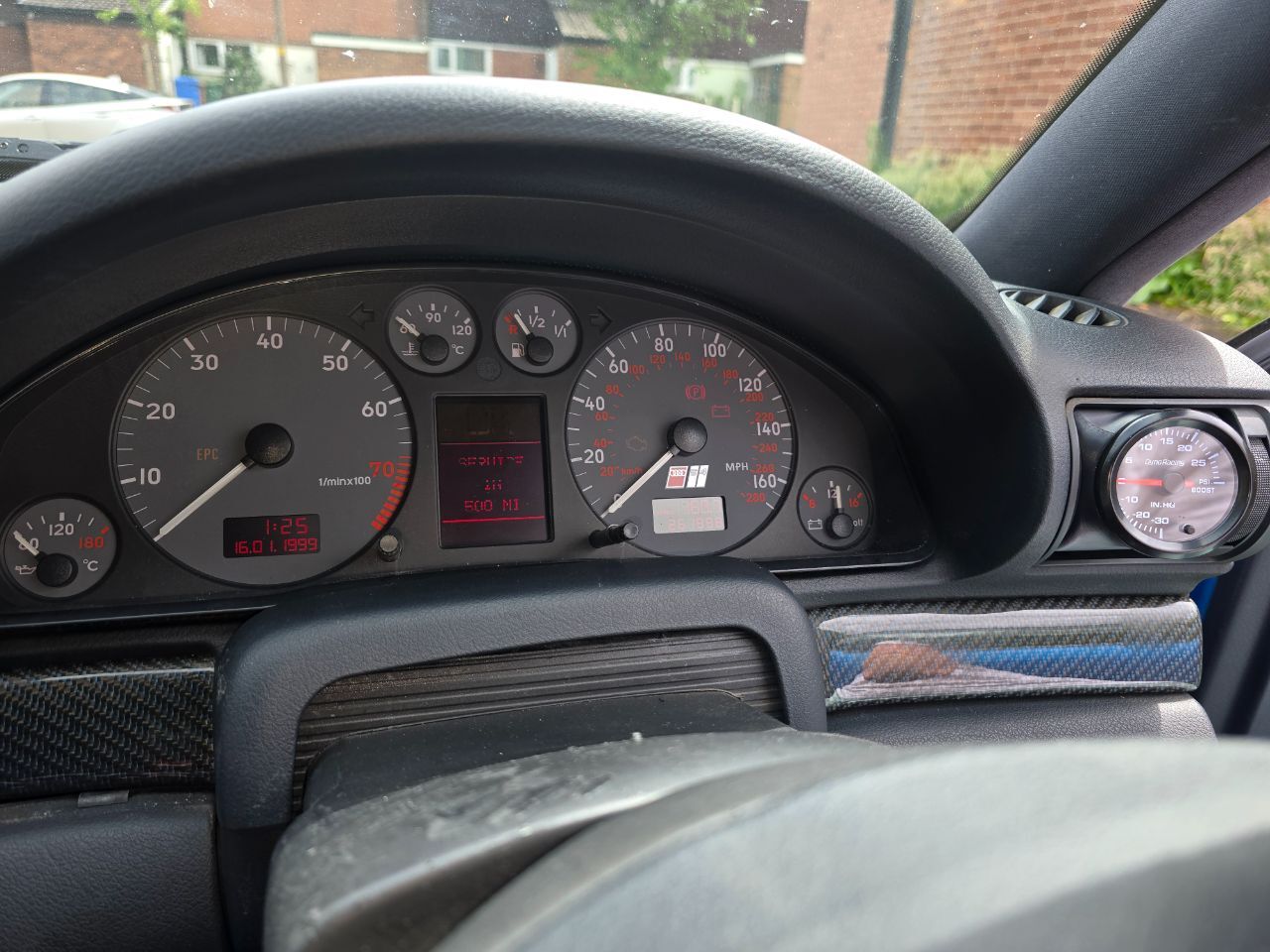

In other news, i have fitted a boost gauge which has helped diagnose a couple of things. On the dyno it showed the turbos only achieving 23 at redline however the boost gauge is showing 30... the turbos are working but the car isnt showing the boost and therefore the 2.5bar map sensor is wrong. I will upgrade this to a 4bar map sensor as i suspect this isnt helping. The other issue i can see of on the cam timing. Other than the VVT not activating at near redline the inlet cam is retarding to like -9 degrees from -3.5 degrees at idle. The outcome of that is the during the compression stroke the inlet valve will be open for a small time, obviously not good for power. Therefore there is probably a timing issue when the cambelt was done, the tensioner is heavily worn or the chain is stretching. We will get there eventually.20260530_120246.jpgScreenshot_20260523_212247_Gallery.jpg
