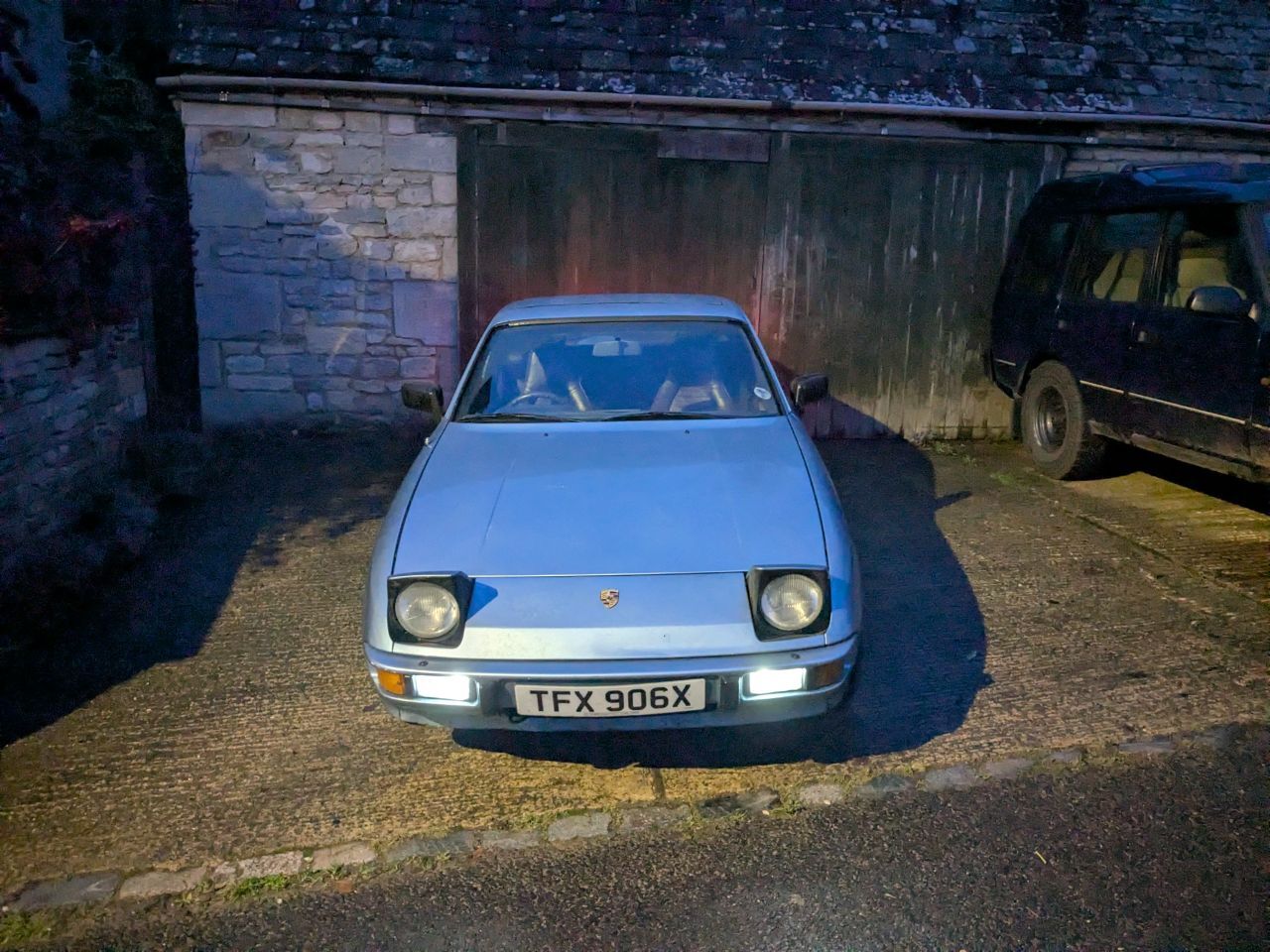

Re-fitted everything and re-installed the alternator, this time with a metal spacer rather than the exhaust bobbin - it was still allowing some wriggle and meant the belt gradually loosened itself and needed tightening. Right PITA.
Sleeving covers the bulkhead splice, so everything still looks factory, and all lights now behave as they should.

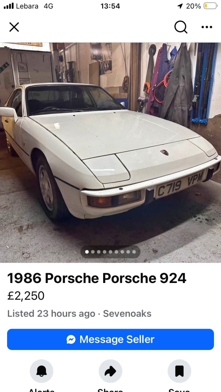

I’ve just seen a rot free one for sale locally on Facebook which is also an S and if I had a spare couple of grand and less than 6 motors (I only use 4 of them lol) it would be on the driveway, but I don’t use the current fleet much, so can’t justify getting it.
