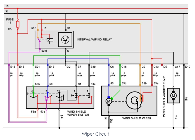

Do you have a schematic of the circuits involved to hand?  Might be possible to trace it out and see if there's anything which leaps out as a likely cause.   It sounds an odd fault, but with a schematic and figuring out the sequence of operations it should be possible to see where things are failing and to then point at likely causes.
Here's a schematic:
 Moving the column stalk to the “slow” position causes part B of the switch to feed power onto the wires coloured blue on the diagram, into terminal 53 of the wiper motor and out of terminal 31 from where it reaches earth via one of the crown of earth terminals behind the fusebox; the result is that the motor runs at slow speed. Moving the column switch to the “fast” position does almost the same thing, but this time part A of the switch feeds power onto the wires coloured green and into terminal 53b of the motor, causing it to run at high speed. You may have noticed that nothing so far has involved the relay, which doesn’t even need to be fitted or functional in order for the wipers to operate at either speed. That changes, however, when the rain stops and we turn the wipers off. The parking switch built into the motor now comes into play, and it connects terminals 53a and 31b on the motor together as long as the wipers are away from the parked position. This causes power to flow into the wires coloured orange on the diagram, through terminals 53S and 53M of the relay and into the wires coloured purple, through part B of the switch, onto the wires coloured blue and into the motor on terminal 53. The result is that the motor runs at the slow speed and keeps running until it reaches the parked position, when the switch opens and power is turned off, causing the motor to stop. Now we get to the really involved part! So far, the relay has done nothing but pass power straight through to allow the parking function to operate, and three of its pins have played no part in that process. Two of them are really only there to provide power and earth but the final one, labelled S, is what gives the system the ability to operate in intermittent mode and run the wipers while washing the screen. If you study the diagram, you will see that with the stalk in the “off”, “slow” or “fast” positions, part C of the switch provides an earth feed to part D. Assuming the washer switch is not being operated, this earth feed is passed onto pin S and the relay does nothing. If the stalk is moved into the “intermittent” position, however, pin S becomes disconnected. The electronic circuit inside the relay detects this and activates the relay contact, causing power to flow from pin 15 to pin 53M, through the purple coloured wires, part B of the switch, the blue coloured wires and into to pin 53 of the motor, which starts to run at slow speed. Very soon, however, the relay turns off again, which puts the system back into the parking mode described above. Power flows through the parking switch, the orange coloured wires, the relay, the purple coloured wires, part B of the switch and the blue coloured wires to continue to run the motor until the parking switch opens. As long as the column stalk remains in the “intermittent” position, this whole cycle will repeat every ten seconds or so. Finally, if the stalk is pulled back to activate the washers, two things happen. First, part E of the switch feeds power out of terminal 53c, through the fusebox and out to the washer pump, causing it to run as long as the stalk is held back. Secondly, power is fed through part D of the switch to terminal S of the relay, putting it into “wash/wipe” mode, where it closes, causing the wiper motor to run at slow speed in the same way as in intermittent mode. This time, however, the relay stays closed until the stalk has been released for a few seconds, and the system then goes back into parking mode.
Sadly I'm not clever enough to figure out what the problem could be 🤯

15 hours ago, N Dentressangle said:
Here's a schematic:
Honestly - I had read that about 5 times so far and it is astill as clear as mud why the intermittant wiper still doesn't work - think I need a couple of bottles of red wine downed before I read it again, might make more sense!!!

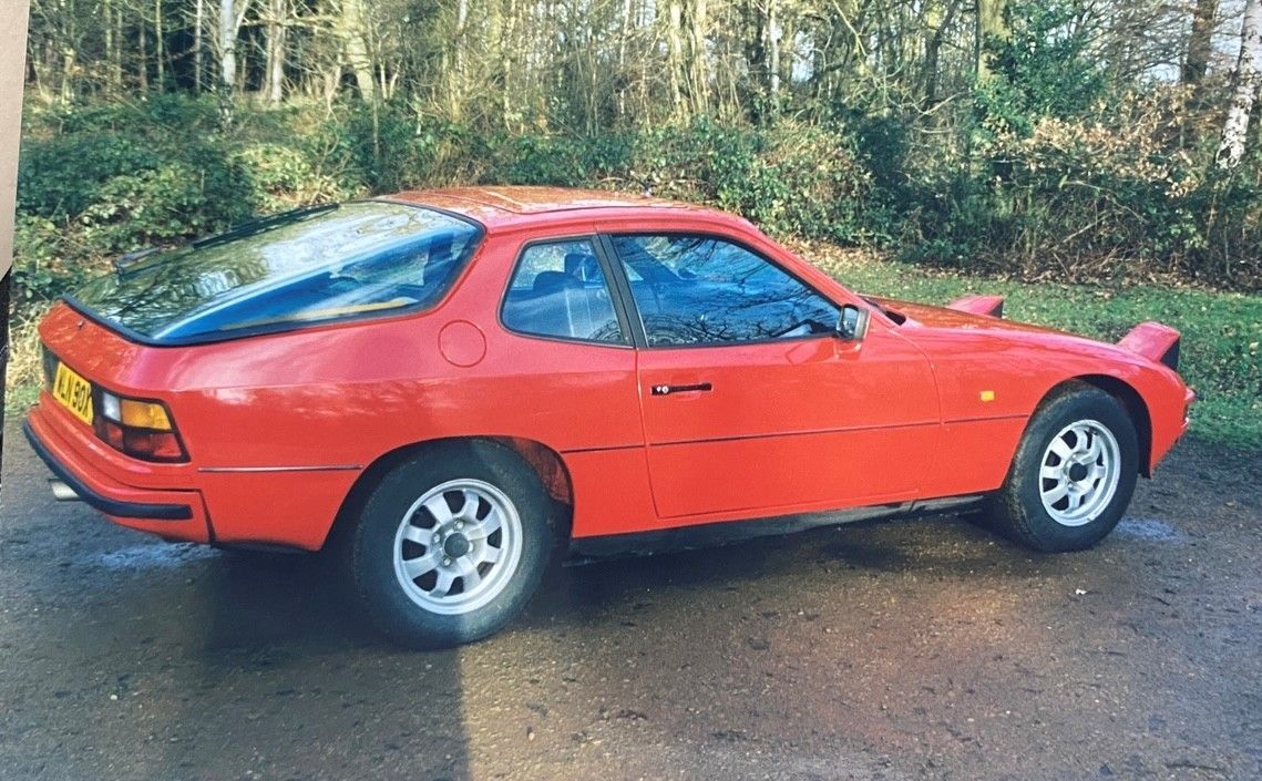

Whether chicks dig mouldy old 924s in 2025 is debatable. However, back in the early 1990s, when I was about 19 and lived in west London, I had a Guards Red 924 and I can confirm that it did not have an adverse effect on my sex life. Admittedly, I had a full head of hair and was much better looking back then.
