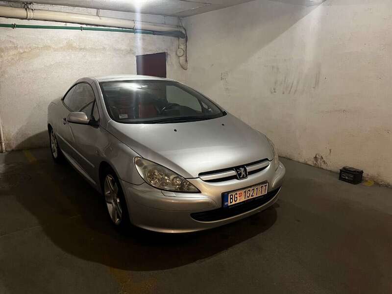

Went for a drive in CC today. Roof went up. Roof went down. Roof tried to go up. Tailgate went up. I was greeted with the sound of low hydraulic pressure. Roof got stuck. Took me 15 minutes to nurse it back down with leftover pressure in the system.
Because that’s not annoying enough, aftermarket parking sensors also packed up tonight. Putting the car in reverse results in a long beeeeeeeeeeeep. All seem to be fine visually, so one of them must’ve shat itself. Annoyingly I can’t even get it to shut up until I buy new one, the control unit is accessible only when roof is in service position.
This really does not bode well for this car, and I need to talk to missus about it. I can’t imagine roof repair on it being under 4 figures, and it’s a car we paid 2 grand for, doesn’t have a straight panel, has absolutely shot shocks and is burning or leaking oil somewhere. It might be time to cut the losses and get some other cabrio.
Negatives of another cabrio are that it’s equally old, equally finicky system that could pack up in a week, month or a year, and we’d be back to square 1. Maybe it’s better to fix and live with a devil you know at this end of a market?

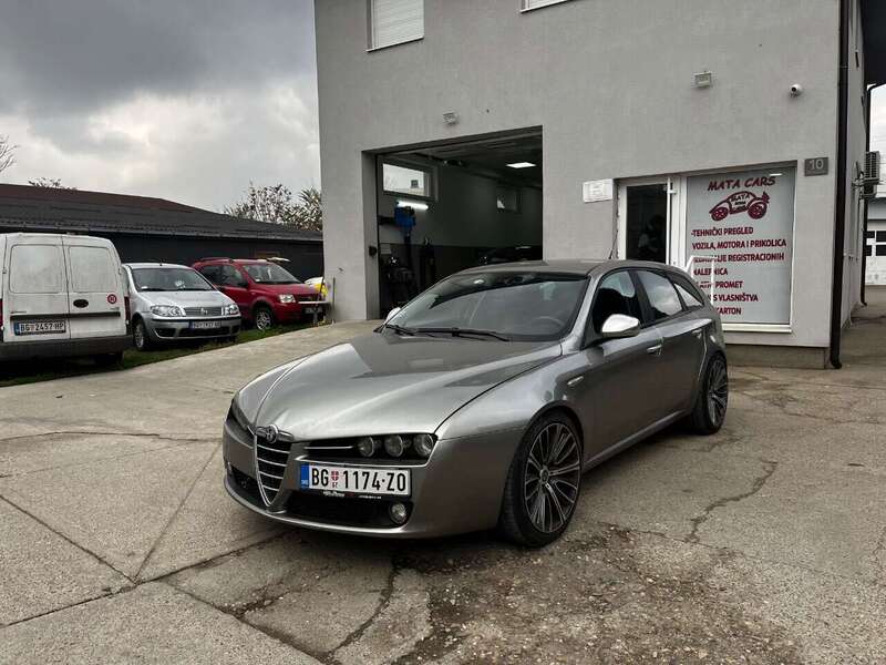

2007 Alfa Romeo 159 SW, 1.9 JTDM 16v Lusso
Here is the one that belonged to Mrs Grogee. It didn't shit itself quite so regularly as yours, but I drove it like a nun. Mrs Grogee drove it like her trousers were on fire.
I got fed up with it chewing through front tyres despite me replacing all the suspension, then there was a minor running issue that was the last straw - not sure what it was but it started idling a bit rough and economy dropped.
I did pamper it, but I got annoyed with it being such a primadonna and wanting parts that were expensive because they only fitted the 159 and nothing else.
A beautiful car no doubt. I got fed up with only one cup holder so I fitted another where centre air vent was.

It is a really good car, despite all the niggly things. 500k km is a testament to this.
Cup holders are absolute insanity, don't know what's the deal with Alfa Romeo and cup holders. 156 has none. I know that espresso is to be downed in a single sip in Italy, but surely they need water as well?
Thanks! I hope I'll have it for the next summer. There's really not too much left to get it done, and I know I've probably just jinxed it. 😄

After sitting at a specialist for what seemed like a half of eternity, I got a message two weeks ago:
Possibly the only three dry hydraulic pistons in the country. Just arrived.
Oh okay, go on then. About to be fixed, right?
Radio silence. Not picking up the phone either. I kinda gave up, shrugged, and thought “he’ll just get it done eventually”.
So I was really shocked when I saw the phone ringing yesterday as I was having lunch!
- Hey man! Look, one of those was duff so I was waiting for another parts car to show up. Got them swapped, poured in the right oil, all the jazz. Works really quick now and no leaks, I’m very happy with it now.
- Good to be picked up?
- Nah, let’s leave it overnight and I’ll give it a few more tries tomorrow to see if everything is dry. I’ll call you tomorrow morning.
- Amazing man! How much?
- No idea, let’s see if it leaks first.
I half expected not to get a call today because something happened. However.
- Come pick it up, it’s ready. No leaks, nothing’s squeaking.
- Oh, okay, wow! That’s good to hear.
- Yeah, finally got good pistons.
- How much?
- Oh….yeah…that….erm….I can’t really charge normal rates great mates of my great mates, and I wouldn’t touch this with 6ft pole if you weren’t his friend because these pistons are always fucking leaky and impossible to source. Bring me *sum that makes no sense for the amount of work and I shouldn’t disclose*
- …..you’re kidding? No come on, I want to pay proper, not mates rates.
- No seriously, I’m not taking a penny more. I’ll buy it off you when you finally decide to sell, I told you already. Come pick it up!
Turns out that he spent most of the time car was sitting with him waiting to assemble a working set of hydraulic pistons. He knows every single PSA breaker in the country, and they all know he knows his shit and are friends with him, so instead of sending ones that don’t leak a lot, they found a set that doesn’t leak at all. There was a leak on the pump reservoir as well, so that got patched up as well.
He thinks that car overall is a peach save a leaky rear shocks and injectors, and is serious about buying it off me. Also I think it drives better than when I left it with him, but he didn’t mention touching the engine, so 🤷‍♂️
And so, 307CC came home.

Technical inspection day for 159. Passed it m9!
Obligatory pre inspection fuckery - one of the blown bulbs wasn’t (just) a bulb. Plate bulb holder burned out. 🤦‍♂️ Replaced today at 11:45 with another off scrappers, with inspection booked at noon.
*missing photo of an awful, rushed, twist and insulation tape job here*
Yeah, that’ll be revisited with soldering iron and heatshrink.
