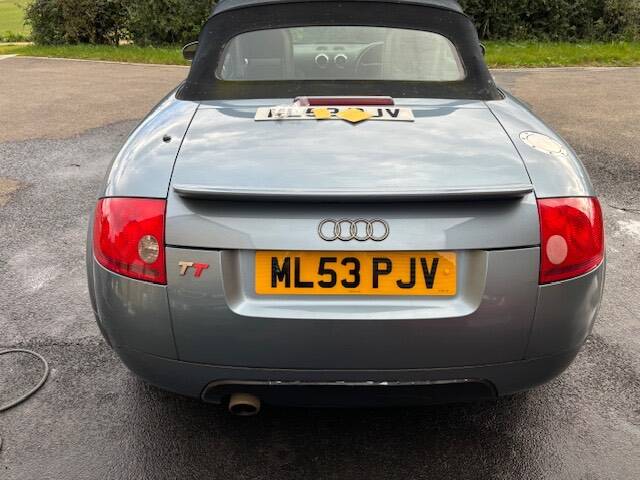

I really need to crack on with cleaning this up.
Current job list:
LCD display on the cluster has loads of missing lines. TADTS and there’s a few firms out there that can fix them. I contacted one and they made the right noises but wouldn’t give me an answer to “how do you want paying and where do I send it to” so I’m looking for another at the moment. Might just go with one on eBay.
Starter motor keeps running after the engine starts, sticky solenoid I guess. Need to remove it to make sure I order the right replacement - might strip it down and clean it up before I order new.
Secondary air pump is noisy. Could either replace it for about £30 or repair it with some bolts and washers, not sure which I’ll do yet.
Aerial is broken. Seems they’re quite expensive 🤦‍♂️
TT badge is missing a T - thinking about just debadging it because they are NLA and £60 on eBay - thoughts?
Back box is blowing - replacement required I guess.
Rear diffuser needs painting.
Don’t want to go too mad with it - it’s a cheap old base model TT after all!

One red T is faster right... (E.g. Golf red TDI)! Often a question on the FB group asking what the one red T means. Looks stock!
