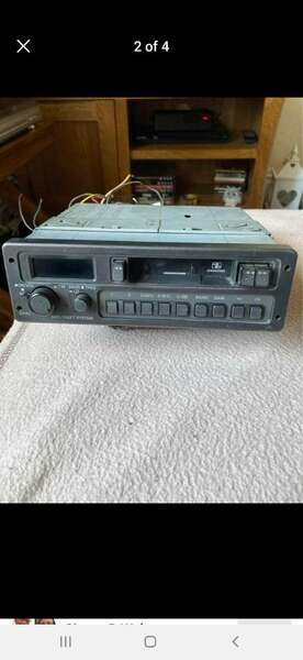

I know you're not going for originality,  but thought I'd share these photos from a local ad for this GENUINE CLASSIC RANGE ROVER radio cassette:
Dunno if it works like.

You seen how much people ask for that kind of stuff?
The wireless hole on an RRC is really shallow, and any messy bollockry with the wiring means it don't fit proper like. I'll probably pick up a nasty cheapo like this just to listen to the radio: https://www.ebay.co.uk/itm/283924193821?mkcid=16&mkevt=1&mkrid=711-127632-2357-0&ssspo=V68PLFIERvu&sssrc=2047675&ssuid=3fVYaSNwS9a&widget_ver=artemis&media=COPY
In this case the asking price is twenty quid. I’ll gladly pick it up if there’s a drink in it.
