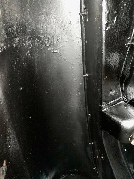

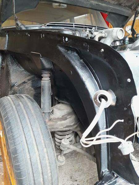

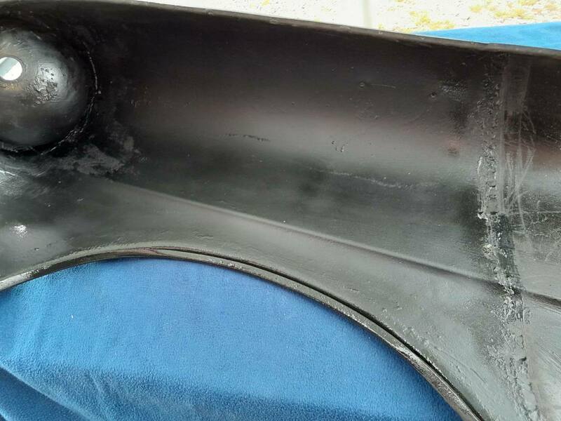

Dyslexic Viking Posted September 5, 2022 Author Share Posted September 5, 2022 Fortunately, I have had the opportunity to prioritize work on this now so I have had 4 full days of work done. Today it was 9 hours and I am tired. I have done bodywork and most work on the front wings and the bodywork behind them. I had to weld 2 points but I haven't got the 0.6 thread yet so I used what I had. And it's been a few years since I welded on a car and this was a reminder of how bad I am at this and I'll probably never be good at welding. But I got the rust cut away and got the hole sealed without any horrible bodgeds and that's the most important thing. Also had a lot of gravel scraped off and all places with rust were treated and then painted and then all the areas that get a lot of wear were covered in a wax product that I have used for a long time and have good experience with for extra protection. And this was the result after all that. And today I had the front wings put back on and it was started and driven out of the garage and parked under a roof outside. Because tomorrow starts the next big job wich is to take out the interior and inspect the floor. It also turns out that the glow plugs are still not working. privatewire, Jim Bell, LabRat and 28 others 31 Link to comment Share on other sites More sharing options...

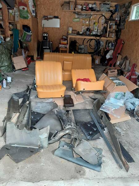

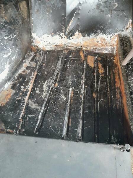

Dyslexic Viking Posted September 6, 2022 Author Share Posted September 6, 2022 Worked today on the interior, the goal is to remove all the sound dampening mats to look for rust and remove all of the old mats and sound dampening mats as this has a bad smell inside which I don't like. First, most of the interior came out. And under this shelf below, which is between the front seats, I found a Norwegian 25 øre coin from 1965. And the backside of the coin has a picture of what I believe to be King Olav 1903-1991. And this is what it looked like inside after everything was removed. And then I started tearing out mats and scraping away the glued sound deadening mats and as I suspected I started to find rust under them. Haven't found any serious rust yet just surface rust luckily. But there are a lot of glued sound dampening mats in this one and they are thick so I have at least 1 more full day of scraping and the smell inside has already improved. And this is what I removed from the car today. juular, mat_the_cat, Popsicle and 20 others 23 Link to comment Share on other sites More sharing options...

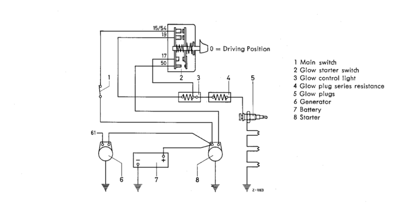

Dyslexic Viking Posted September 9, 2022 Author Share Posted September 9, 2022 There will be an update tomorrow on the removal of sound dampening mats on this. But now I read up on the glow system on these and came across parts of a manual online which is possibly intended for marine versions of these engines, but it is probably very similar to this one and there is a lot of useful information here. And these are wonderfully simple compared to the nightmare vehicles made in recent decades. But my head doesn't like things like this, so it will probably take some time before I learn something. But if any of you need something to help you fall asleep, I attach a link to the manual. https://www.marinedieselbasics.com/wp-content/uploads/edd/Mercedes-OM636-621-Preheating.pdf Mr Pastry, Shite Ron, CreepingJesus and 7 others 10 Link to comment Share on other sites More sharing options...

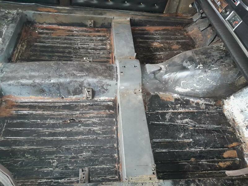

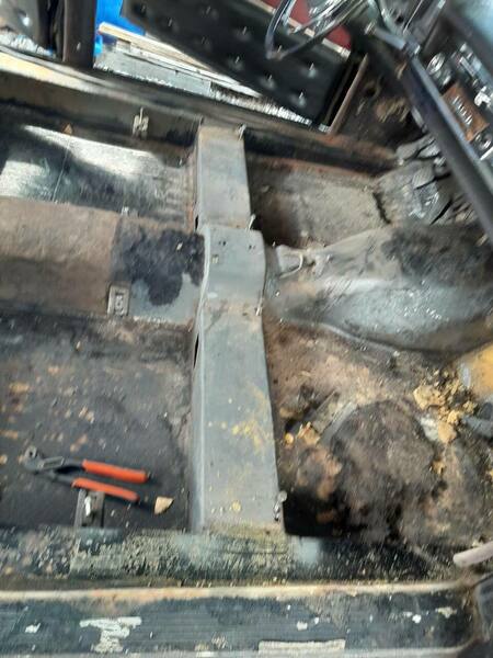

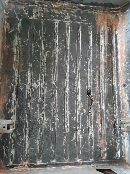

Dyslexic Viking Posted September 10, 2022 Author Share Posted September 10, 2022 I now have spent all free time since Wednesday removing sound dampening mats. Even with electric tools, this took a long time and was a shit job. But it was worth it as I discovered a lot of surface rust, several old welding repairs and 2 rust holes that need to be repaired. This is how the floor looks now. And i start on the floor by the driver's seat, this has a small hole that is difficult to see in the picture, so I have made a circle around it. It also has a patch at the very back end of the floor And it is also clear that the floor here has been changed several times and it is clear where new floors has been welded in at least 2 places have marked them by arrows The floor behind the driver's seat has also been replaced atleast once and has also received another repair after this, which is at the bottom of the picture on the right. And then there is the passenger side. This side has clearly not received many repairs and the floor in front is solid. But the floor behind this has the biggest rust hole that I don't understand that I haven't discovered before. So it is clear that this car is anything but untouched and is really well used, but given its age and history and use, this is not bad. Now it remains to fix the 2 rust holes and the floor on both sides should probably have been completely replaced, but I don't have the ability to do that and I can't afford it either. But after fixing those holes and treating the rust and painting the floor, it will probably and hopefully last for many more years before it has to be fixed again.. Shite Ron, busmansholiday, Tickman and 26 others 29 Link to comment Share on other sites More sharing options...

busmansholiday Posted September 11, 2022 Share Posted September 11, 2022 On 9/9/2022 at 8:18 PM, Dyslexic Viking said: There will be an update tomorrow on the removal of sound dampening mats on this. But now I read up on the glow system on these and came across parts of a manual online which is possibly intended for marine versions of these engines, but it is probably very similar to this one and there is a lot of useful information here. And these are wonderfully simple compared to the nightmare vehicles made in recent decades. But my head doesn't like things like this, so it will probably take some time before I learn something. But if any of you need something to help you fall asleep, I attach a link to the manual. https://www.marinedieselbasics.com/wp-content/uploads/edd/Mercedes-OM636-621-Preheating.pdf I've been looking at that diagram for ages and think I now understand how it's supposed to work. The main switch (ignition key ?) connects power from the battery to pins 15/54 on the glow starter switch. When you activate (pull) the switch it connects power to pin 19 then to the glow warning light, the inline ballast resister and the glow plugs. If any of those are faulty the light doesn't come on, unless there's a short somewhere in the system (deliberate or accidental). Now here's my understanding of the clever bit because at the same time as you connect up the glow plugs you also connect pins 17 and 50 together which should pull in the starter motor internal relay to turn over the engine as the supply for 17 is from the glow plug warning light. The warning light isn't a bulb though, it's a wire, a wire that heats up when power (12v) is applied. As a wire heats up its resistance increases, so I think what happens is that initially all the power heats the warning light (which heats the glow plugs) then as it's resistance increases it gets to a point where the power finds it easier to get to earth via the relay for the starter motor and therefore turns over the engine. By then the glow plugs are warm and bingo. Obviously there should be a delay when you pull the starter before the engine starts. If it's instant somebody has been messing with the wiring to bypass the glow system. Hope this helps (and is correct). Dyslexic Viking 1 Link to comment Share on other sites More sharing options...
Mr Pastry Posted September 11, 2022 Share Posted September 11, 2022 My interpretation is that the glow starter switch works in two stages. When first pushed, 19 and 15/54 are connected which activates the glow plugs via the series resistor and warning light. When you think the plugs are hot enough you push the switch in further, and that connects 17 and 50 to operate the starter and as said, that effectively shorts out the glow plugs through the starter solenoid. CreepingJesus, Dyslexic Viking and chodweaver 3 Link to comment Share on other sites More sharing options...
busmansholiday Posted September 11, 2022 Share Posted September 11, 2022 25 minutes ago, Mr Pastry said: My interpretation is that the glow starter switch works in two stages. When first pushed, 19 and 15/54 are connected which activates the glow plugs via the series resistor and warning light. When you think the plugs are hot enough you push the switch in further, and that connects 17 and 50 to operate the starter and as said, that effectively shorts out the glow plugs through the starter solenoid. I think that's a better description than mine as looking again it appears there are bigger gaps between 17 and 50 suggesting a two stage operation as you described. Link to comment Share on other sites More sharing options...
Dyslexic Viking Posted September 11, 2022 Author Share Posted September 11, 2022 Thank you both. These are started with a knob that you pull out of the dashboard. One pull it out and holds it in position 2 to light the glow plugs. And if you pull it even further out to position 3, you engage the starter. When you then release it, it goes to position 1, which is the engine running, and when you will switch it off, then press it to position 0. Knob marked below. And a bad drawing to demonstrate how it works. I'll start troubleshooting the glow plugs as soon as I have time. I also have to try to figure out what is wrong with the clutch. CreepingJesus, Shite Ron and privatewire 3 Link to comment Share on other sites More sharing options...
