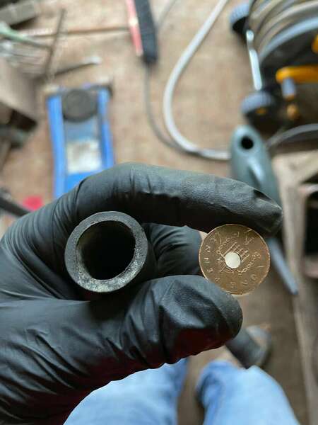

sutty2006 Posted February 2, 2023 Author Share Posted February 2, 2023 Some progress made this morning. I have put a restriction in the inlet pipe to the ICV. Cost of said temporary fix? 1p 3mm hole drilled through it. and inserted into the pipe. Nice an snug. refitted to the car, first cold start and the idle is a little low. (But no longer 3500…. (Lighting box light on because I hadn’t woke the charger whirler up yet), but that was about 550rpm. Too low. so out came the coin, and a 5mm hole drilled through. (I can’t find a 4mm bit, but I’ve plenty of 1p’s to go at) and I slightly higher idle of 900. I’m happy with that for now. It runs and drives again. now to replace the speedo drive. Tickman, adw1977, danthecapriman and 13 others 16 Link to comment Share on other sites More sharing options...

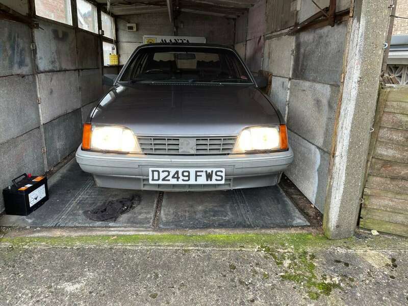

sutty2006 Posted February 10, 2023 Author Share Posted February 10, 2023 While demolition work starts at home, the Carlton seeks refuge in a garage round the corner. That’s the furthest I’ve driven it so far, about 200 yards. May need to replace the tyres despite being new in 2008 and still has the nobbles and tyre slip on them….. they might be 50p shaped. Only a true drive at speed will confirm. CreepingJesus, AnnoyingPentium, Shite Ron and 7 others 10 Link to comment Share on other sites More sharing options...
