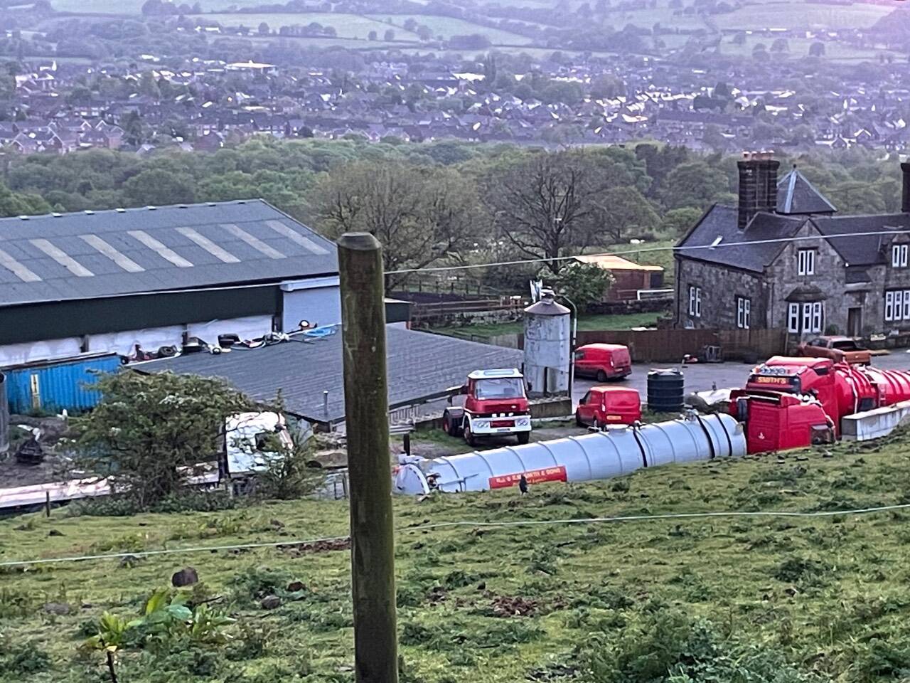

but what’s that down there I hear you scream!
awww, an old ERF truck!
I got a lot closer to that truck, in that location, in 2021:
