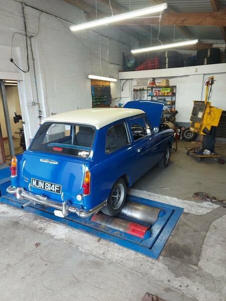

Matty Posted March 10, 2022 Author Share Posted March 10, 2022 UPDATE TIME Well, it now works! I'm not exactly a person flush with time so progress has been painfully slow. Checked tappets (nowt to adjust, they were Bob on. Only the difference between my idea of a feel on the gauge and the other fellas and when your at that stage there's nowt to adjust). Checked points. Ditto. @SiC red rotor arm present. Checked plug gaps, again feck all. Did a flow test on fuel pump at the carb. 3 quarters of a litre a min. Plenty. Now I wasn't in a rush (call me a nancy) to take a precious days holiday and try to arrive at a combination of carb components and settings using the seat of my pants. So today this happened N Dentressangle, SiC, Twiggy and 9 others 12 Link to comment Share on other sites More sharing options...

Matty Posted March 10, 2022 Author Share Posted March 10, 2022 It is and tbf it highlighted why trying to do it myself was a waste of time. The engines quite a way from standard. I'd timed it to the book settings (workshop manual). He had it on the CO meter and the leads on the scope throughout. He rubbished my timing settings (nowhere near advanced enough) did a run on the new timing. Pronounced it massively lean throughout. He then put a richer needle in and ran it again. "Much better top end but could be improved". He then filed the needle and ran it again. 5 runs in total each time filing the taper on the needle a little and going again. "Right, take it round the block". Genuinely night and day different. I was oining moderns all the way home 😁 SiC, eddyramrod, 500tops and 13 others 16 Link to comment Share on other sites More sharing options...
Matty Posted March 10, 2022 Author Share Posted March 10, 2022 All this was on the screen as well so he could show me a fueling curve, where it was at and where it should be. Defiantly impressed. Disclaimer that's what I took it to mean. At this point I was pacing up and down racked with nerves like when the kids were born so I might have missed bits 🤣 GrumpiusMaximus and Shite Ron 2 Link to comment Share on other sites More sharing options...
N Dentressangle Posted March 10, 2022 Share Posted March 10, 2022 A lot of stuff runs better with more advance than factory settings, I find. I uusually just use them as a guide and then the old method of advancing it until it just started to pink then backing off a little. Strobes are more use on 70s / 80s stuff which is a bit more accurately set up. I remember first seeing an A40 in Practical Classics in the 80's - ex-Pat Moss rally car with reg XOE, I think. Always quite fancied one, but it never happened sadly. https://www.bonhams.com/auctions/26808/lot/94/ £45k!!! 'Kin ell!!! Shite Ron and Matty 2 Link to comment Share on other sites More sharing options...
Matty Posted March 10, 2022 Author Share Posted March 10, 2022 14 minutes ago, N Dentressangle said: A lot of stuff runs better with more advance than factory settings, I find. I uusually just use them as a guide and then the old method of advancing it until it just started to pink then backing off a little. Strobes are more use on 70s / 80s stuff which is a bit more accurately set up. I remember first seeing an A40 in Practical Classics in the 80's - ex-Pat Moss rally car with reg XOE, I think. Always quite fancied one, but it never happened sadly. https://www.bonhams.com/auctions/26808/lot/94/ £45k!!! 'Kin ell!!! Tbf compared to a lot of stuff they're still good value. I had a short list which included an Imp. Because who doesn't want an Imp?? Problem being that decent ones fetch a lot of money. Then when you've spent all that money on a lovely standard one, you aren't going to want to mod it. Which is what I wanted to do. This is cosmetically scruffy but solid and already far from standard. The short list as it stands is 13 inch steels with a deeper dish, two period looking low back buckets to replace the grey velour metro seats and a smaller 3 alloy spoke steering wheel. The longer list is the Frontline telescopic conversion on the front end. And a respray into old English white with a black roof. And a 1380 engine. The longer list is admitadly a day dream at this point 🙂 Shite Ron, Datsuncog and eddyramrod 3 Link to comment Share on other sites More sharing options...
High Jetter Posted March 10, 2022 Share Posted March 10, 2022 2 hours ago, Matty said: It is and tbf it highlighted why trying to do it myself was a waste of time. The engines quite a way from standard. I'd timed it to the book settings (workshop manual). He had it on the CO meter and the leads on the scope throughout. He rubbished my timing settings (nowhere near advanced enough) did a run on the new timing. Pronounced it massively lean throughout. He then put a richer needle in and ran it again. "Much better top end but could be improved". He then filed the needle and ran it again. 5 runs in total each time filing the taper on the needle a little and going again. "Right, take it round the block". Genuinely night and day different. I was oining moderns all the way home 😁 You seem to have found a good 'un. Matty 1 Link to comment Share on other sites More sharing options...

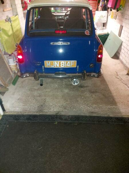

Matty Posted March 30, 2022 Author Share Posted March 30, 2022 Work has slowed to a stop at the moment. I've spent all my car budget and until I sell the kawasaki I'm not dipping into our savings or earnings. So on the meantime it's little bits only. The car has an awful high level brake light fitted and a reverse light that whilst much loved by @worldofceri doesn't look right either Link to comment Share on other sites More sharing options...
Matty Posted March 30, 2022 Author Share Posted March 30, 2022 Bit of fucking about got me this worldofceri and eddyramrod 2 Link to comment Share on other sites More sharing options...
scruff Posted March 30, 2022 Share Posted March 30, 2022 Love it - an a40 farina started my love affair with Austins as a schoolboy. I can't remember the last time I saw one on the road but they are ace little things. Matty 1 Link to comment Share on other sites More sharing options...
Matty Posted March 30, 2022 Author Share Posted March 30, 2022 High level brake light will have to wait till tomorow night. The PO had mixed his wiring up and wired the existing reverse lamp live to earth and ground to live. I'm sure someone will correct if I'm wrong, but I'm assuming he got away with this as the lamp was plastic. I didn't spot this and after wiring up my new chrome shelled lamp, suddenly had no indicators, brake lights or reverse light. Some swift fuse replacement and a quick rewire sorted the job. I've traced the wiring for the high level brake light so all that shite can come out tomorow night. Ultimately the car needs going through inside by someone who knows more than me. It's been rewired to a good standard under the bonnet but the interior needs sorting. Number one cause of old cars burning to the ground after all 😔 eddyramrod 1 Link to comment Share on other sites More sharing options...
