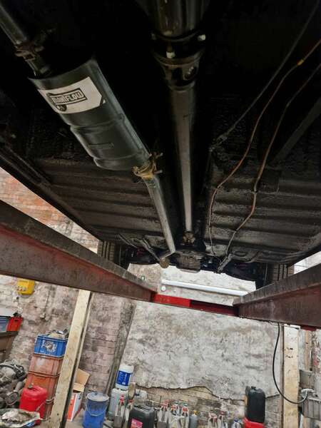

Matty Posted June 16, 2023 Author Share Posted June 16, 2023 On Tuesday I finally got round to fitting the maniflow system. This was not without its problems. The PO had bought a 2nd hand maniflow manifold off ebay and modified it to fit his own home made exhaust. This exhaust was one of my big problems with the car. Very noisy, very fart cannon and with an annoying habit of twating every part of the underside, no matter how many adjustments I made. See the pile of shite below N Dentressangle 1 Link to comment Share on other sites More sharing options...
Matty Posted June 16, 2023 Author Share Posted June 16, 2023 Now maniflow say that their systems are designed to fit their manifolds. Now I have one of their manifolds but the PO cut it off just after the collector and welded a larger bore 90 deg onto it like a sleeve to suit his larger bore system. This was my solution. Purists look away now. (In my defence the maniflow system mounts like the standard system ie solid from the headers straight through to the back box where it hangs on two rubber bobbins ala mini. The way I saw it a bit of give would be better for the system. Plus it was a fuck sight easier than butchering the manifold again.) Dick Longbridge, N Dentressangle, GrumpiusMaximus and 2 others 5 Link to comment Share on other sites More sharing options...
Matty Posted June 16, 2023 Author Share Posted June 16, 2023 Apart from that, the new system fits like a dream. People wax lyrical about maniflow quality but I'm quite the cynic. Apparently I was wrong this time. They really are that good. Excuse the shit clamps and paste. I couldn't get hold of the band clamps I wanted at short notice. This will be rectified forthwith. Sunny Jim, N Dentressangle, Dyslexic Viking and 4 others 7 Link to comment Share on other sites More sharing options...
Matty Posted June 16, 2023 Author Share Posted June 16, 2023 And I'll tell you what, it's transformative. There's a bit of resonance at low revs but it actually quietens with revs. No more knocks and bangs! And crucially it now sounds like it always should have. A tuned a series with a decent pipe. I've got a video I'll post below, however the sound quality is shit cos I'm a luddite and the acoustics in the garage aren't mint. Try to imagine a mini on an rc40. It's addictive. N Dentressangle, MiniMinorMk3, High Jetter and 2 others 5 Link to comment Share on other sites More sharing options...

MiniMinorMk3 Posted June 16, 2023 Share Posted June 16, 2023 Maniflows are great. I've had 3 full systems and 3 other manifolds on 6 Minis in the last 14 years. Not one has failed. They fit just like a standard system. The manifolds can be a bit awkward due to the space, but they do fit once you get passed the drive shafts and CVs. A40 looks great by the way. Matty 1 Link to comment Share on other sites More sharing options...
Matty Posted June 16, 2023 Author Share Posted June 16, 2023 8 minutes ago, MiniMinorMk3 said: Maniflows are great. I've had 3 full systems and 3 other manifolds on 6 Minis in the last 14 years. Not one has failed. They fit just like a standard system. The manifolds can be a bit awkward due to the space, but they do fit once you get passed the drive shafts and CVs. A40 looks great by the way. Just wish I'd done it sooner rather than procrastinate. Much as I love this little thing, I'd still like a mini one day. I fear financially they've past me by now though. MiniMinorMk3 1 Link to comment Share on other sites More sharing options...
