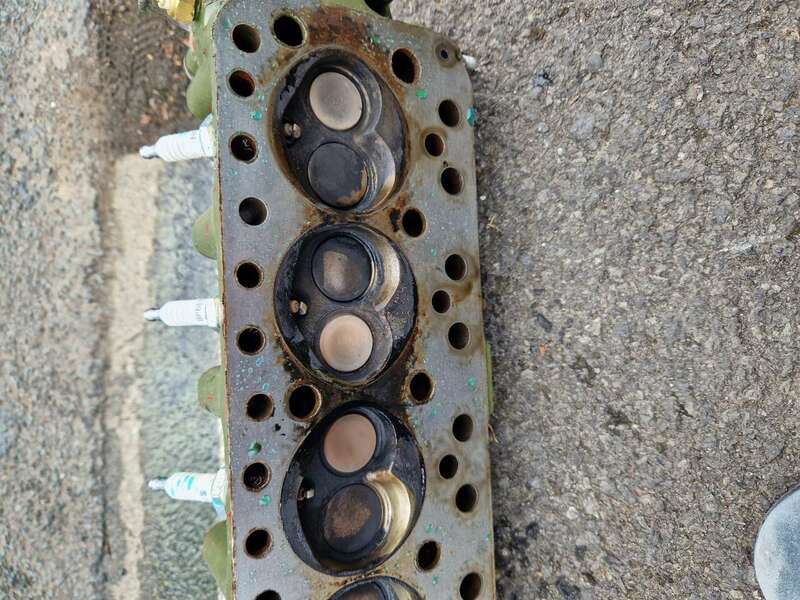

Matty Posted April 23, 2023 Author Share Posted April 23, 2023 And captain 70s, SiC s2000 etc were right. Blown accross pots one and two and not far off going accross all 4. Heads already away for a light skim to clean up. Blocks ok. S2000, Sunny Jim, adw1977 and 10 others 12 1 Link to comment Share on other sites More sharing options...

Joey spud Posted April 23, 2023 Share Posted April 23, 2023 A nice easy fix then. Maybe this guy had been here too,I wonder if a old copper gasket is better than a unknown branded fibre one ? Those rocker arms are the later solid ones that I also have in my 1275 midget engine and not the weaker old pressed steel jobbies so that points to a better than 1960's spec engine. It wouldn't hurt to measure your valves to see if their bigger than standard too. Matty 1 Link to comment Share on other sites More sharing options...

Matty Posted April 23, 2023 Author Share Posted April 23, 2023 18 minutes ago, Joey spud said: A nice easy fix then. Maybe this guy had been here too,I wonder if a old copper gasket is better than a unknown branded fibre one ? Those rocker arms are the later solid ones that I also have in my 1275 midget engine and not the weaker old pressed steel jobbies so that points to a better than 1960's spec engine. It wouldn't hurt to measure your valves to see if their bigger than standard too. Its supposedly got a cooper spec head. 12g29 something. I've got I written down but can't remember the exact number off the top of my head. The heads going to Wier Street in Blackburn tomorow morning. Get it checked and a light skim to clean up. They will supply a full gasket kit. They've been engine reconditioners for decades so it should be decent quality. I'm also going to change the washers under the head nuts. They were thin little things that had deformed, which won't be helping tightness. From memory I think it's form b washers that are twice as thick. There's enough thread on the studs that it'll stand them. Joey spud 1 Link to comment Share on other sites More sharing options...
Christine Posted April 23, 2023 Share Posted April 23, 2023 That isn't a 12g295 ... but someone has modded it by the look of it . The numbers will be cast into it , Matty 1 Link to comment Share on other sites More sharing options...
