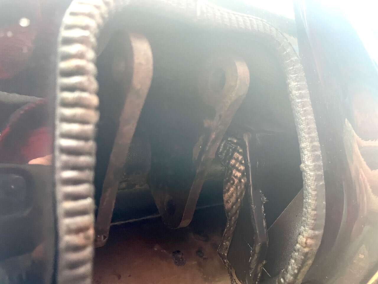

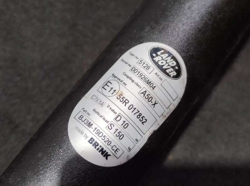

I wasn’t told when I bought it but I noticed a cut out in the splitter and found a towbar! And electrics tucked up out the way.
I have no hitch, had a lay under it and can’t see any brand or stickers, @Barry Cade not sure if this is anything you’d be able to help with but I assume I need to find out what brand/model bar it is to be able to buy a replacement hitch? The actual bar underneath is tubular which a quick google looks like a genuine LR one, however that trim on the splitter looks a bit shit so I can’t think it’s factory.
Cheers
Cheers
Usually dealer fit genuine bars will have the plastic trim with the OE cutout.
Take the black trim off the  bottom of the bumper, should be 2 half turn clips or a couple of 10mm's underneath, then pull the rest off.  You might be able to see a sticker on the crossbeam,  or take a pic and post it up. Looks possibly Brink, there may be a sticker on a door check ?
Edit. Genuine LR bars were made by Brink..the only ones I can find with a round crossbeam.
Nice one, thanks! Will whip the trim off and have a look. Need to take it off to retrieve the electrics as someone’s taken them off the bracket to hide them so I’d like to test them and fit them back in place.
Hopefully a simple case of finding the right hitch, new bolts and we’re away!

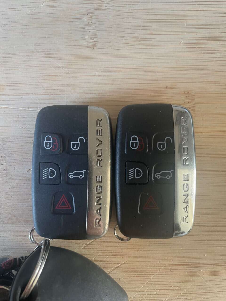

I’ve been with RAC for my breakdown cover for years and years, I noticed a while back I had a ‘loyalty reward’ of their key replace cover, thrown in for free.
The evoque came with 2 keys but one was dead, fella said he thinks it got water damaged. Phone this RAC key cover and explained the key had gone through the wash, £30 excess to pay and this morning they sent a locksmith out. No longer than 10-15 mins later I have a brand new genuine LR key, so 2 fully working keys now and he confirmed there are no other keys registered on the ECU either.
Great service!

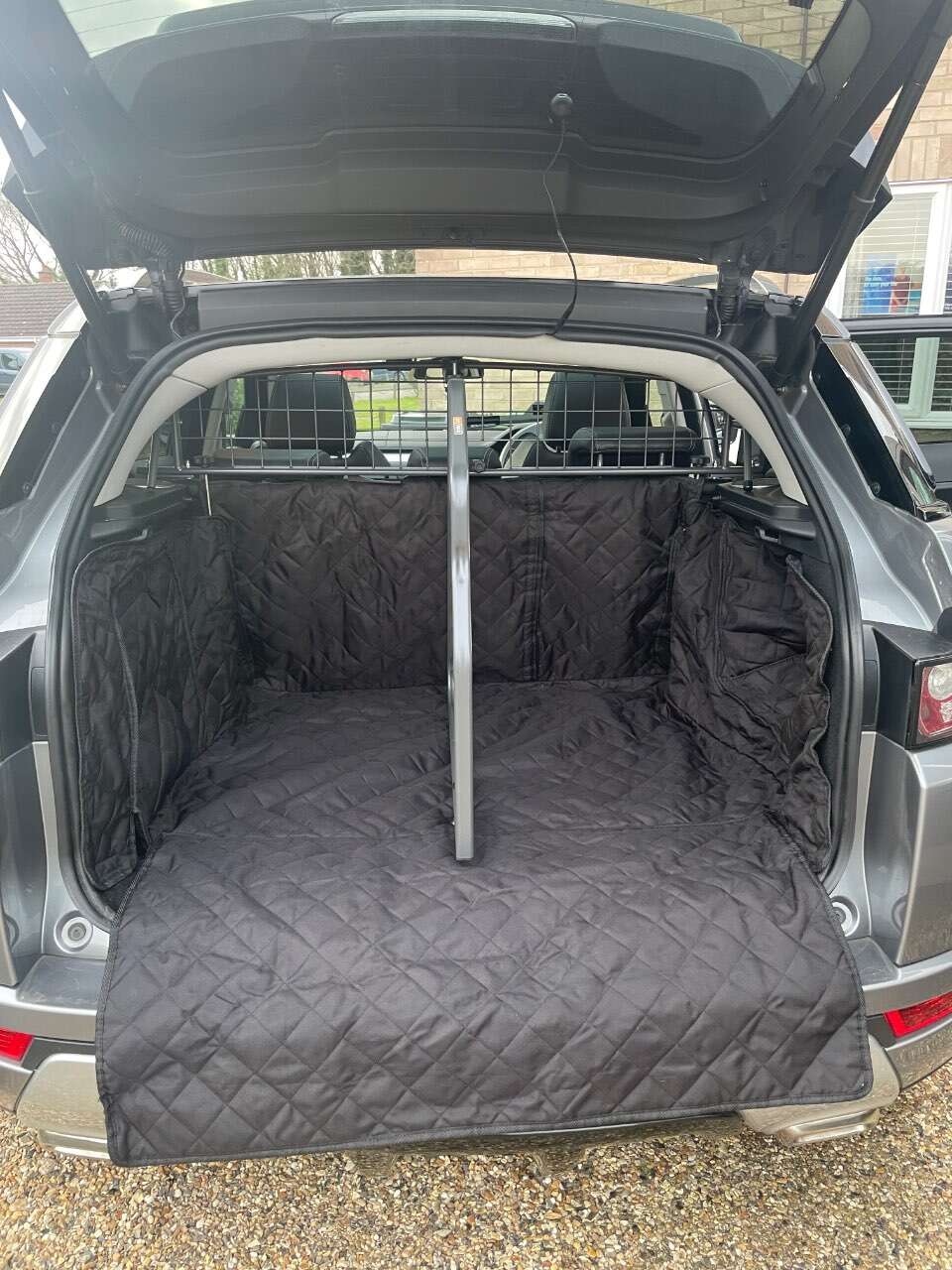

Browsing on Vinted the other day and spotted this from UK Custom Covers, up for £20 (£80 new)
Really good quality and properly tailored to fit so it keeps everything contained and tidy.

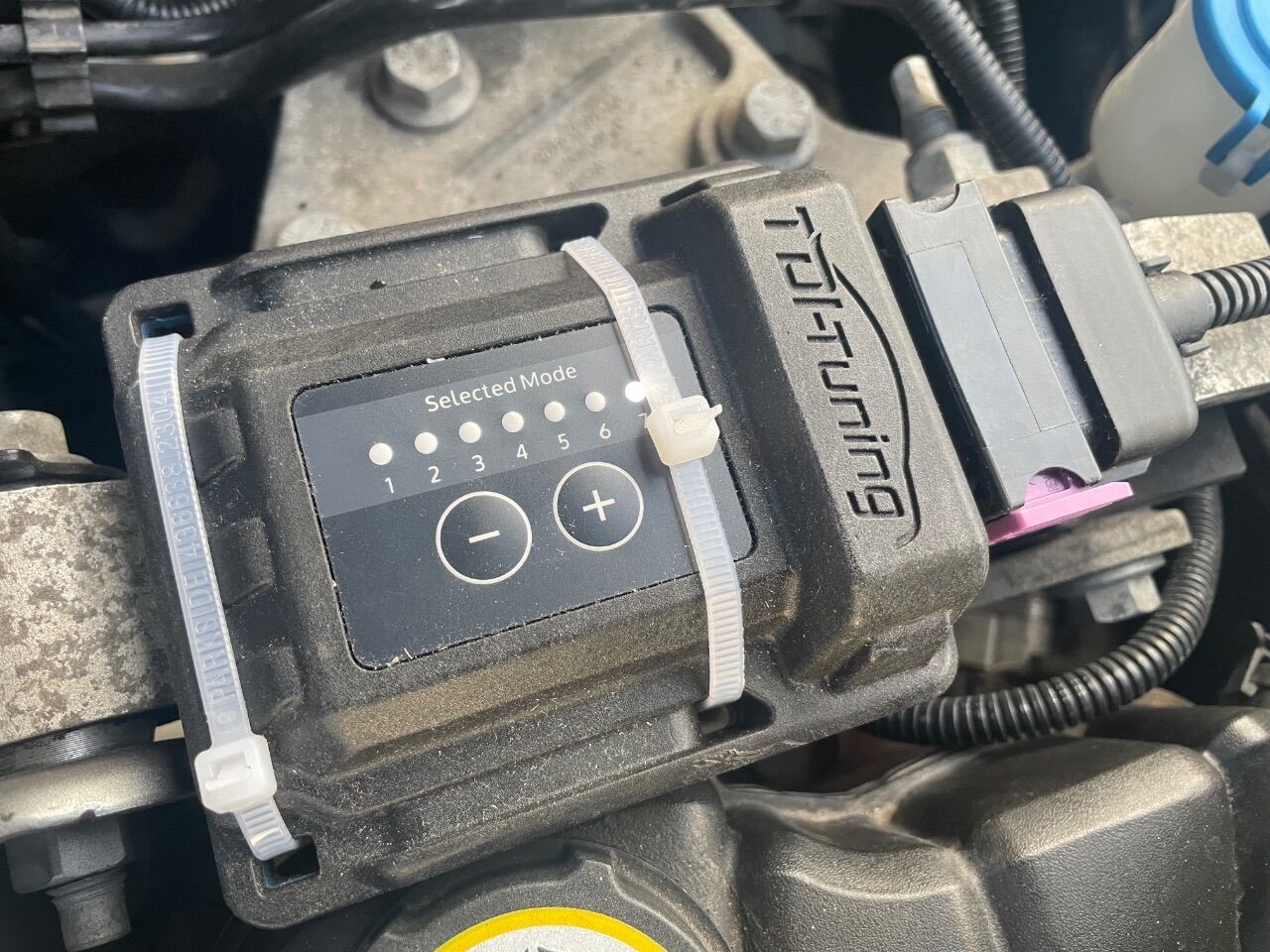

Saw this on eBay for £50, people seem to rate them for fuel economy benefits.
Stage 7 y0!
Took it for a run, definitely removes the lag. Like it.
